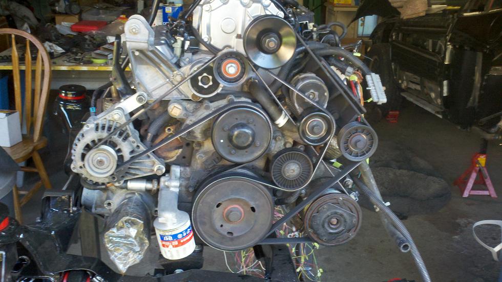

hercimer01
AUG 14, 06:54 PM
I have been working on it. Heres the low budget part, my wallet. Ive updated the needs list on page 3. I put the belts on today.
My fuel pump/sender is done. I washed out the fuel tank and its ready to install. the cabin is ready to go back together. PCM tune is in the works. I still need an exhaust system. I plan on the Flo-tech Afterburner.

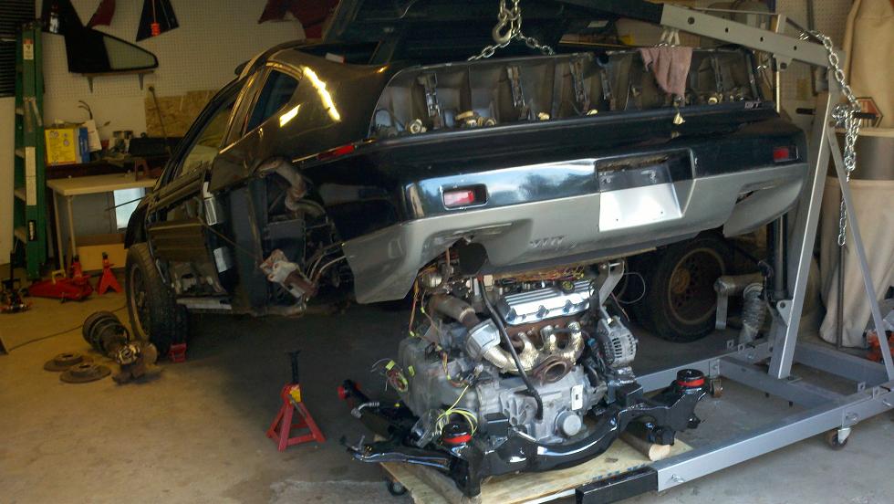

hercimer01
AUG 18, 04:33 PM
nosrac, The manual PCM has been returned.

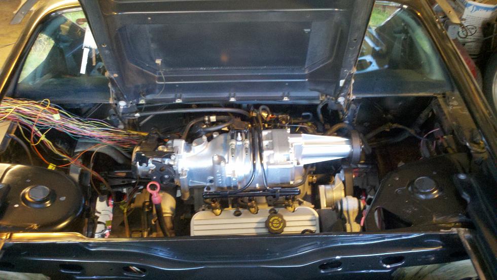

hercimer01
AUG 21, 05:47 PM
Fitting in car to finish up.
