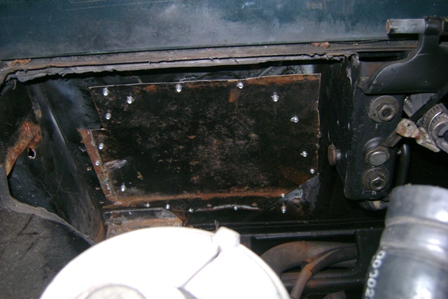

Started raining here so I could work on the car some.

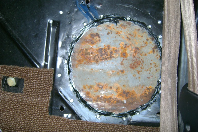

I replaced the metal behind the 9" speaker hole on one side today and added the standoff that the C500 attaches to. Black 3M Trim Adhesive around the hole and the outside edges on the piece of metal scabbed on.
The standoff for the C500 was removed by a PO. fierocarparts here on PFF sent it to me. I got it yesterdays mail. I have been waiting on this to finish up my C550 part of the harness.

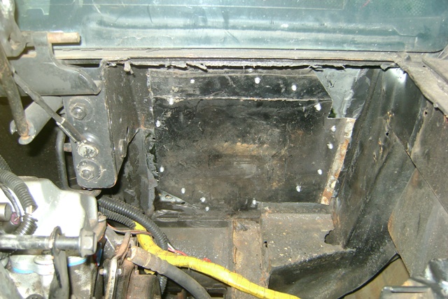

josef644 OCT 22, 05:16 PM
Cut and installed the other speaker hole cover today. These shots are from the engine side of the firewall:

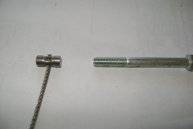

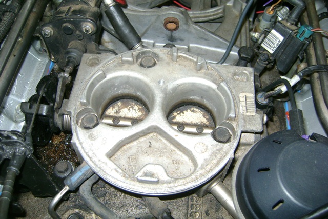

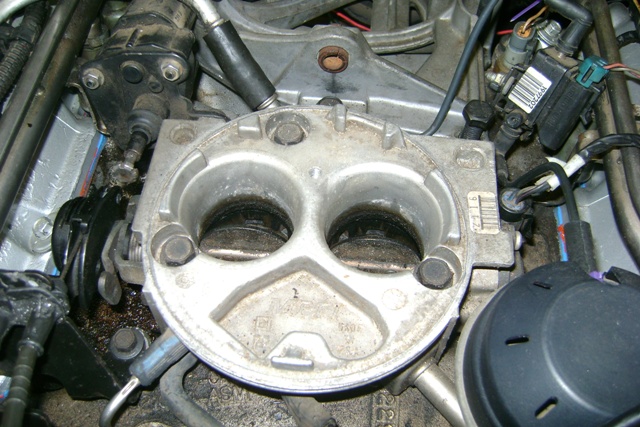

Well I put all of my throttle cable stuff back on the car today and measured the slack. I was just a little less than 5/8" to much cable.
So
I took my spare cable to the Hardware store and got a blot the same size as the fitting on the end of the cable:

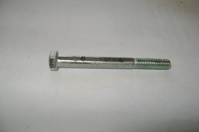

I filed a flat on the bolts shoulder to center punch a hole on it for the drill bit to bite. I drilled 2 1/16" holes on the shoulder. I wanted to have a spare. Cut to the correct length.
Both throttle bores closed
Both wide open:

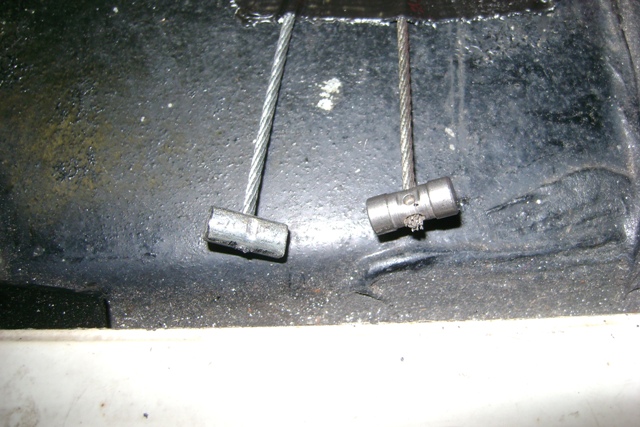

You can see the factory one,next to it, that I had for an extra.
I have a large flat blade screwdriver with the handle missing. I went back and used it to finish up the staking. It is not gonna come off. I did both sides.
They do not appear to be the same length in the photp, but they are .
Joe

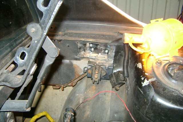

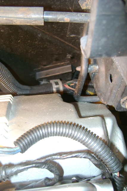

Found a problem while working on wiring in the C500. The trunk hinge torsion bar is hitting the forward valve cover:
I have to fix this when I remove the engine next week for the new water pump, oil pan gasket and water pump inlet housing. I also have to finish up with the serpintine belt parts alignment and remount the AC compressor.
I was pretty happy with the way the engine was sitting in the engine bay untill I found this rubbing. Is my engine sitting to high? I don't remember reading that I had to leave this out when using the oil fill valve cover in the front and back of the car.

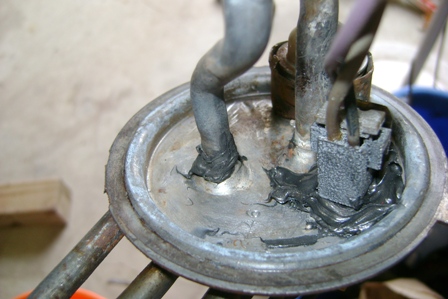

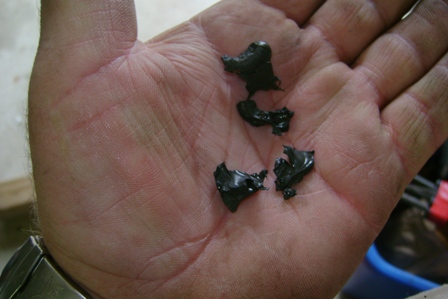

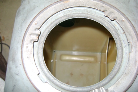

I removed the fuel tank this morning. It was pretty easy as gas tanks go. The tank was clean on the inside with less than 1/4 gallon of gas that didn't stink. No telling how old it was though.
The top showed signs of being soldered, and black sealer around the metal lines where it went into the lid part.
The silicone was in the inside of the tank and an been coming off of the repair:

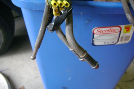

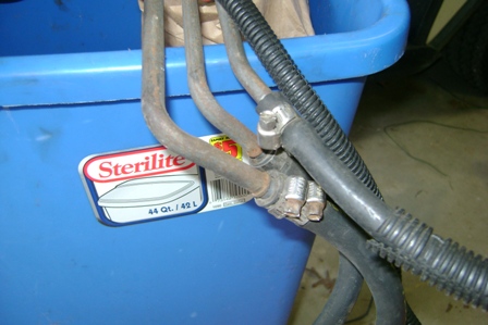

I have a replacement top part tof the metal line assembly that I had picked up from Wheels1 back in 2007 for a fuel gauge repair. The three metal lines do not point in the same direstion as the ones off of the car. I think this was off of a V6 car?
The one pointing in the wrong direction is just a vapor line. I will cut it and put a hose splice with clamps on it and point it in the correct direction.

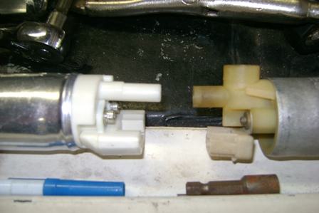

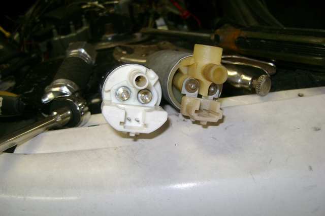

There was just a little bit difference between the old 4 Cyl pump and the new AC Delco V6 pump
The fuel inlet was smaller on the V6 pump. I am gonna use the fuel hose in the AC Delco box instead of the pulsator that was on the replacement metal hose assembly.

Pulsators are about 3-5 bucks at your local auto parts store. Usually in the HELP section. When I did my last pump I added one back in and was amazed at how much it quieted down the pump. I was trying to minimize the fuel pump noise as much as possible. Upper and lower rubber isolators, foam fuel pump sleeve, and pulsator. I have to really listen to hear the pump with the engine off. I can't hear it at all when the engine is running... unlike my 84. Something to take into consideration at least.
EDIT: Oh. I also used the caddy fuel pump relay which is nearly silent.
