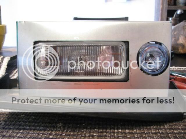

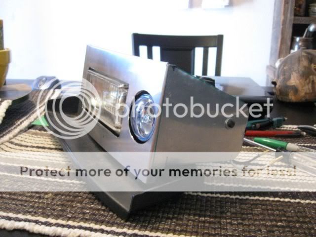

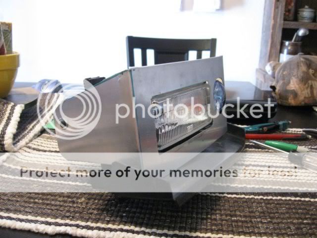

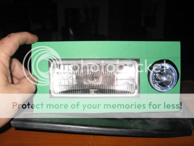

katatak JUL 08, 11:43 PM
One more piece of the lo pro headlight project completed this evening. I got the template made for the face plate/cover for the new headlight buckets. I have some 16ga aluminum sheet that i will fab the cover's from. With any luck, I will have the covers done tomorrow night. Then I will disassemble both buckets and paint them up. I also got a packag from the AC ferry today via Fed Ex - new AC compressor, Accumulator, Variable orifice tube, hi and lo pressure switchs w/new connectors and the R134 control valve. Guess I'll be rehabing the AC Saturday......I Can't wait. I drove the car this evening - it was 101 out at 8:00pm and I am cooked. I will never have another "black" car!
The template is a "rough outline. I will radius all the inside corners to fit the light better and the round hole for the driving light will be - well - round. I'll use a whole saw to cut the hole. There will also be "sides" bent back to cover each side and will attach at the stock points on the Fiero bucket.
More later.

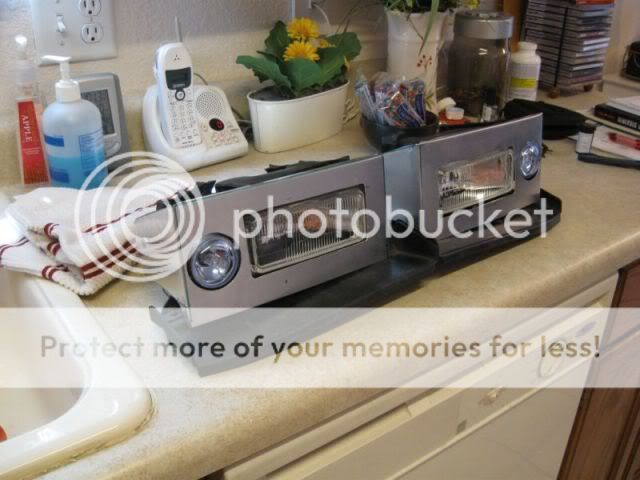

katatak JUL 09, 02:50 PM
I had a little time during the lunch hour today so I made a quick run at fabbing a cover.
More later
[This message has been edited by katatak (edited 07-09-2009).]

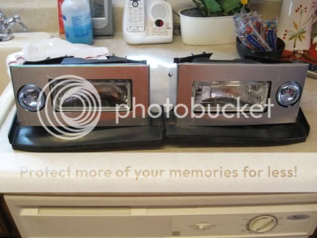

katatak JUL 09, 06:44 PM
Got the other cover done!

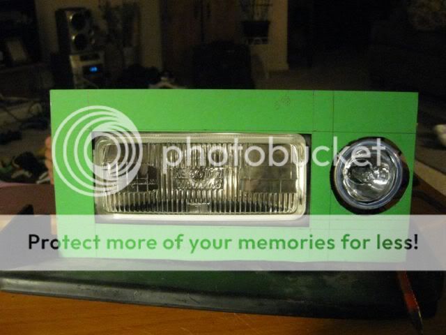

katatak JUL 10, 07:15 PM
So I got the crazy idea that I would attempt to paint the headlight covers to give them that "carbon fiber" look. So I spent a few hours on the net, watching some yuotube, reading some posts and decided what the heck. If it does not turn out, I can just paint em black and be done. So here's my first run at it. Not too bad - there is room for improvement but I was surprized how they turned out.
