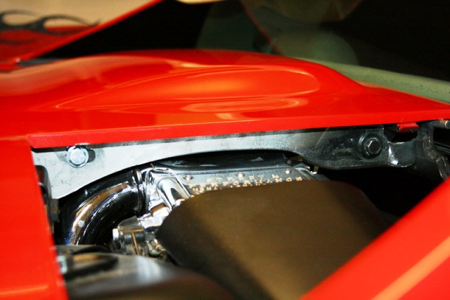

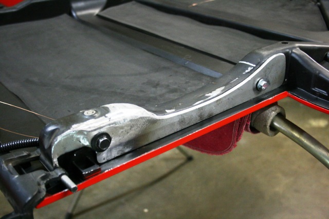

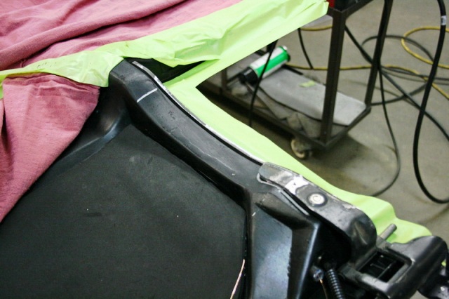

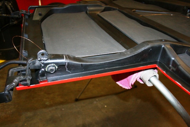

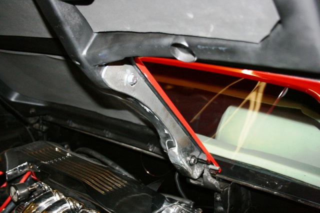

One of the finer points of swapping out an Iron Duke for a ZZ4 is you have to gouge out a chunk of the deck lid support to get clearance over the breather. Mine has cracked twice so I busted into my kids piggybank to get funding for this project (I told them it was the next door neighbor's brats). Conflict is a good thing.
The cracks as you see are pretty obvious. The give caused by the cracks keep the lid from shutting cleanly.

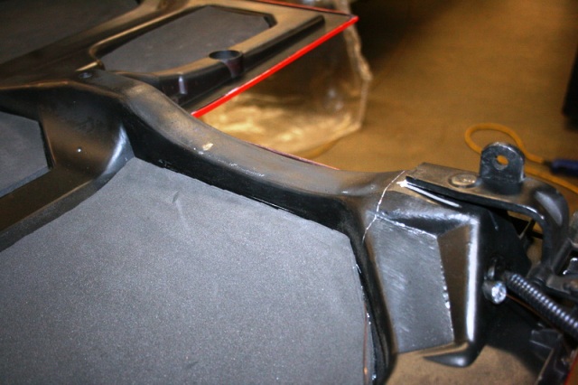

 We designed a brace to strengthen the support
 It clears the engine nicely.

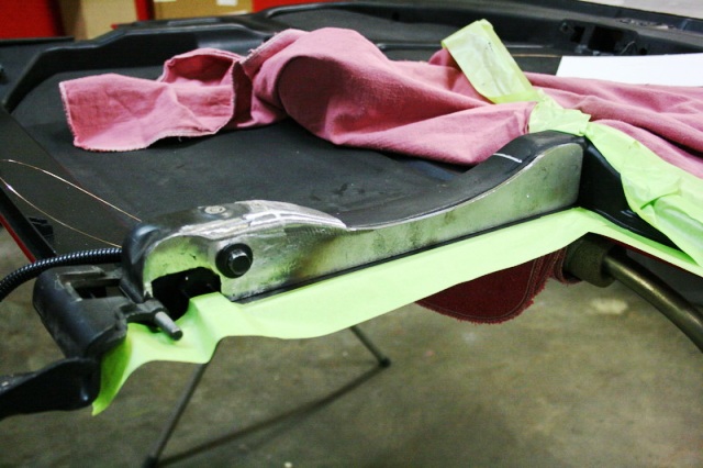

 Add a little paint and I think I have a winner.

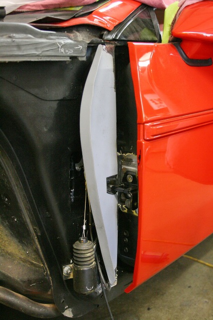

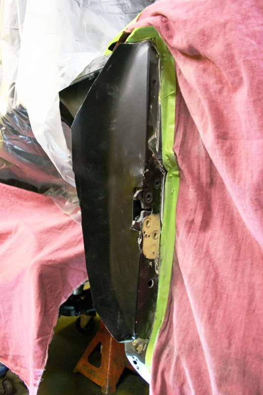

Ok, time to get rid of the Bear Claws. They have served me well, but I'm just not happy unless I have something to change. Some might think it sacrilegious to put Ford Mustang parts on a Fiero but I'm really OK with mixed breeding. My car is kind of a Heinz 57 as it is.

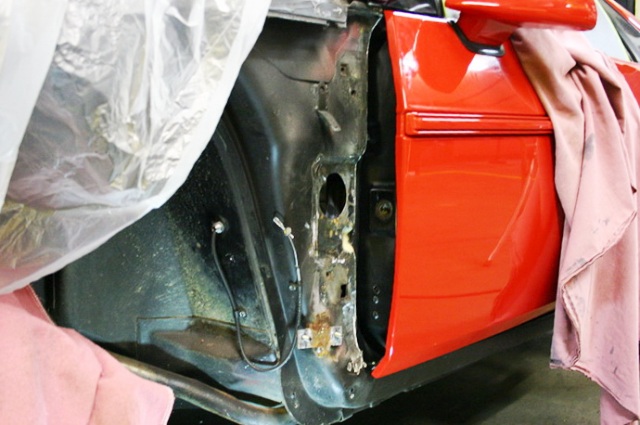

This is the old Bear Claw mechanism that I want to replace.
And this lovely shot is of the bear claw latch removed

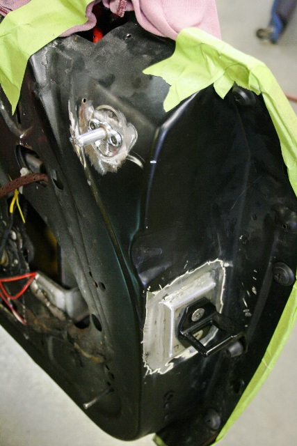

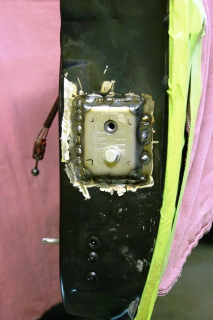

Here are some pics of the new bracket for the new latch install.

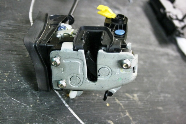

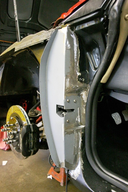

This is the new latch. I picked it out because of the size; not too big, not too small. Its off a 2007 Mustang.
 This is where the new latch will be mounted.
rodneybooth
MAR 10, 06:21 PM

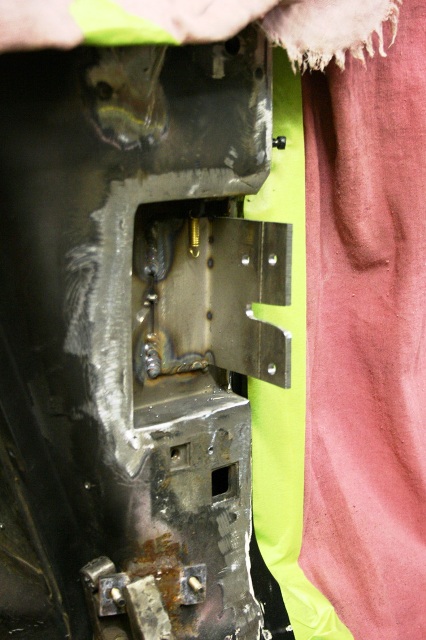

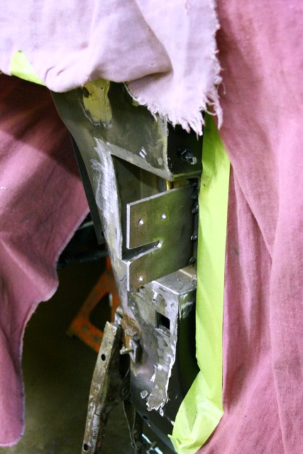

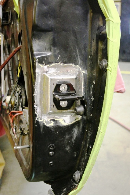

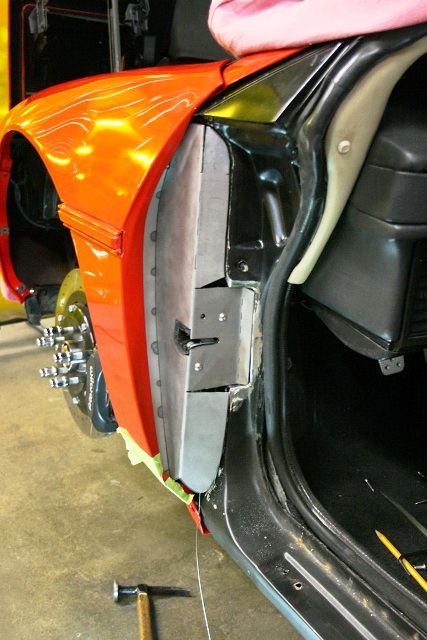

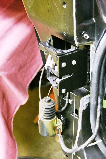

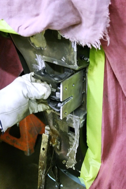

New latch & solenoid mounted
 New striker mounting plate being fabricated
 New striker mounted

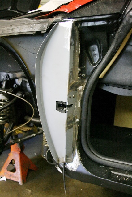

Filler panel being made
 Door popper to assist the door to open
 Filler panel finished
