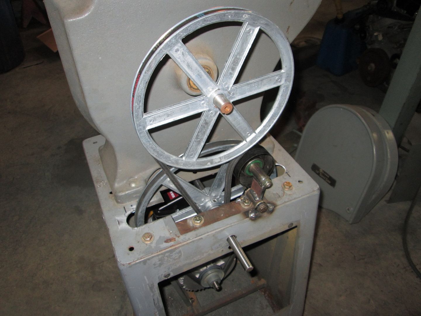

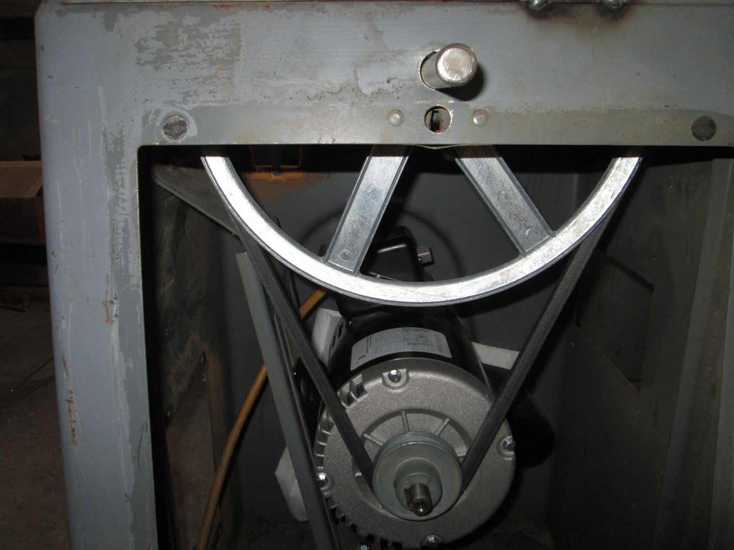

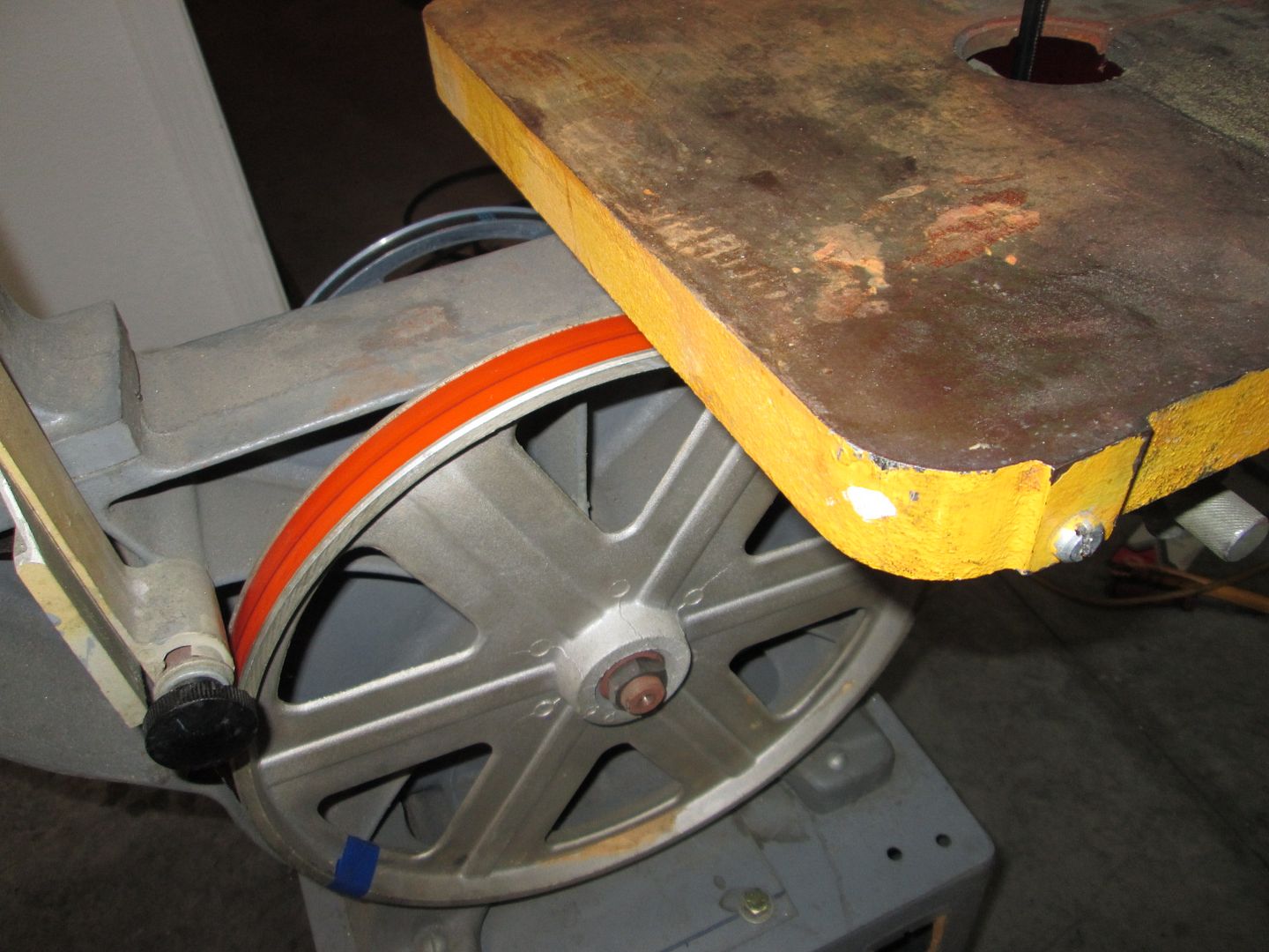

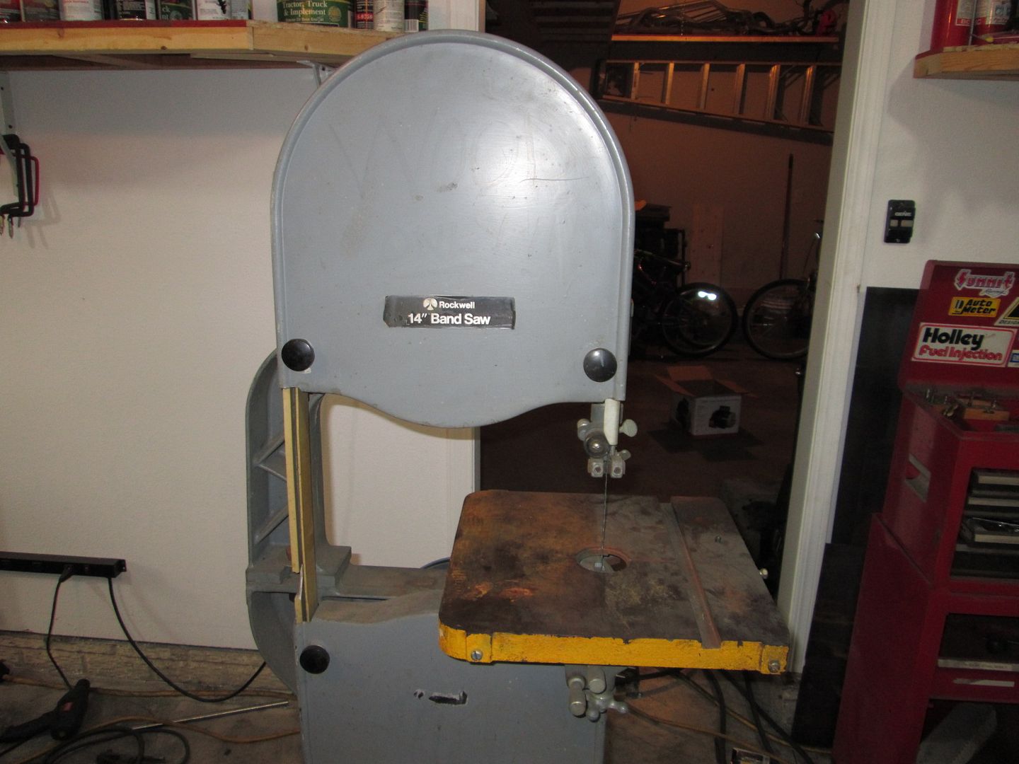

Had a little free time and decided to get the Rockwell 14" bandsaw actually running. I picked it up 4+ years ago on craigslist as surplus from a school, but it was setup for wood (3000 ft/min blade speed) and 3 phase. To convert it to a metal bandsaw, I needed to slow it way, way down. Right now it is 252 ft/min and I have a smaller pulley for the motor to get it slower.

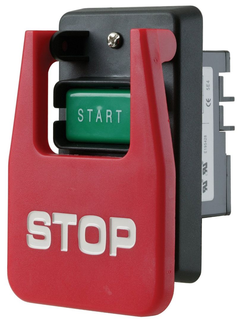

New 120V motor, bi-metal blade, poly tires for the wheels, fabed up the jack shaft, assortment of pulleys, a little trim work on the base to fit the pulleys, and used a LS4 accessory pulley as a tensioner!... I still need to fab up a new belt guard, get the filler puck for the center hole around the blade, and I am waiting for my new start/stop switch to show up.

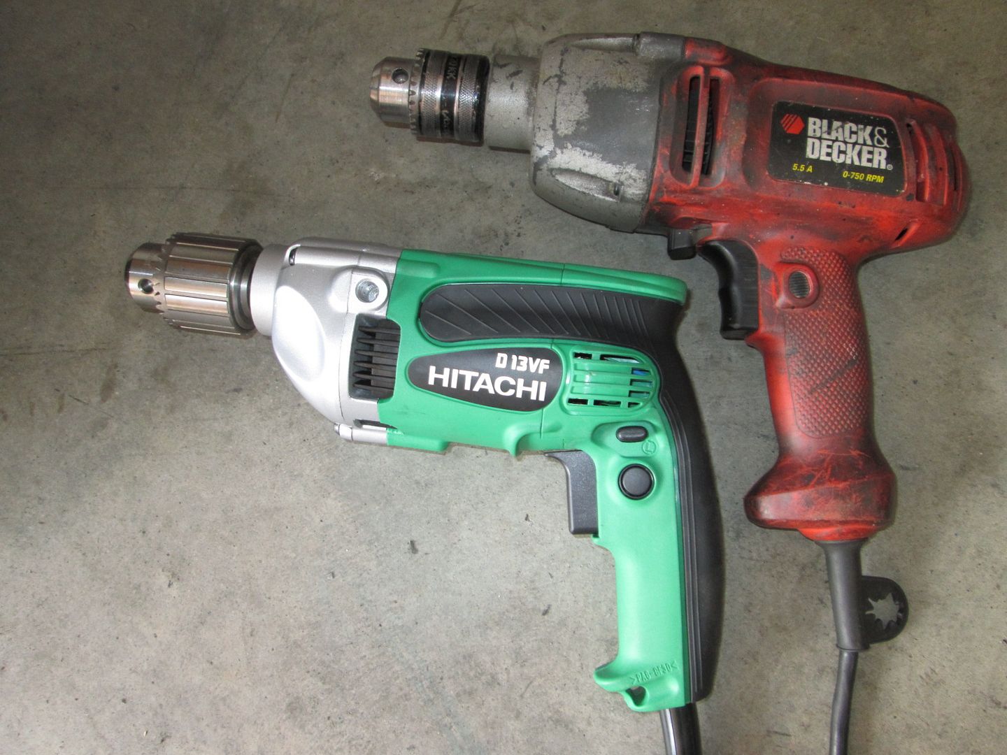

One of the casualties of this project was my 1/2" drill. Can't remember how old it is, but I think I got it about the same time as my dewalt saws all - probably 15 or so years ago. I have abused it relentlessly and it finally stopped working. I have been abusing a 4 1/2" Hitachi angle grinder for 5+ years and quite happy with it (went through several dewalts and others before this one), so I decided to tryout their 1/2" drill. Time will tell how this one holds up, but it spun the 1 3/8" hole saw though the base in a couple of spots.
Next tool related project is to get my 6" Dayton belt sander running as well. It is already 120V, just needs a new motor (1 1/2 hp and 3450 rpm). I did order the same start/stop switch for it so as well.
