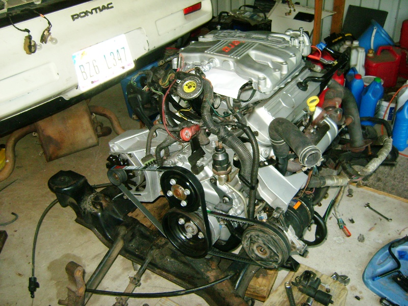

Took the bolts out of the engine mount out , and raised the engine up. Put the nuts on the motor mount studs. Remounted the engine mount onto the engine. Put the nuts on the rear exhaust manifold heat shield. Installed and tightened the alternator belt. Picked up the shop a bit.
I met UND SOUIX in Conroe,Texas yesterday at 4:00pm and got the 120 MPH speedo he had for me. I am gonna remove it from the dark gray speedo surround . It is much cooler in the house, so in to get back to work. He has a fine red GT. Clean as a whistle.
As it sits this morning.

tip.... your motor is facing the wrong direction.
josef644
AUG 02, 12:45 PM
| quote | Originally posted by blakeinspace:
tip.... your motor is facing the wrong direction.  |
I had a 50-50 chance and muffed it !!!!!!! Time to take it all apart once more I guess. I should have known as the muffler was pointing the right way. -Joe[This message has been edited by josef644 (edited 08-02-2011).]

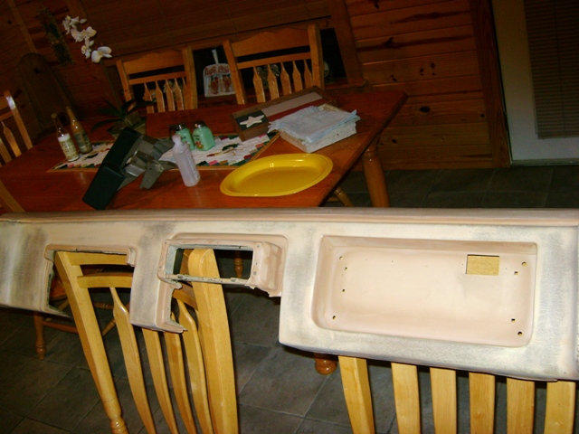

Used a Scotch Brite pad to scuff the dash and the speedo housing. Cleaned all parts with Alcohol. Assembled my new Harbor Freight Air Filter and oiler and regulator. I am gonna shoot the dash parts at 7:00am when it will be as cool as it will get here tomorrow. It was 106* here this afternoon. At 8:30pm it is still 97*
I used lacquer thinner to remove all of the paint on the dash from The Fiero Stores SW spray cans. The color was spot on, but it is just to hot for doing this in Texas right now. I took the dash with me to the PPG paint store. They all said the same thing. Tooooooooooo hot for spray can.
Ready to shoot:
and
