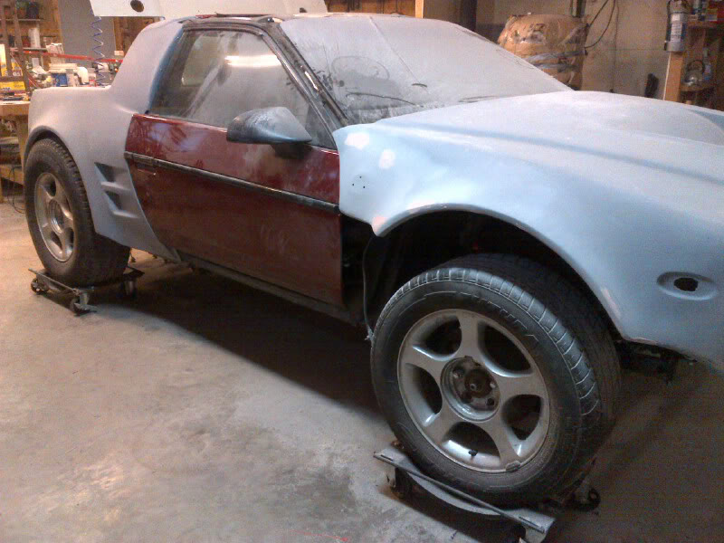

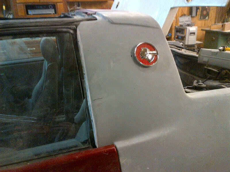

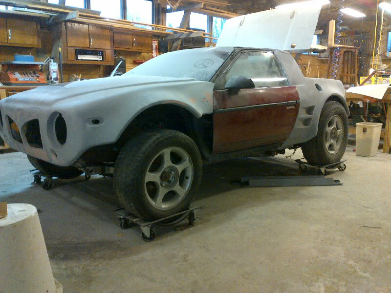

artworks JAN 27, 06:56 PM

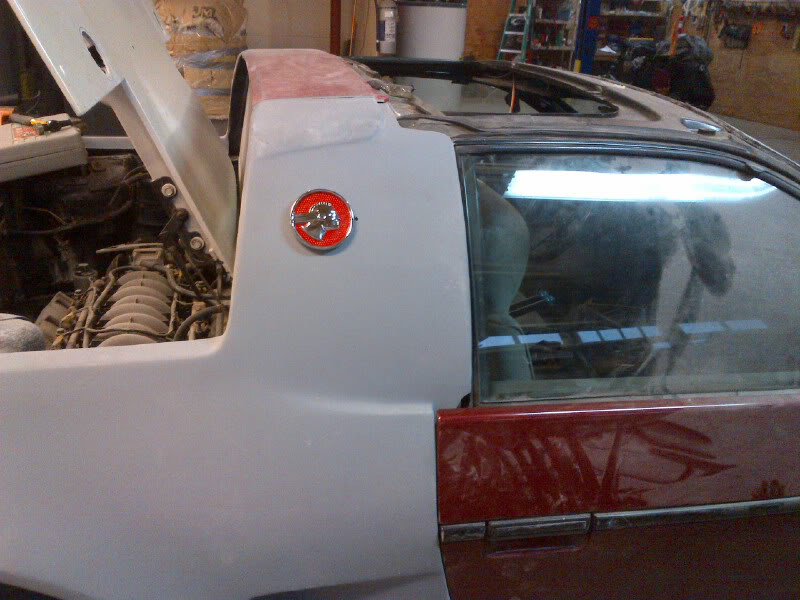

Good progress this weekend. The body panels fit (sort of). I test fit the Chief Pontiac emblems where I think I want them. I still need to "french" them in.

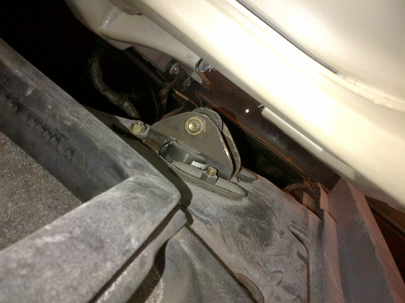

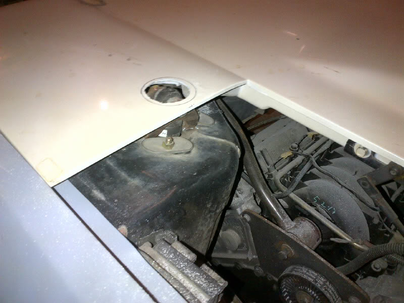

artworks JAN 27, 07:06 PM

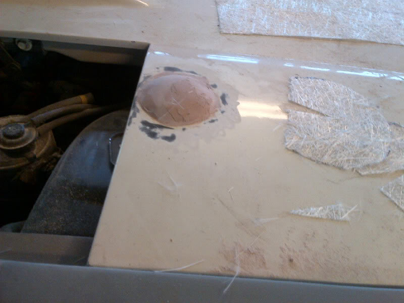

Those Bilstein shock mounts were just a little too tall to fit under the decklid. I guess it will just need a few more bumps in it.

1988holleyformula JAN 27, 09:47 PM
Great project! I don't think I've posted in here yet, but I've been watching!
Originally posted by artworks: I test fit the Chief Pontiac emblems where I think I want them. I still need to "french" them in.
Those look great in the spots you have them in your pictures.

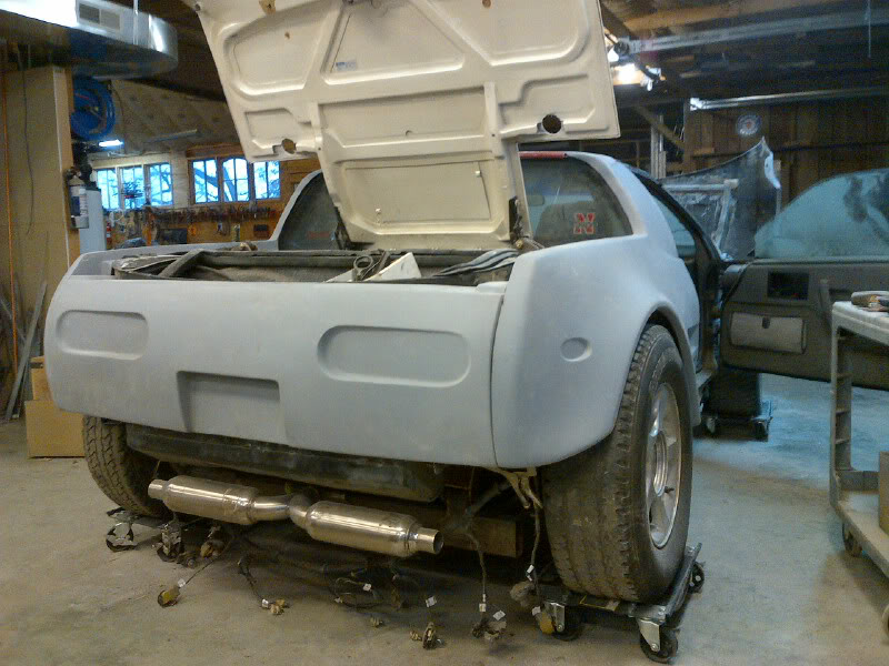

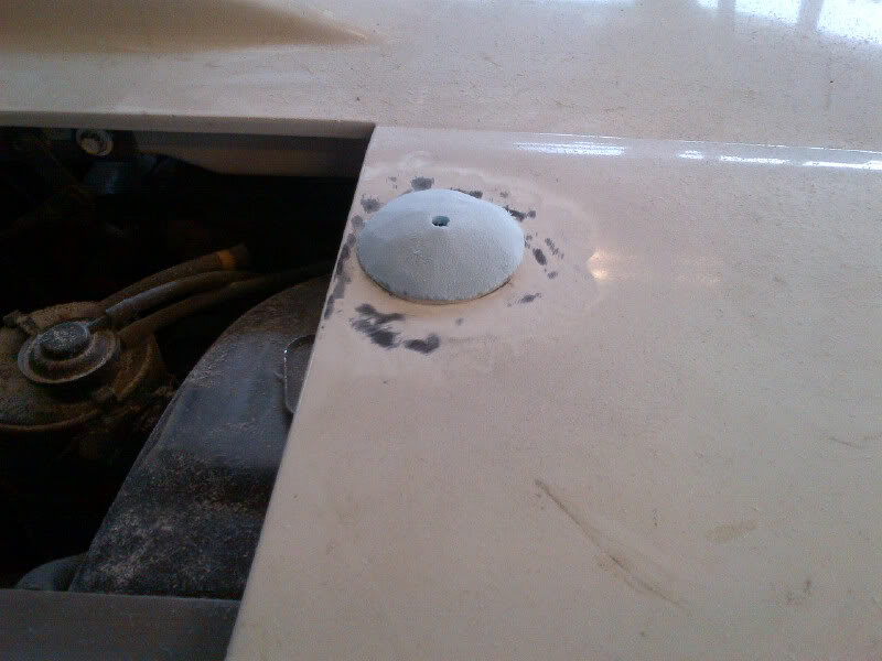

artworks FEB 02, 05:58 PM

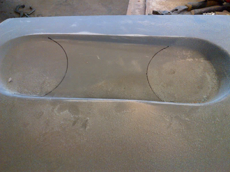

Making the "humps" to cover the rear coilovers - I'll call them shoulder blades
Figuring out how to fit the 50 Pontiac lights into the rear panel
[This message has been edited by artworks (edited 07-15-2017).]

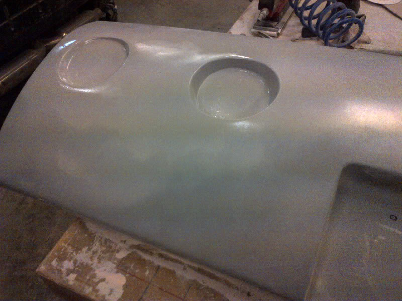

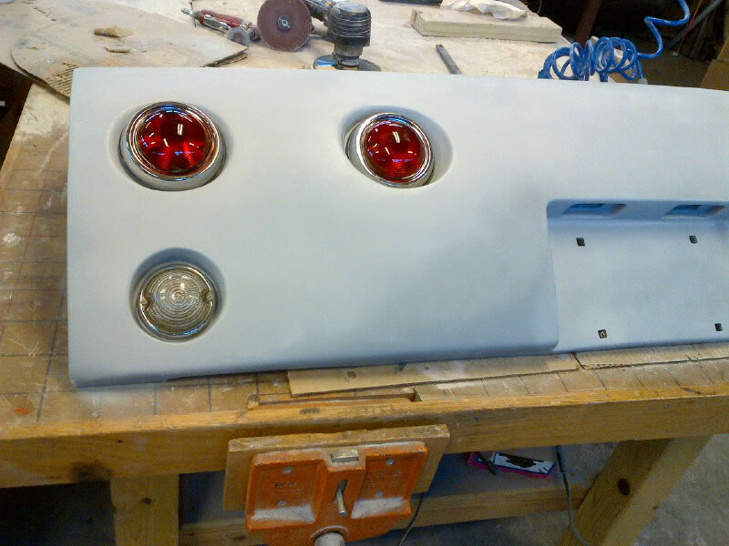

artworks FEB 09, 07:16 PM

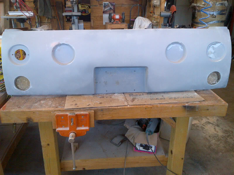

The rear panel is starting to come together. I sprayed a coat of primer so I can get a better look at the shape. Not quite done yet but it's getting there.

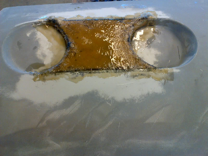

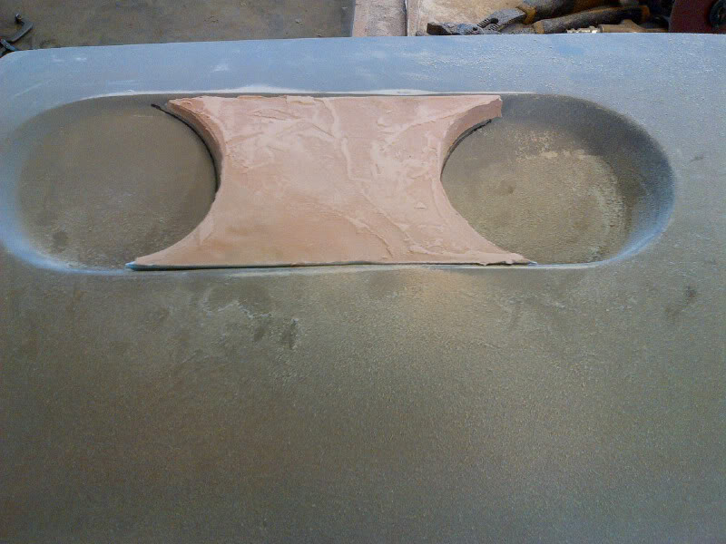

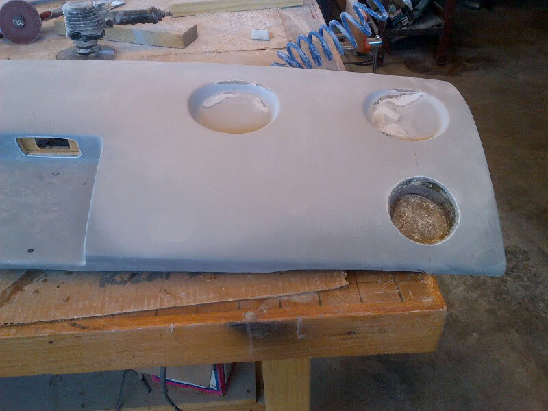

artworks FEB 24, 06:46 PM

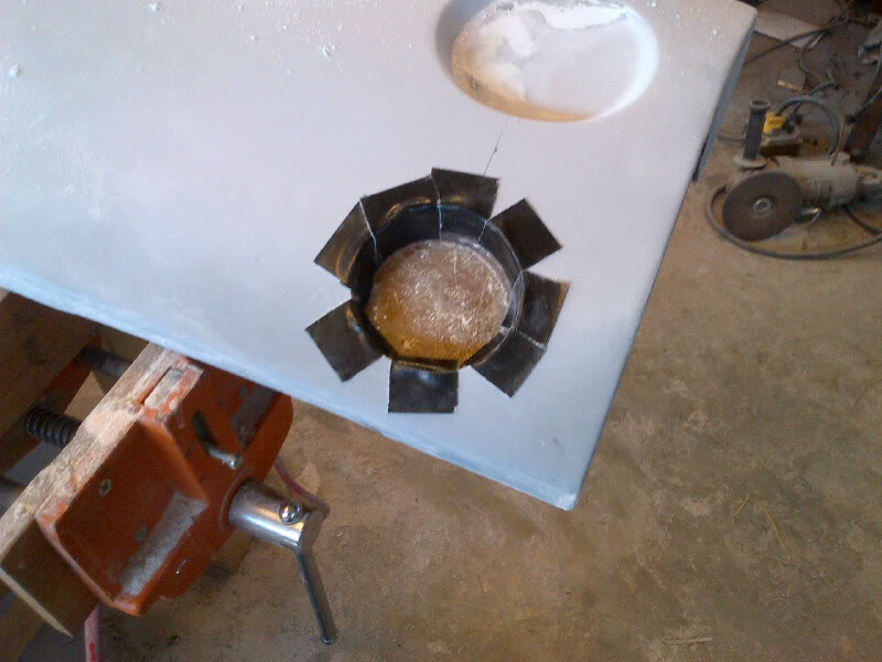

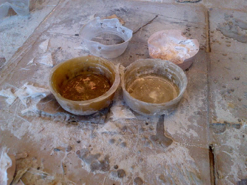

Going with old-school Pontiac tail lights - 1950 vintage, I needed to work on the backup lights and found a used pair of the same year on eBay. To install them I needed to "french" them in like the tail lights. I used a plastic cup and bondo for the mold. The first photo shows the finished "ashtrays" next to the destroyed mold. After trimming the ashtrays for the right angle, they were temporarily held in place with duct tape while I glassed them to the backside. Kind of a nice look when all finished. I want to get rid of the chrome though - all black.
