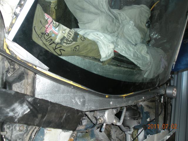

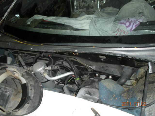

I did get a couple of pictures from yesterday I have a base, will fill the gaps with foam and fiberglass over. That is the plan anyway.
_1.jpg)
.jpg) Yes the blue carpet will be gone. This was a very clean car one of the better cars I have had but man what some people like to do. Stephen was right on when he described its condition. I think I am on the right track Gianina walked out last night and said WOW.

Ok, if you didn't move the windshield forward something else had to move in order to retain the original t-tops. Looking at your pictures I think I figured out what you did. It appears you have changed the angle of the front edge of the b-pillar, angling it more towards the rear, with the top corner further towards the back.
If this is how you did it I'm thinking you're going to need different side glass than what you have previously used as the angles will not be correct on the rear edge of the window. Maybe this is where the mystery factory side glass window you have alluded to in this and other chop threads you were looking to try out in a chop come in.
I'm also curious as to just how much of a chop this car is. Is it the common 3 inch variety, or is it something else? |
So from your lack of response to my questions I'm guessing I figured out how you did it and you're simply ignoring me. That's fine I guess. If that's not how you did it the mystery continues. Sooner or later we'll find out how it was done.
If that is how you did it will you have enough adjustment in the glass to make your windows line up with that angle change at the rear edge? I'm probably wrong but I think you're going to have a hard time with the rear edge getting it to seal. If you also played with the amount of chop and/or the angle of the chop[roof height from front to rear], I'm guessing you may be able to get them to fit. We'll all see eventually I guess.

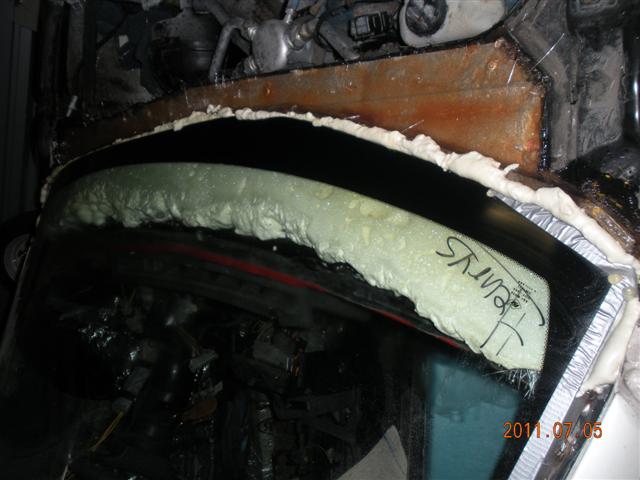

all foamed up

LOL! I'm pretty sure my guess as to how he did it is fairly close, congrats to Mike on figuring it out. If not the mystery continues. I look forward to seeing how he pulls off the side glass as that will be the most difficult thing left to figure out.
If you haven't thought of it already, in order to make your glass windows fit your new style t-top chop easier it may be possible to mess with the size and angle of the near vertical part of the a-pillar at the base[the part that is covered by that bolt on plastic triangle piece on a stock fiero]. Doing so may make it possible to adjust your glass to seal on that rear edge.
The sebring glass is of the most interest to me as I'm not a t-top fan and I won't be building another chop anyway. If it's not a secret, how or what are you doing to regain the cowl air inlets for the ventilation system? From what I can see in your pics it doesn't appear that you have that worked out yet. If you don't want to reveal your solution for that I'm sure I can find out what others have done as you're not the first to use that windshield in a fiero.[This message has been edited by av8fiero (edited 07-05-2011).]
