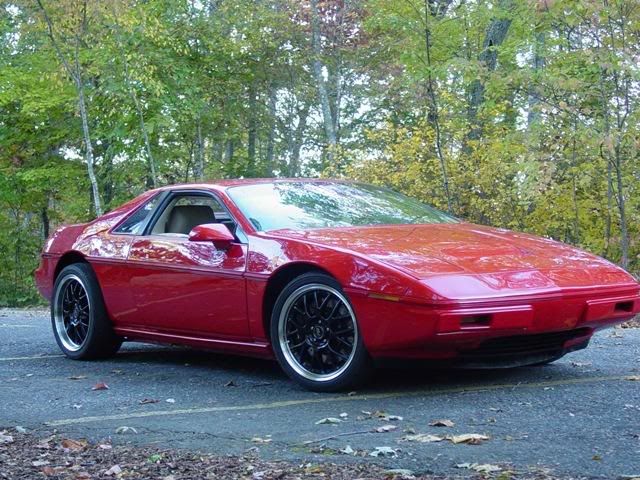

Wow, you've done some incredible things with this car.
I never thought too much about choptops, but I have to say that I think the lines of a chop top notchie are even better than a fastback. This view was excellent.

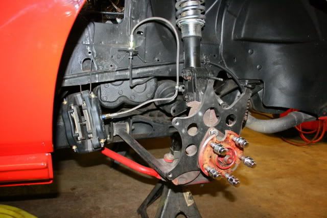

Way back in your first post you had this shot of the rear control arm and caliper mount:
Can you provide any additional info on those pieces? The control arm looks kind of like the Held Motorsports bumb steer reduction kit, but the tie rod seemed different.

I have the RCC Specialty Products bump steer correction kit and rear spindles and coilovers. He has a website. It is similar to Held. I think Held has a very good product and well thought out. In fact, the front end has the Held 1 1/2" drop spindles and they are the "owner" of the geometry patent for the Wildwood braking system which I love. However, I think Held "over-engineers" slightly. Anyway, I like and respect Dwayne at RCC. I had a good connect with him. He is down to earth and a serious player. In fact, he is a recovering attorney. I can respect a man the does what he loves. Kinda like that choptop guy, what ever his name is.
