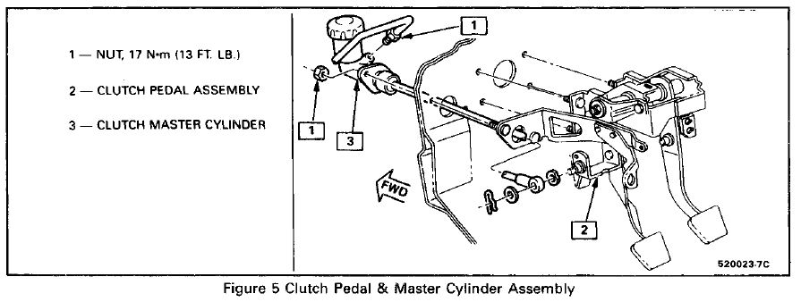

clutch pedal assembly

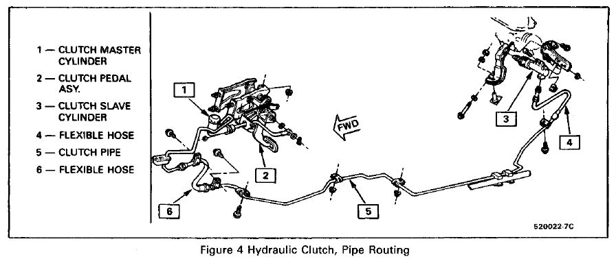

hydraulic clutch line
master cylinder
slave cylinder

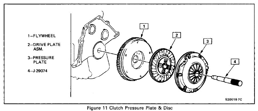

flywheel
clutch set <---- buy new - no reason using a worn one

The hydraulic system is tedious to install. You should pull the front spare wheel tub and gut the interior
(at least the driver's seat, upper steering column, and center console including "plastic skeleton").
I pulled the cluster and dash as well to see better.
The automatic pedal box is held in by the 4 bolts that hold the brake booster (plus one under the dash).
The manual pedal box with the clutch will in addition have the two studs for the clutch master cylinder.
The firewall will have a sheet metal plug that can be popped out for installing the master.
Remove the automatic transmission cooling lines and install the hydraulic clutch line in it's place. It bolts in using the same bolts into the same locations.
Maneouvering the line into place past the steering column and brake booster can be done more easily while the brake booster is unbolted from the firewall.

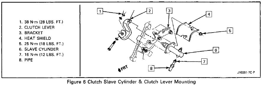

The clutch slave will attach to the transmission using its normal bracketry.

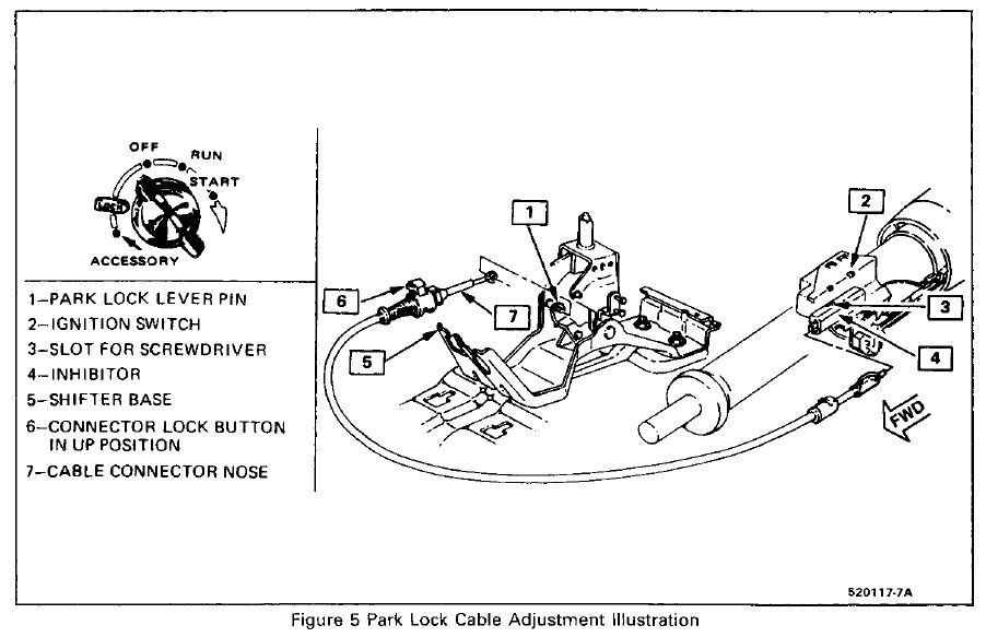

With the "plastic skeleton" out of the center console, it's a simple matter to remove the park/lock cable from the shifter to the steering column.
I left the steering column as is and didn't bother with modifying it to add the key latch.

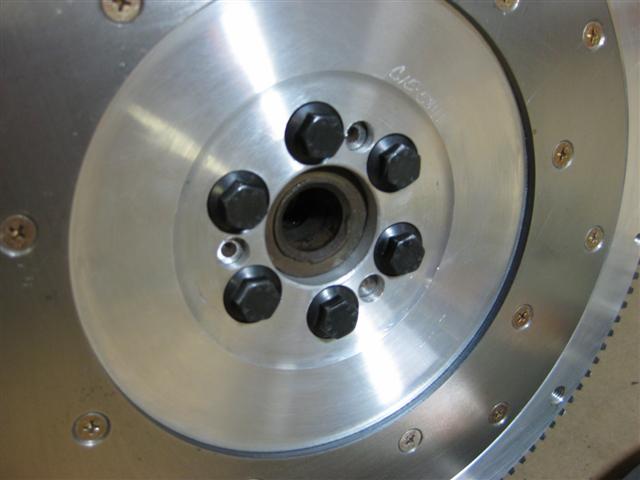

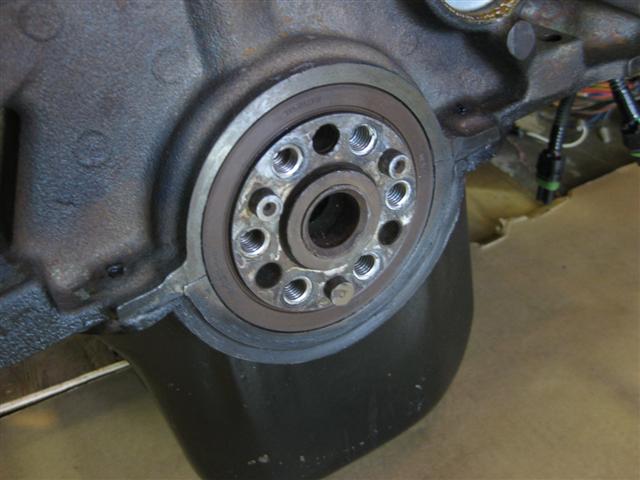

The big "wait time" was getting the V6 Fidanza aluminum flywheel welded and redrilled for the SD4 crank (Duke pattern).
Mostly time sitting on the shelf "waiting for my turn" because it didn't take long once they got to it.
The SD4 crank was also "pinned" in it's previous life as a race engine. In addition to the 6 flywheels bolts, 3 steel pins are
embedded in the crank and line up with holes in the flywheel. These take the shear loads off of the flywheel bolts.
After the original holes were welded up, and both faces machined, 9 holes were drilled in the flywheel to match the crank's face (used old flexplate as template).
Center hole is also larger than on a V6 and was machined to match the crank.

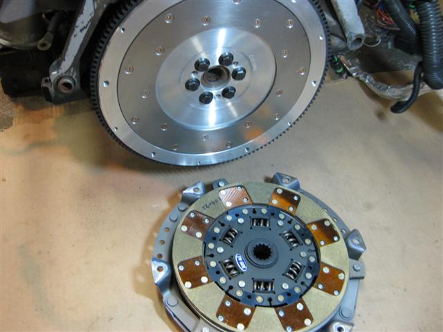

Stock flywheel bolts have huge low height hex heads (M10 x 1.5 x 23mm) and couldn't be found locally. I purchased ARP flange head bolts PN 134-2201 instead.
These are 25mm long and need to be cut down in length to 23mm as they bottom out in the crankshaft holes otherwise.
The flywheel bolt holes were countersunk for the flange on the head and work much better.
The Spec Stage 2 clutch pack was then attached.
Blue Locktite is a necessity on the flywheel and pressure plate bolts (just to be safe)

I installed a rebuild kit in the clutch master cylinder - Wagner PN F110274.

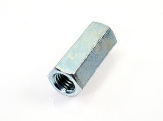

In addition, I cut the pushrod and threaded it for a 5/16" thread long nut and locknuts to make it adjustable.

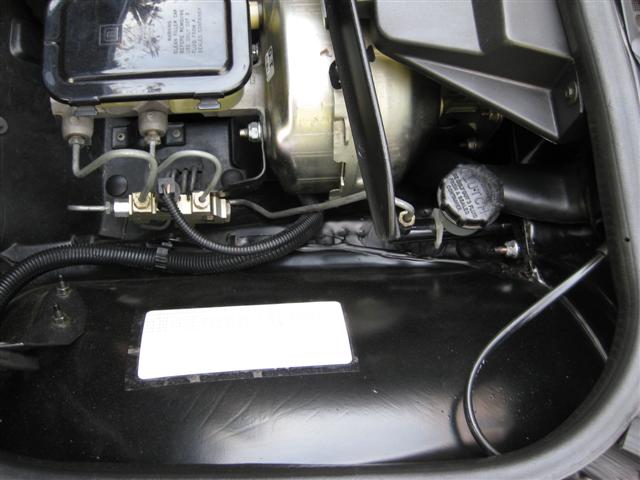

The rest of the install is unexciting. Here's the clutch master cylinder in the car.

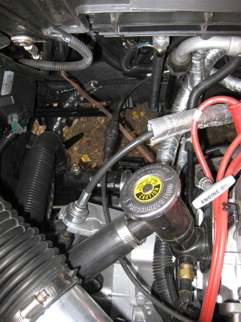

The select/shifter cables clear everything reasonably well.
The bracket for the shifter cable sits fairly high, but a new coolant hose has a long enough end to clear it.
The slave cylinder is more easily accessible than in V6 applications - no exhaust crossover in the way!

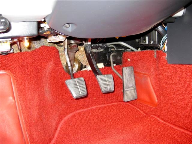

I now have 3 pedals were I only had a brake and gas pedal before.
Wiring in the clutch and cruise switches was VERY simple.

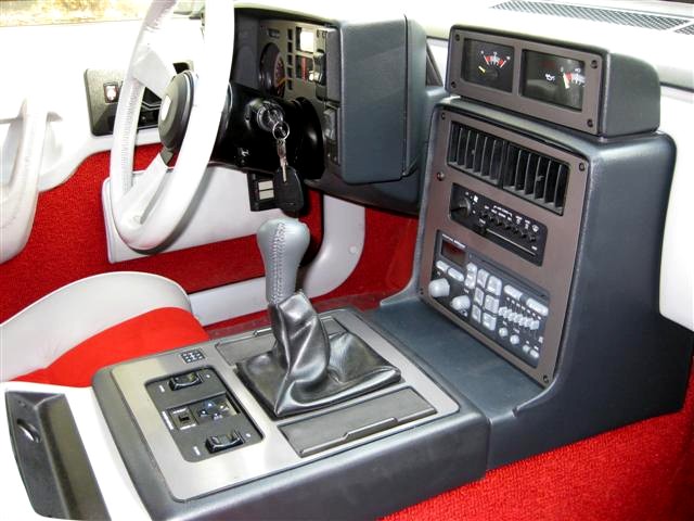

... and I installed an 84 short shifter and Getrag 5-speed shifter surround.
I changed all my bezels to brushed silver ones - to match the gauges and shifter plate.
(STILL looking for a silver manual shifter surround in MINT condition)
I got a recovered leather shift knob from mmeyer86gt/gtp (excellent value!!)
