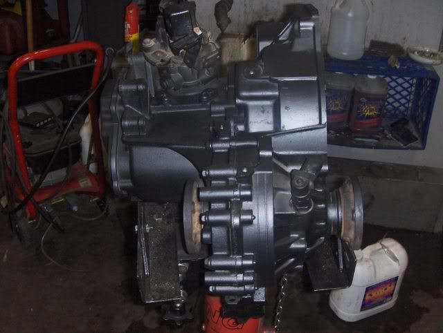

ok, I'm home after a nice 14 hour day (four hours spent with the Fiero). I completely changed the original plans for the mounts. Using the OE VW mounts on the space frame of the Fiero just wasn't working for me. It worked, but I really wasn't happy with the outcome. So, I decided to try and just make a few sets to mount the drivetrain to the cradle. I have two of the mounts completed....I just need to paint them. I made templates for future mounts to make it easier for next time. By the end of the week, I should have the engine mounted to the cradle for the final time. Thus far, no notching of the frame or engine compartment has needed to be done. I removed the dogbone mount for a nicer looking compartment. I'll post pics prior to installing the engine. The transmission is all back together and ready for abuse. Here is a link to the supplier of the differential. I'm hoping this makes a huge difference in the characteristics of the car. http://www.mjmautohaus.com/...spd&products_id=1029 Here is a pic of the transmission ready to go back in.

Out of curiosity, are those CV shaft flanges bolted (or otherwise positively secured) to the diff, or are they a snap ring style, like the Fiero?
