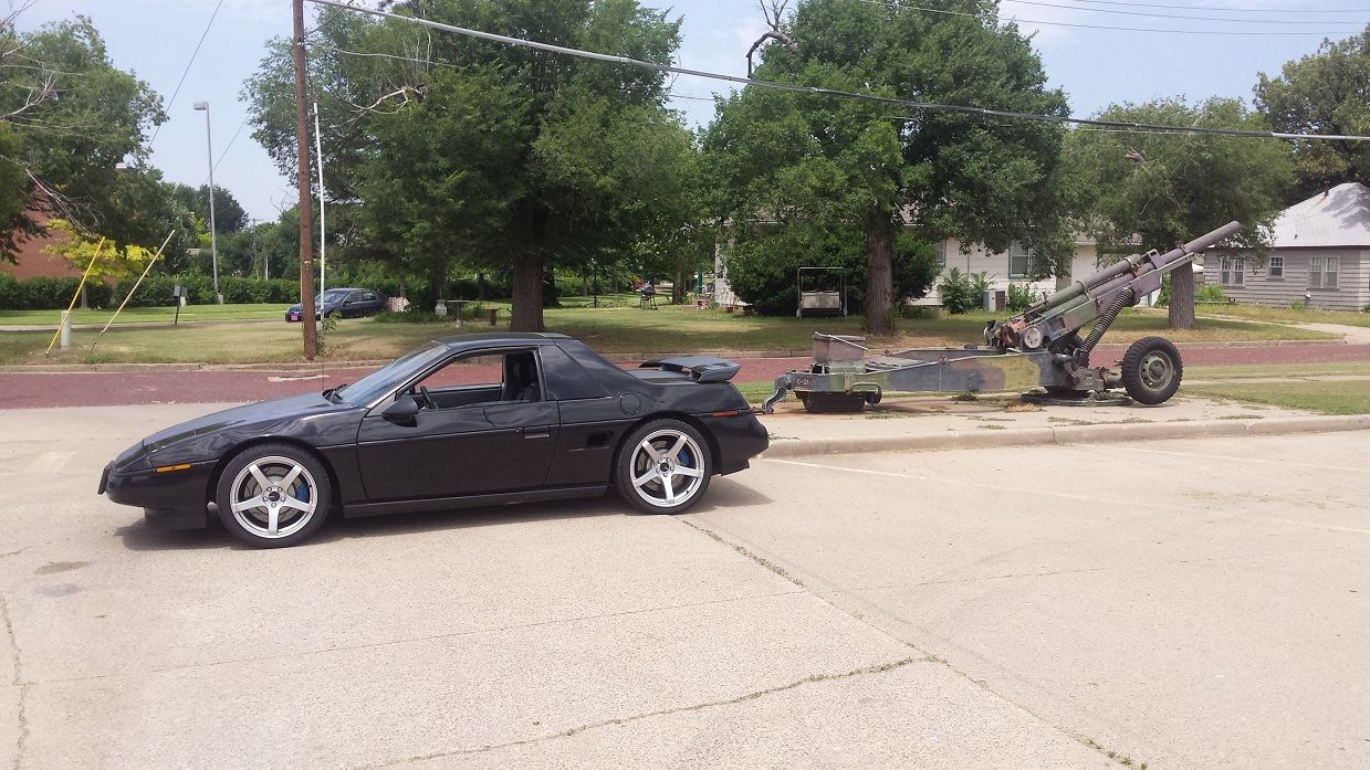

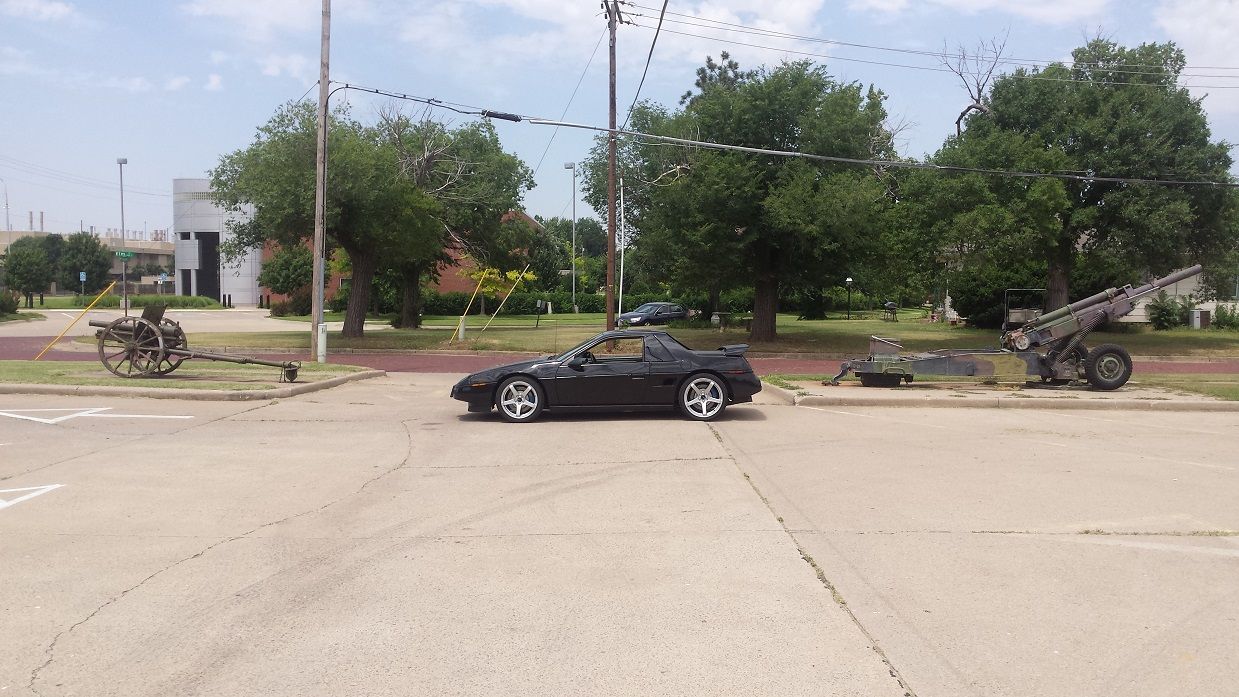

Here are a couple more pics from today:
Whitley Dam:

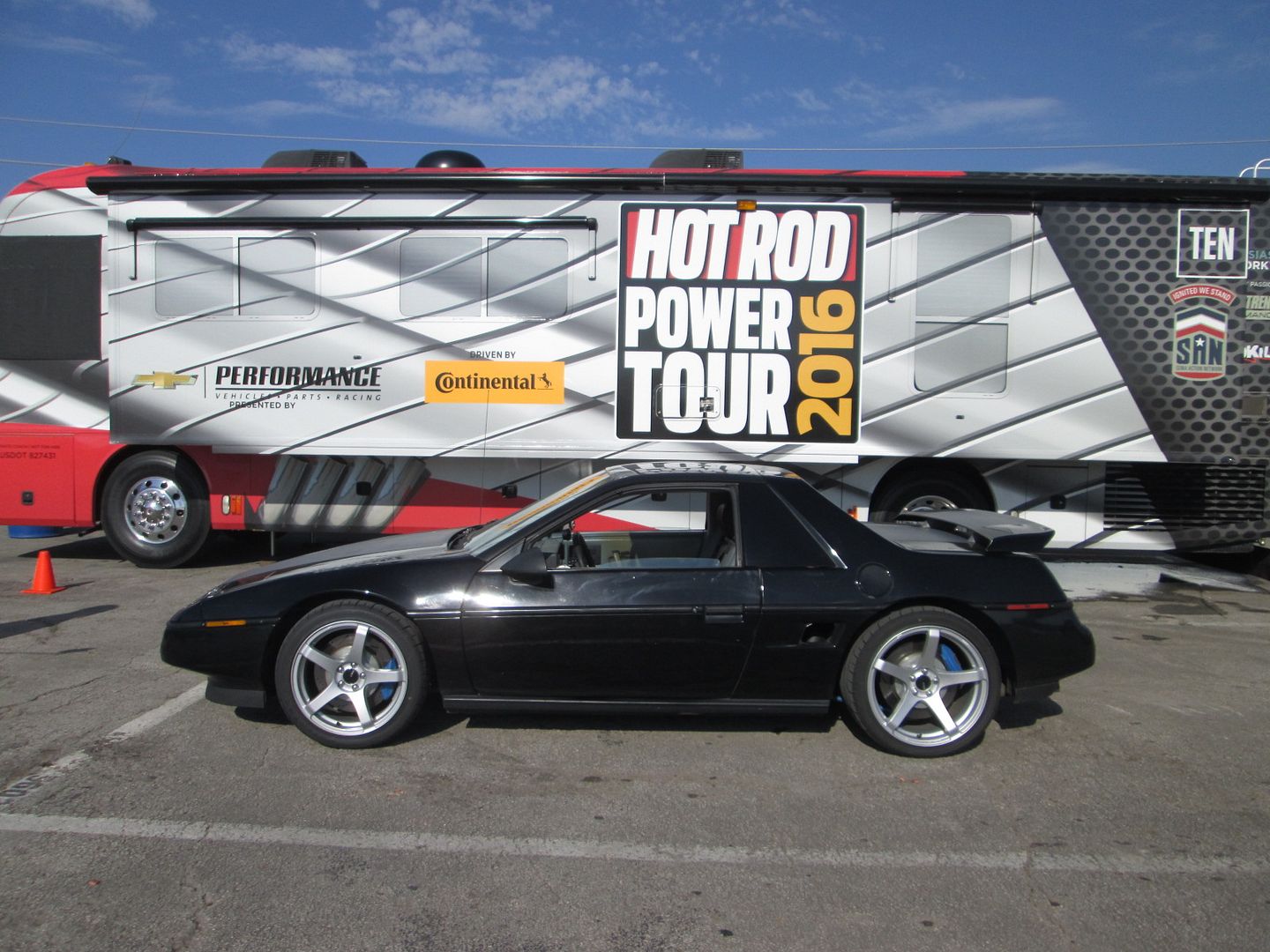

HRPT Bus:

Car look bad azz. I like the wheels. Perfect setup for an 88.

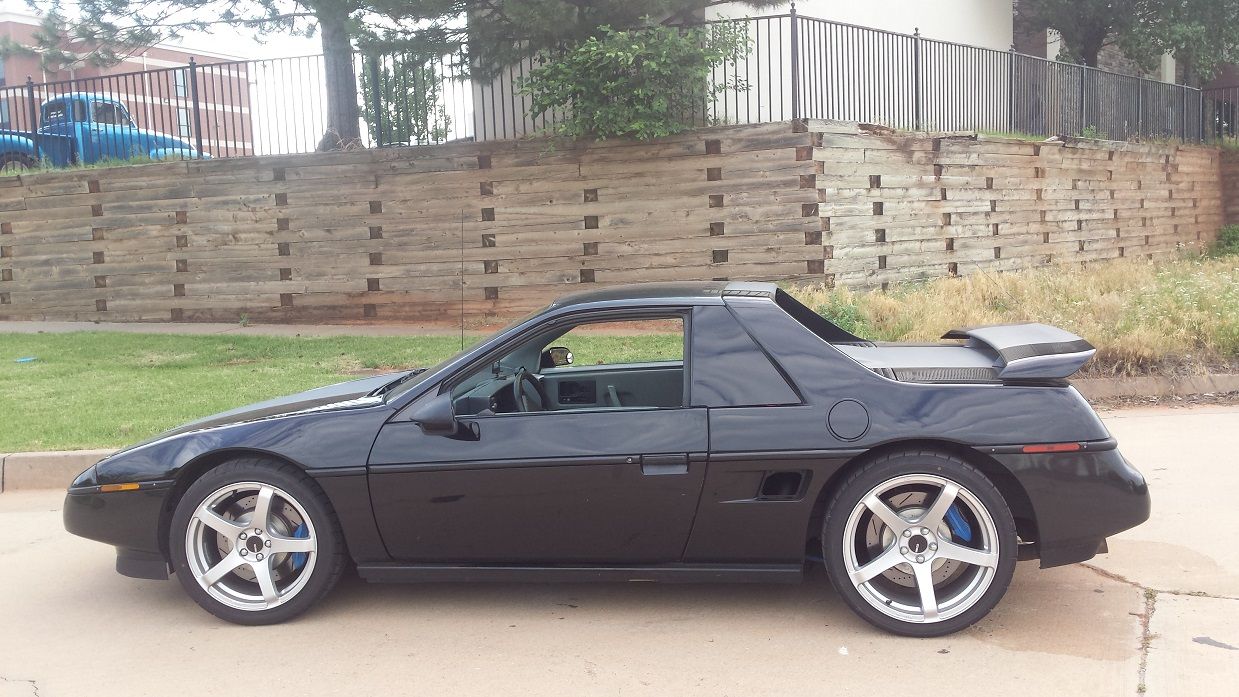

Here are a couple more pics of my fiero out and about:

Are those wheels Enkei kojins? I've been looking at those but in matt black. What size wheel and tires are you running?

Yes. 17x8 45et front and 18x9.5 45et rear Tires 235/40/17 front and 285/30/18 rear

Staggered wheels look perfect on a Fiero due to its smaller front nose and bulkier rear end. I'm surprised more people don't do it.

Awesome! The exact sizes I was looking at! They look amazing.
