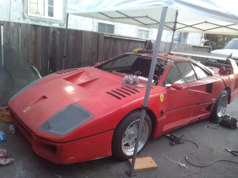

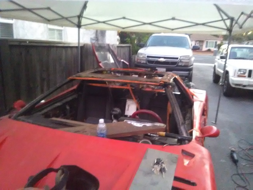

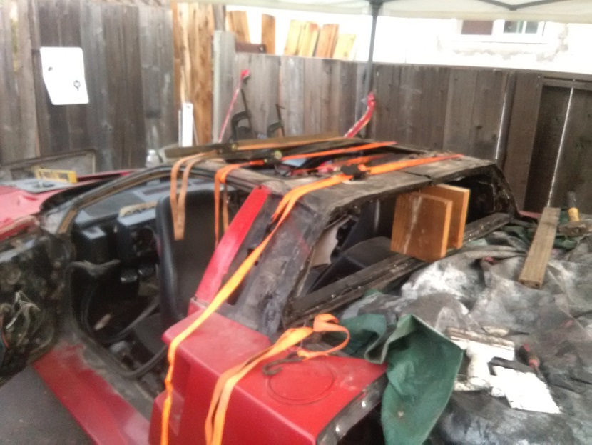

Got smore done today, cut it up n bent everything into place. Didnt have to cut much, removed the center 4" and made some relief cuts at the bottoms of the inside pillars and bent errthang w some ratchet straps. Pretty much reddy for welding now.
hard parts gonna be the door windows, ill be on that soon enough
thanks for watching

That's some pretty sweet work. Both sides bend in evenly when you did that, or did you have to massage it to get them to?
shemdogg
OCT 02, 10:04 PM

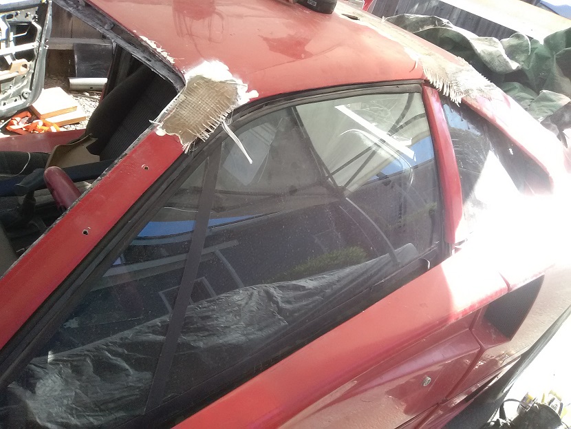

they bent in eventually, made some minor relief cuts at some seams to help.

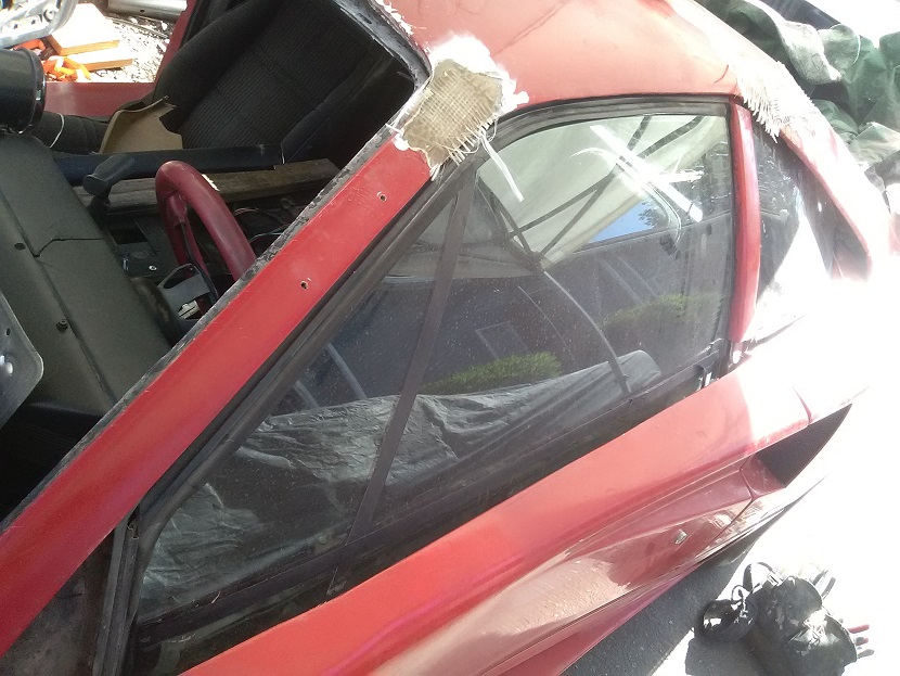

And what a difference! im happy as f#$%
major bonus! the door windows almost touch the seals, I thought theyd be waaaay off Fiberglass tomorrow

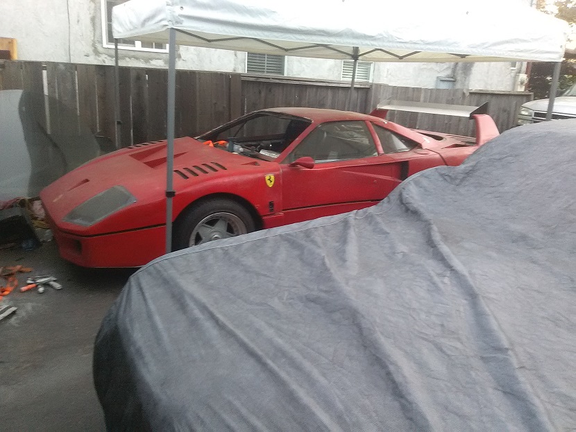

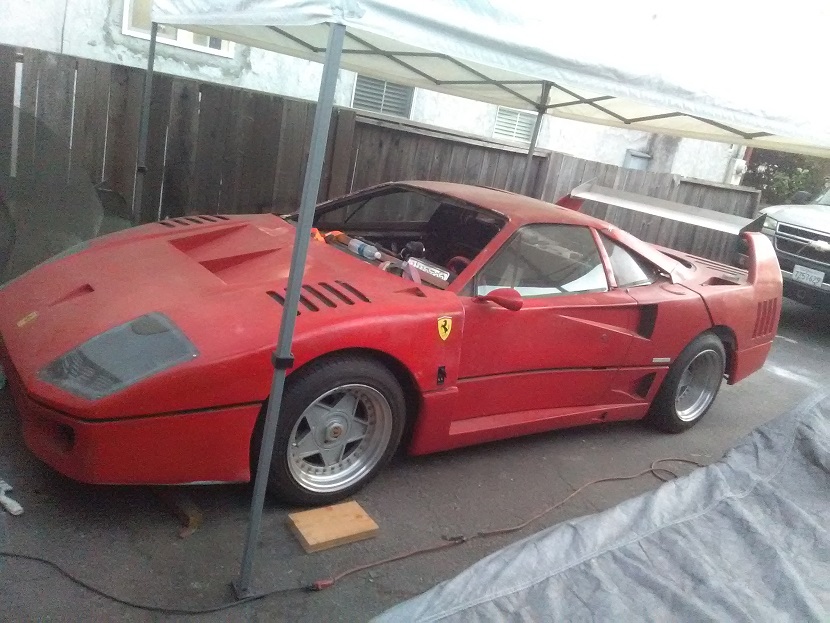

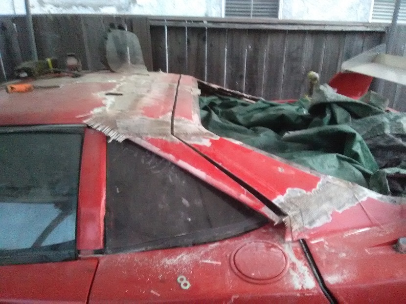

got the roof boogered together to hold and cut the trunk how its possed to be
Got the windows to seal up nicely before
Only a 1/4" from the top seal, moved the seal bracket outward a bit after
Going to tap soon for front n rear windows, n more glas
looking better everyday

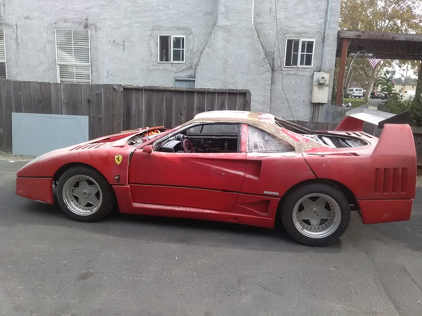

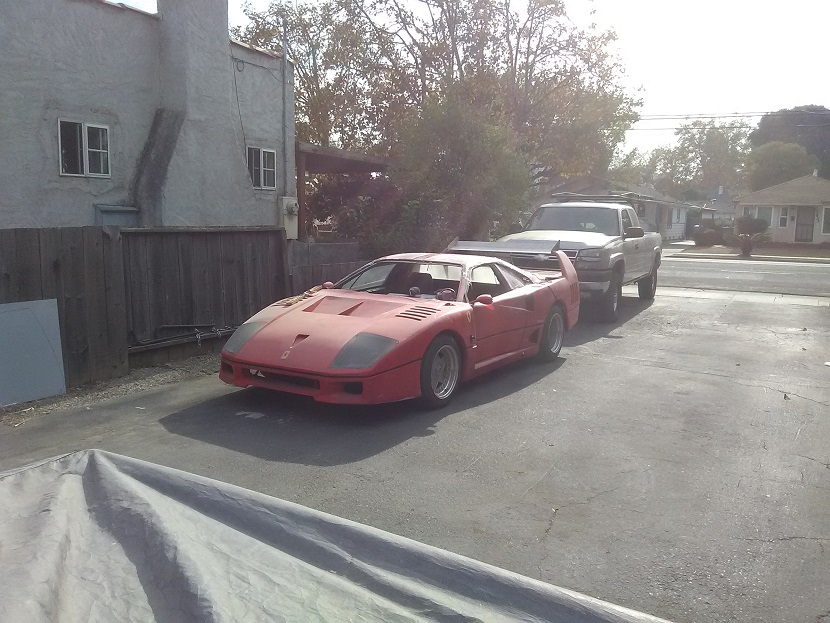

shemdogg
OCT 10, 07:41 PM
Still goin.... Lotsa sanding, fiberglassing, cutting, n welding.

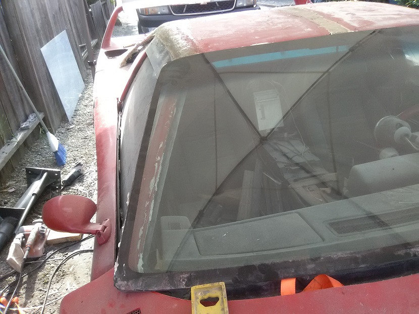

Heres how the original windshield looks on the car now
 bringing the roof in really made a yuuuge dif
in this pic the whole car looks proportional except for the very rear looks too big
distance shot
narrowing the roof made a big difference, im very happy w the way its coming out
shem
