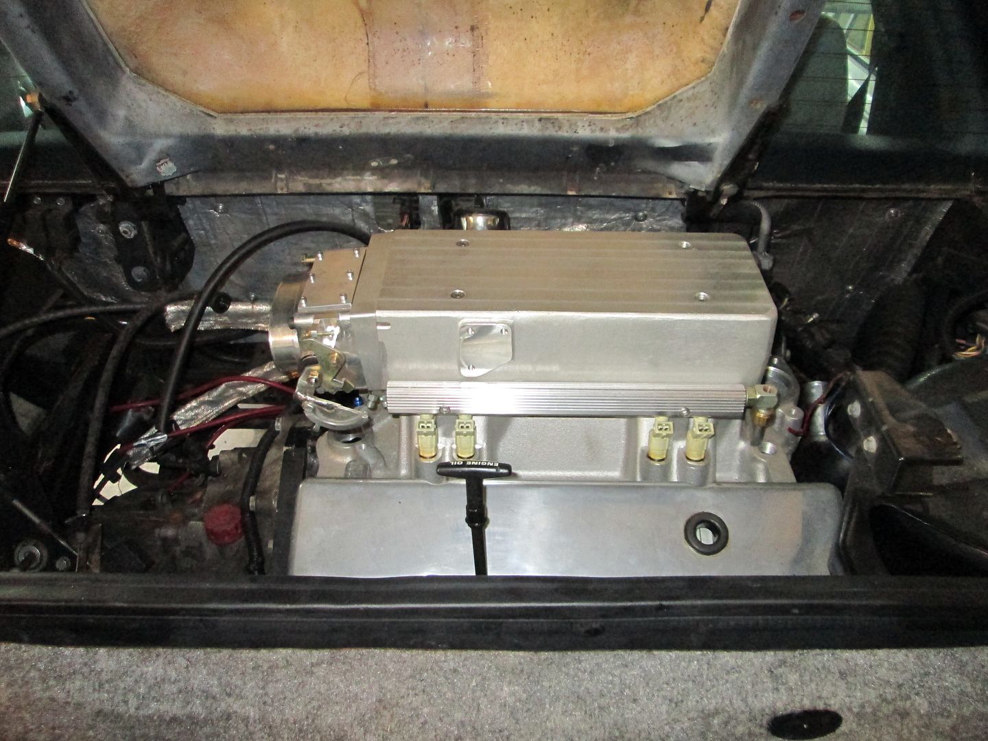

The car already has a pretty stout engine with the chassis dyno chart to prove it (371 whp), so its doesn't need much upgrading there (roller rockers and valve springs). I get the honor of performing the upgrade to fuel injection to this setup while refining the rest of the swap into something he can be proud to show off.
The fuel injection conversion will use a modified Holley Stealth Ram intake controlled via an LS1 ecm. Here is a teaser pic:

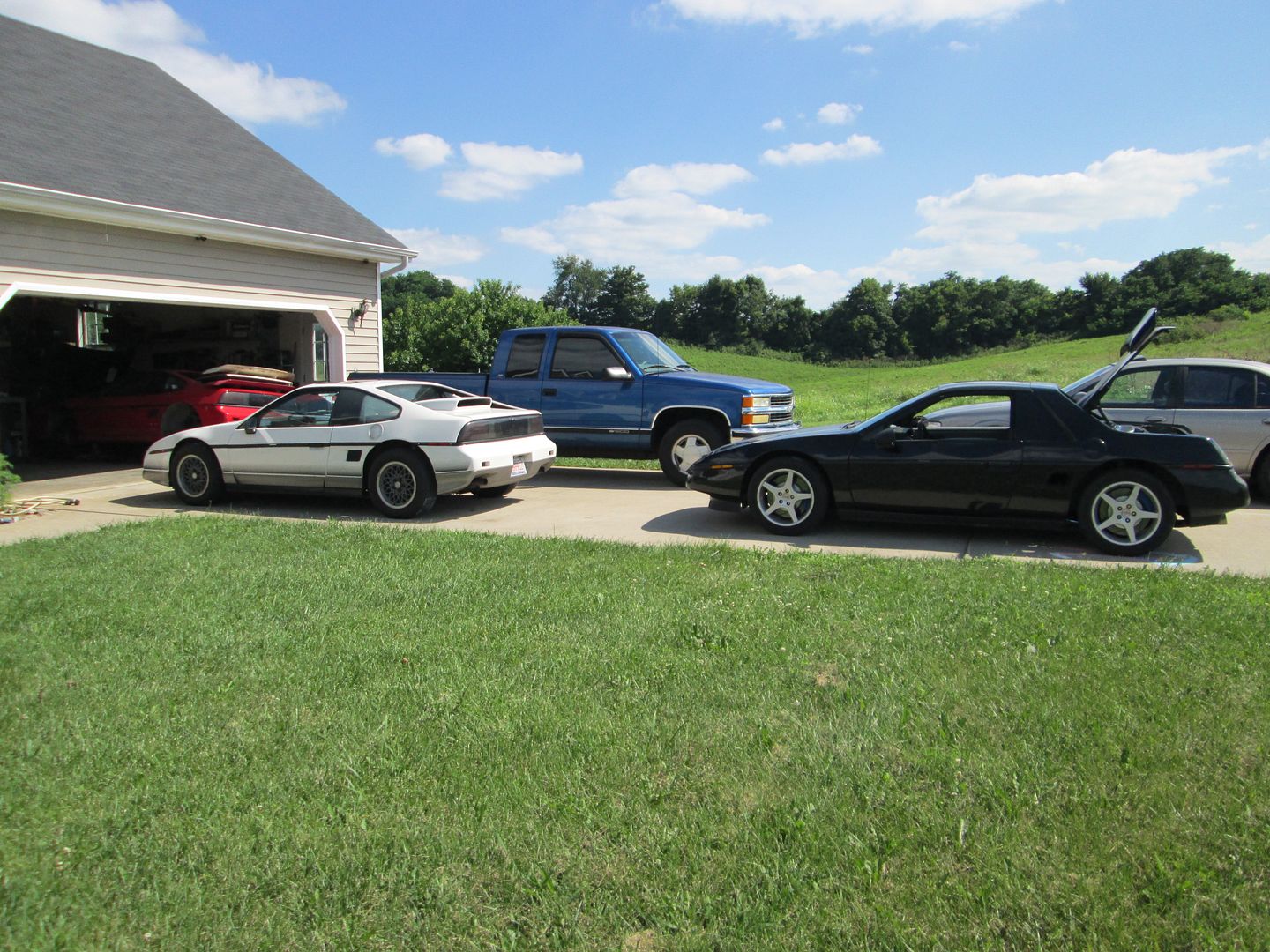

fieroguru
JUL 27, 05:22 PM

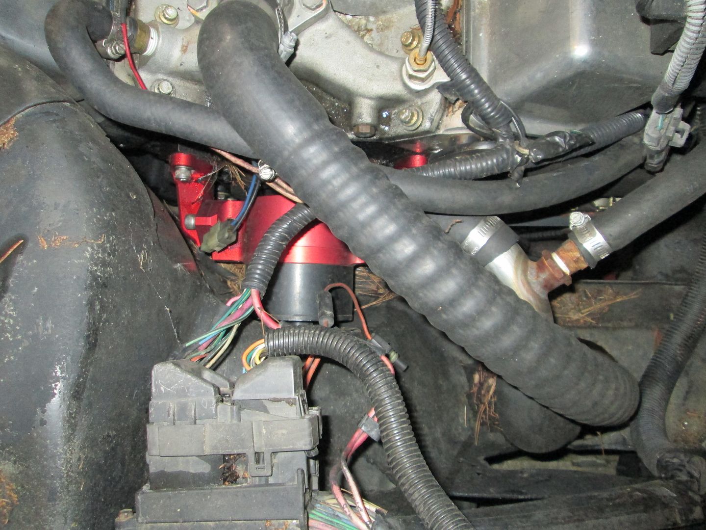

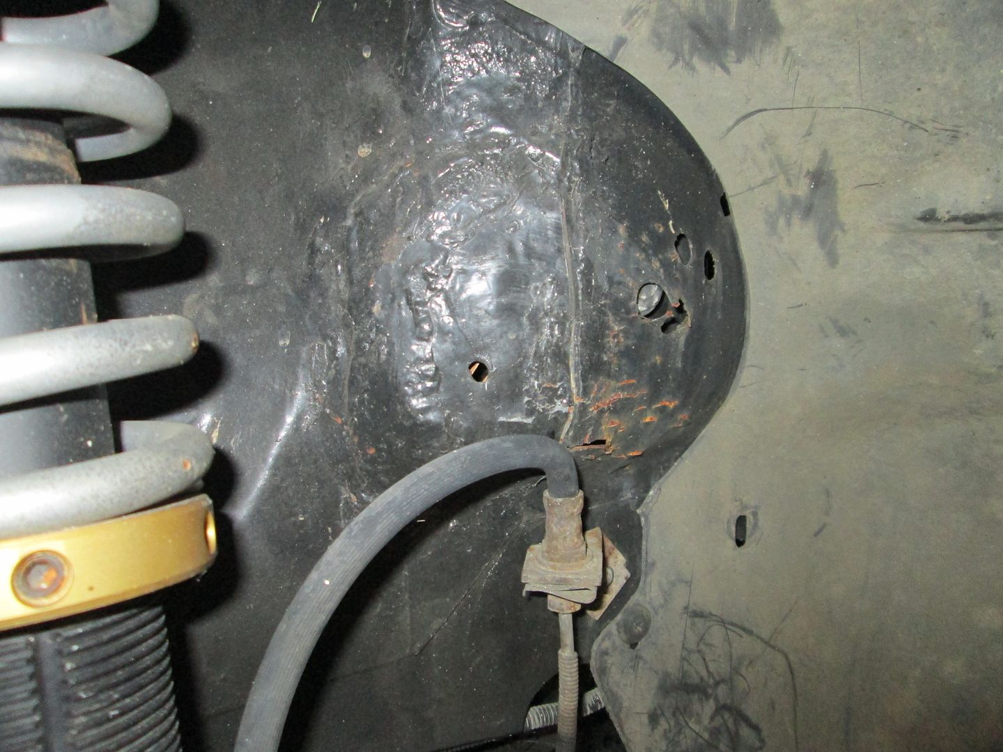

Here are a few before pictures:
One of the more interesting aspects of this car is the electric water pump was bolted to the engine without cutting into the wheel well sheet metal. Instead to make the needed clearance they hammered the area outward for clearance. I hadn't ever seen one done this way and think this approach might be better than cutting the hole as it keeps the pump protected from wheel well debris. The pump will be remote mounted as part of the work.

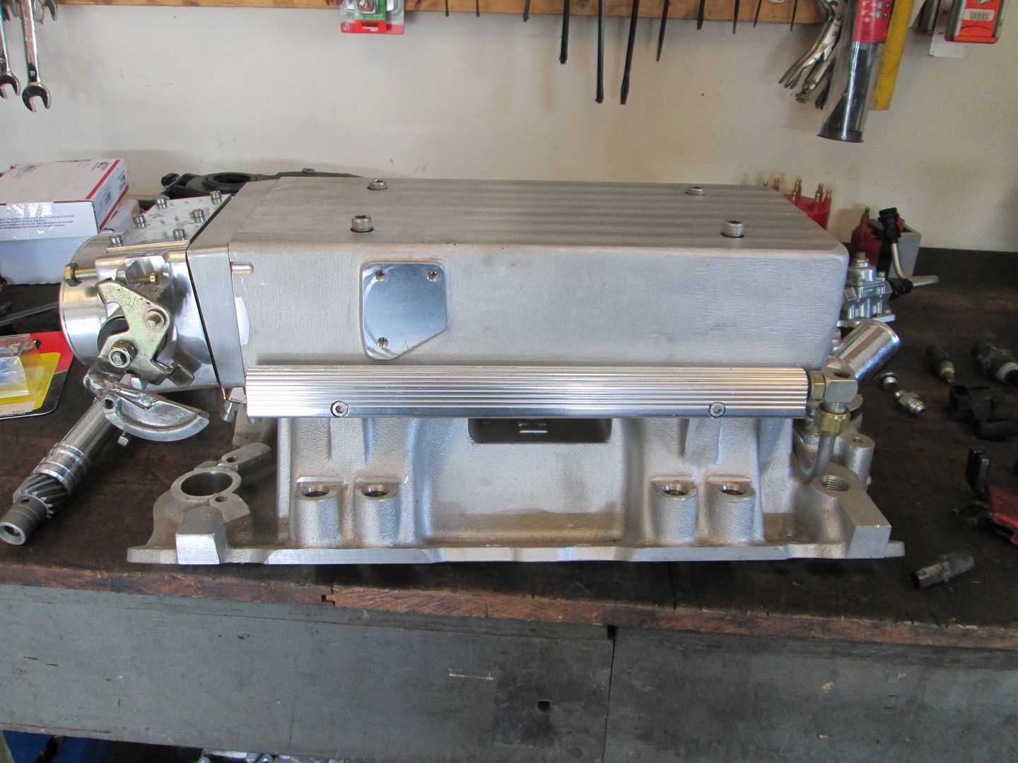

Here is a teaser pic of what the engine swap will look like when done... HSR intake, upper plenum flipped, twin 58mm throttle body. The engine will be lowered as part of the rework to gain the needed clearance for this intake to clear the decklid. Disclaimer: the height of this particular HSR is 9", but a stock one is 10" tall. This intake was modified by gusshotrod to make it lower several years ago, and this modification is what allows it to have a chance of fitting w/o a decklid support notch.
