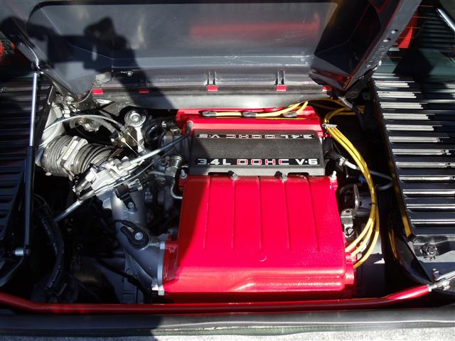

There are several people wanting to know were I got the air can from. The can is out of a early 90's 3.1 V6 Beretta, Cosica. Lumina Euro. The can has a metal base that I remove and then mount to the Fiero Air filter base with the spider removed. On Nolan's 3.4 I ran a 3 inch intake from the Air Scoop that I installed. I welded a 3 inch mandrel bent tube to the air filter base. So it is 3 inch from the scoop all the way to the engine. I can post pics if anyone wants them.

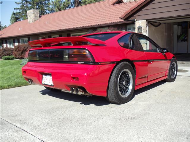

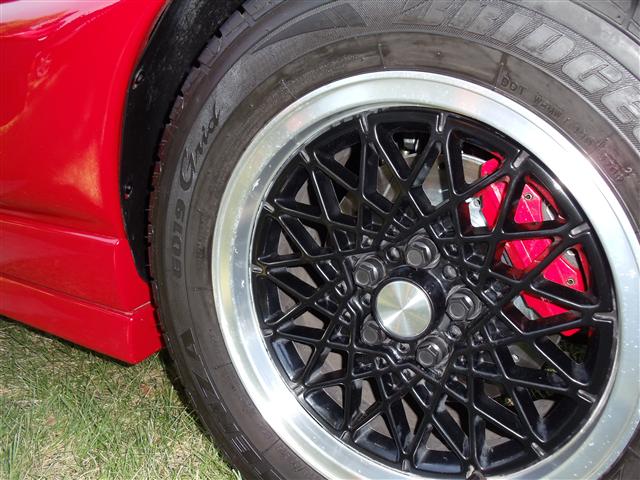

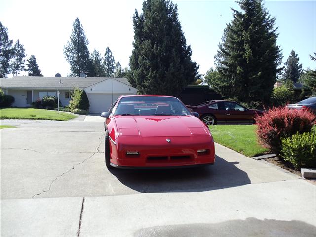

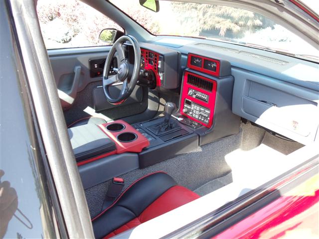

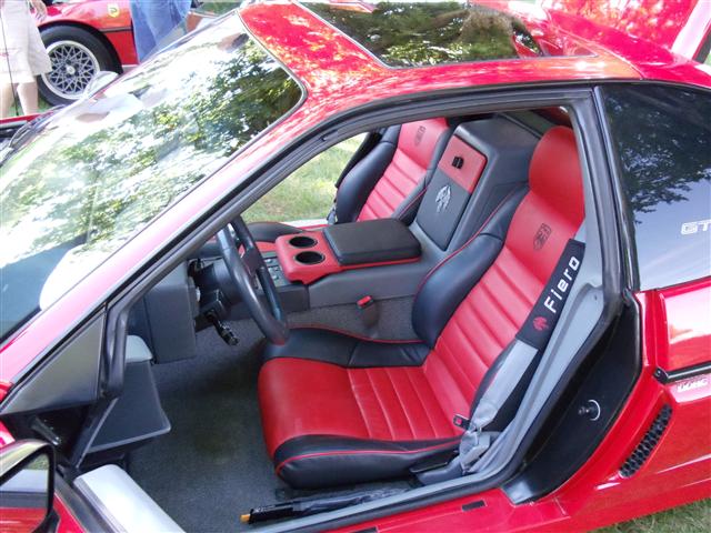

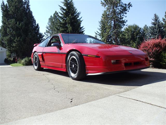

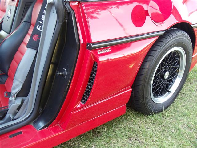

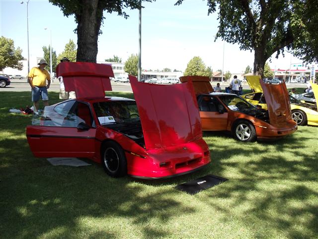

Just saw this car at Northwest FieroFest this weekend. Holy cow! It's simply breathtaking. Makes me wanna put an LQ1 in my Fiero, BAD.
Tony Kania
AUG 16, 10:24 AM
Yes, we need your take on the car. It is just as amazing as the pictures, and won many awards this weekend. Deservedly so...
