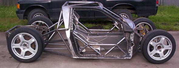

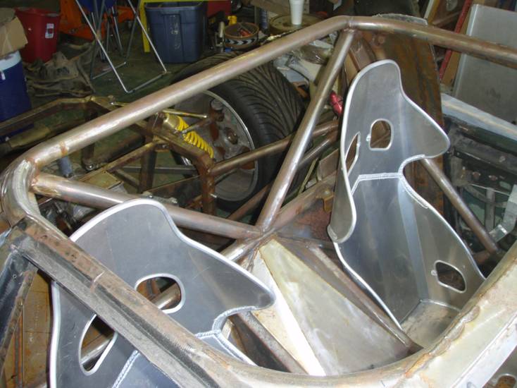

here are a few frame photos

HTXtremes
JUN 02, 12:57 AM

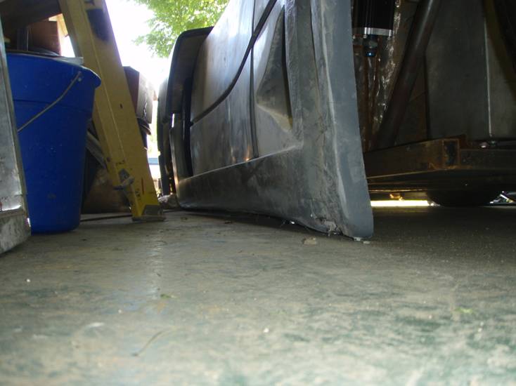

Got a couple pics after I got the frame home
first one is of the ground clearance (it is not touching the ground, lacks about 1/4")
last one is where I removed the metal rear window

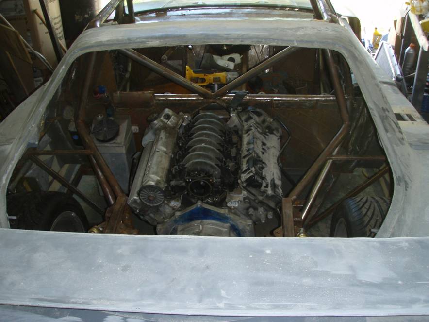

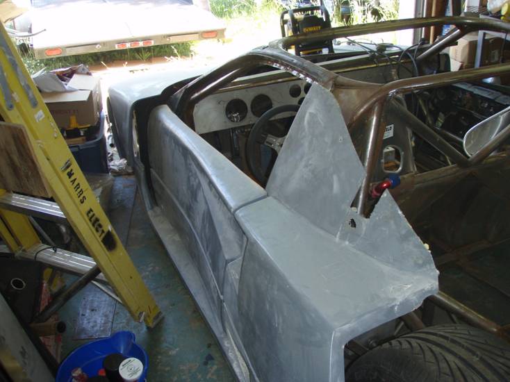

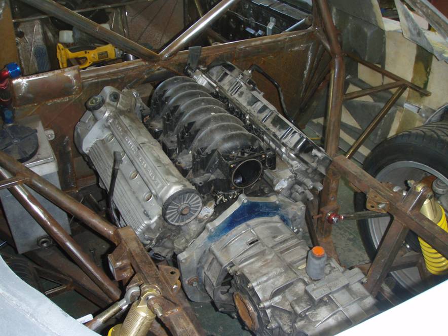

HTXtremes
JUL 20, 10:57 PM
some updates of the motor in the tube chassis
Had to get a little color on it! lol this is with the Eclipse windscreen
