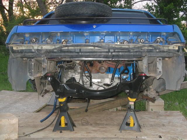

Monday morning it was time to get this car moving. We remade the fuel lines. Dad did the fittings and I bend the lines where I wanted. I routed them between the ISC and alternator bracket. Looks very clean now. I also relocated the MAP sensor so I could use the stock intake for a while. The tube is from an 85 2.5 fiero. The EGR silinoid was moved also for a cleaner look. I put on most of the loom for the wiring. I still have some work there to finalize everything but it came out very good. It was time to take the first test drive. When we fired it up again It sounded like we lost a cylinder. It had to be moved out of the shop so I drove it like that around the building and backed it in. I could tell it is going to be a fun car even with only a 15 sec test drive. Eventually we found the ground wire for the ECM had broken at the loop. Not completely, but enough to cause a problem. Once I replaced it everything worked great again. It was running very near perfect.
But it was short lived. It developed another problem.
Time was short and I had to start the drive home. So here is where I'm stuck at the moment. Maybe someone can help me out?
Car starts and idles perfect. When you give it gas though it bogs down and tries to die. It won't take ANY throttle. Everything was working perfectly for a little while. I'm leaning towards the loss of the MAP or possibly another sensor. I really don't know for sure right now. I can't run any tests since the car is so far away either. I didn't get a chance to check it again once it cooled so I don't even know if its heat related. Anyone have any ideas?
All in all it was a good weekend. It sounds great and its running. I'll get the rest figured out later and finally get my test drives. I'll get more pics and vids later when I can make it back down. Hopefully have the first real test drive on video also. We'll see. Later.
