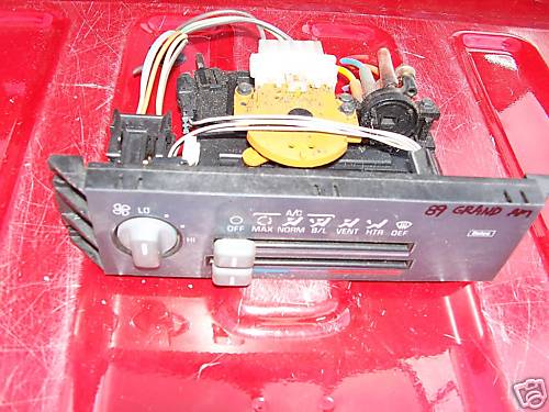

I am about done with my firebird swap and have enjoyed this thread. I used a 99 interior, got a 93 cluster and eventually got speedhut gauges after dealing with the oem gauges. That being said, and maybe I missed this in the 26 pages of this topic, but I found that using a grand am temp control dial was a direct swap from fiero to firebird control. It uses a rotary screw type dial to bring the cable in and out rather than left to right. I did have to whittle it down a little to get the dial post out enough but it is a direct fit. Even the tab to secure the cable sleeve to the slider is a direct fit. I could post pics if you want. Other than that great job on paving the way and creating a great foundation on what is an excellent idea!

I've been asked multiple times for a Firebird HVAC solution and I never progressed beyond the prototype in my car. A couple of other have done it as well, (Mickey Moose has a two motor electric unit which is really slick).
But I've yest to see a Grand am temp control. Please post pics of that and how you did it.

Is it this one 88 to 91

| quote | Originally posted by Boogaloo:
Is it this one 88 to 91  |
ok thanks. This is another option for people that want something newer.
