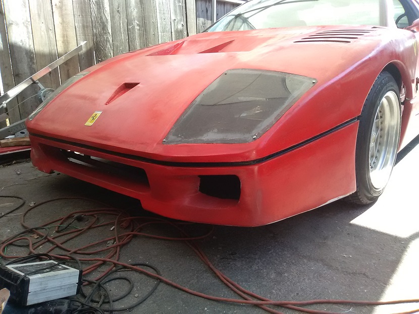

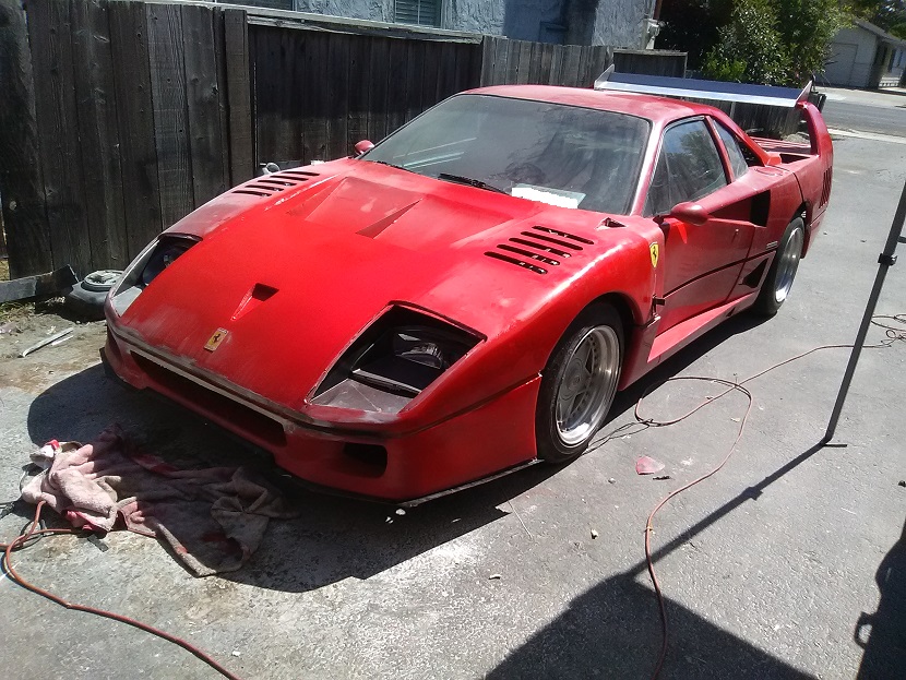

Yawn- shemdogg tired. This heat takes my energy away. Been poking around on the car a bit. got the motor secured so it wont bounce around now, one bracket was waay out and the motor was sitting sideways a bit. Filling in lil divots n stuff and working on cleaning up the front groove. Also made some wheel well edges. Only good thing about this heat is the fb and bondo dries in 10 mins so im able to get a few rounds a day in.
yawn shem
shemdogg
JUL 26, 07:06 PM

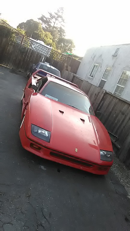

To think it looked like this a few months ago lol what a turd. Cant see the front wheels, hood so long u could land a 747 on it or throw a wedding party. Hood looks like a wedge of cheese off a wheel
shem

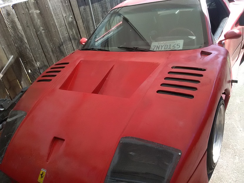

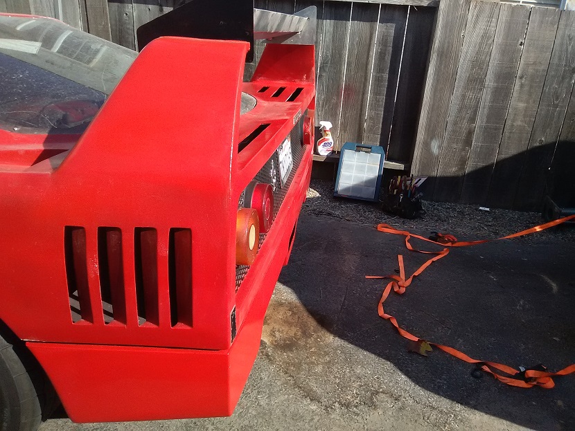

Still poking around, had some mechanical and electrical issues. Got mot of them sorted. epoxied some bolts to the underside of the hood then glassed them in to hold my grills
done lotsa sanding on this hood groove, got the edges nice and crispy

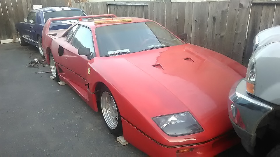

hooked up some ratchet straps to the back bumper and to my truck to pull the pushed in right corner back to level w the top trunk
made a portable trunk support out of a 1x4 and got a tool kit in the trunk for breakdowns

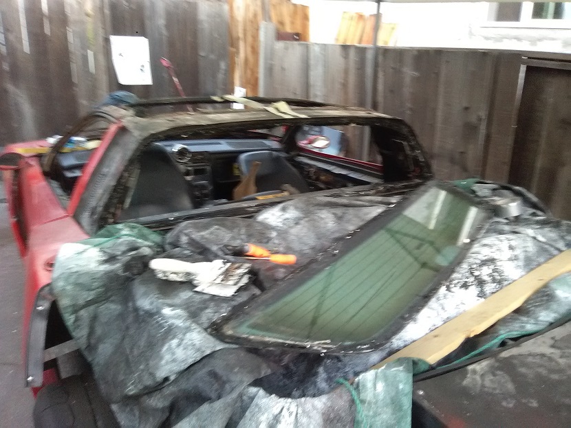

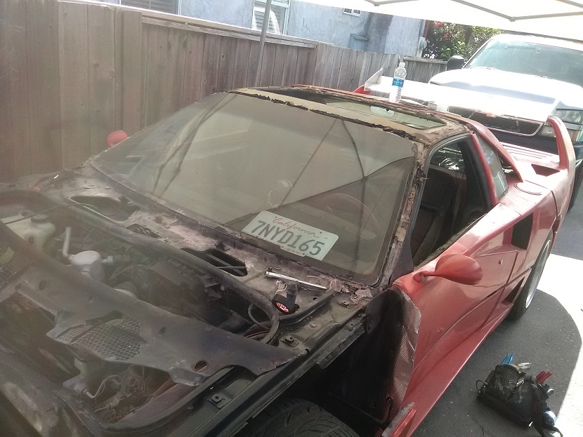

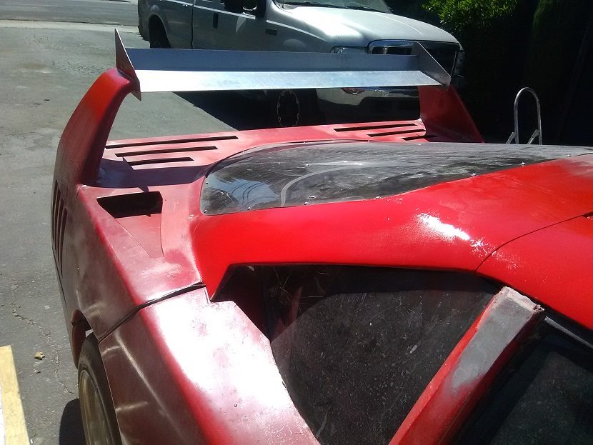

Made some time to work on the car yesterday n today. works been insanely busy n back been bugging me. Been tossing the idea around of making the roof proportional to the rest of the car forever now. I started pulling the car apart yesterday n figure my way along. Narrow the top by 4 inches and Going to chop the back a few inches so it slopes down, reinforce it, then adjust the fiberglass to fit. Making a polycarb windshield and back window. chopping the door panels so the side windows swing in to match the door opening. Rotating the window assy to give me more rake on the front and match the top down slope. Stripping the car was done in a few hours, spend an insane amount of time pulling the back window. more insanity to come
shem

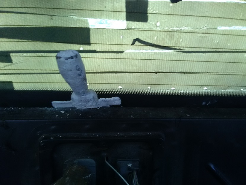

 how i got that damn back window out

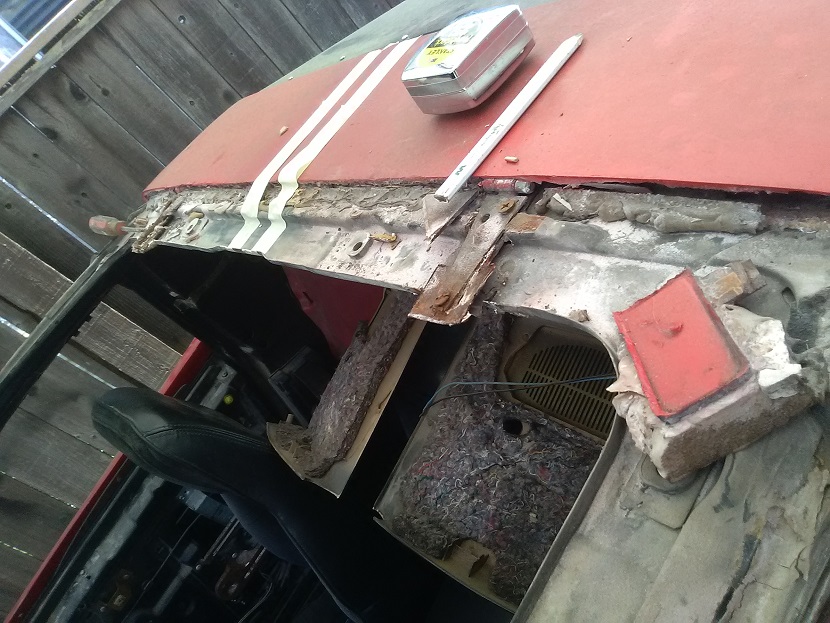

Uncovered some cheese lol
Peep the shitty hinge setup, and they has a 1/4" glue holding a piece of particle board door casing, to another 1/4" o glue holding the top hinge cover
peep the custom zip ties holding this door wiring down. yowza!
this whole tops boogered on lol
