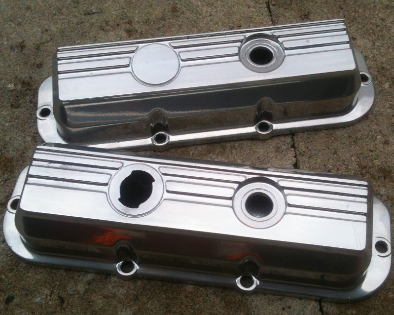

That actually looks like a style. If you did the valvecovers the same.
[This message has been edited by 2.5 (edited 05-09-2012).]
JohnWPB MAY 09, 04:35 PM
LOL, I DID, kinda think that... reminds me of that glaze from pottery class back in school, the one that turns all different colors.....

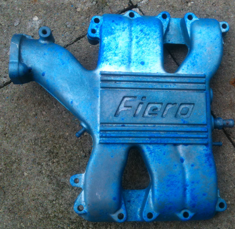

Ok, I bought the ver last can of Permatex gasket remover in the tri-county area it seems! This stuff works fantastic for removing powder coating! The problem is, that it seems to have been discontinued, as in no longer manufactured! The guy at my local part store, (By local I mean just 3 stores locally, and they KNOW parts and service!) called 3 distribution warehouses, and can not get it any longer If any one wants this stuff, I suggest calling local parts stores, and googling it and buy it up while it is available!
This is what it looks like:
I sprayed the intake with it, let it sit like 5 minutes, and washed it with a good spray nozzle. This is what it looked like after the first spray down:
I repeated this about 3-4 times till all ill powder coating was off. Once you spray it once, the top layer washes right off, and the rest becomes kinda "goopy" and won't just rinse off. Thus, why I did it a few times. If you have a pressure washer, you could probably spray it on, let it sit 5 minutes, and hit it with the pressure washer to remove all of it in one shot.

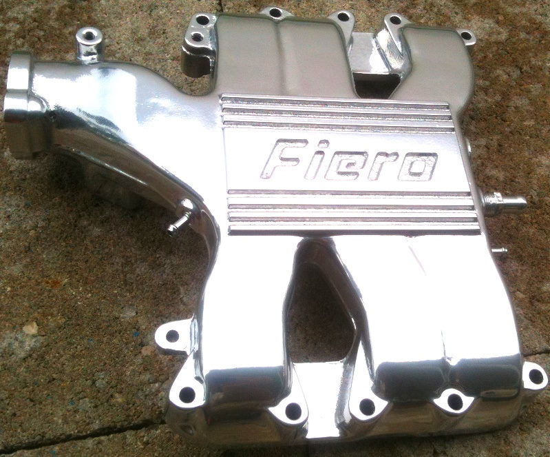

Once it was all removed, I sanded it lightly and degreased it all over again. This was like DeJa'Vu! After that, I put it in the oven at 450 for an hour, to heat it up and remove any gasses and such that created the bubbles 2 times ago when I did this! I took the part out, and with it still hot, hit it with the chrome powder coating. (The new Craftsman gun came in the mail yesterday ).
This is the result:
I have to say, for just a plastic coating, that is melted in, it really does compare fairly closely with chrome.

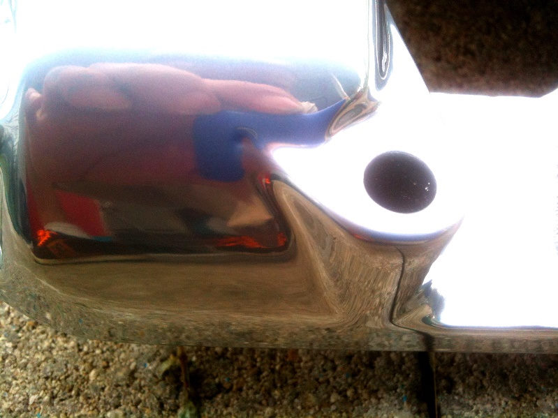

Here is a nice close up, so you can see the reflection of my iPhone, and the cement it is sitting on:

Especially, since the valve covers are done in chrome already as well........
