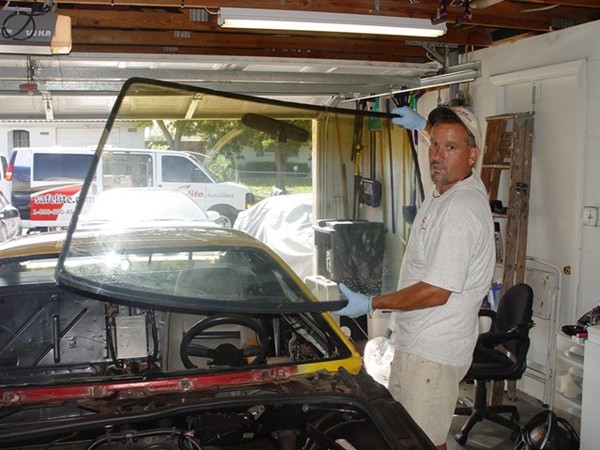

They came out yesterday to install the new windshield. The installer removed my old one and then dry fitted the new one. The molding he had was extremely wide to say the least. It was 1" wide and I told him that he would have to use a different molding cause that was just wayyyyy too wide. It was soo wide that it would not let the windshield sit down into it's place. He agreed with me and said he would come back today with some different molding. Today he comes with some muchhhh better molding, lays out the glue and the spacers that keep the widshield depth. He goes to his truck, pulls out the new glass, brings it into the garage and the suction cup that he was using to carry it, came off and the glass dropped and broke. He called into his supplier and they told him that that was the only one they had. Now he has to find a new piece of glass from somewhere else. It may very well be next week sometime before he gets it.
ARGGGGGHHHHHH! |
My SafeLite guy didn't use no sissy suction cups!
It will get done Jim, just remember what I told you about not letting the installer jam the glass into the upper corners...

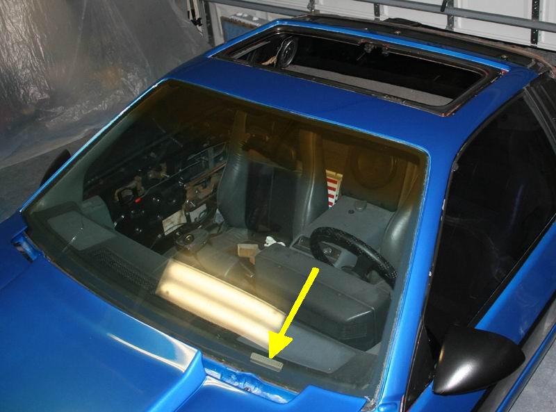

If you haven't gotten the new glass in yet, take the time to shoot your VIN plate black, then lightly sand off the paint leaving the VIN numbers silver and then shoot it with some clear to prevent rust on the numbers, (it's a steel plate)/ It's a nice detail that does get noticed later...trust me.
That's an awesome idea! I'll have to remember that.

| quote | Originally posted by randye: It will get done Jim, just remember what I told you about not letting the installer jam the glass into the upper corners... |
I'm about to have a windshield done, what do you mean by this? ^^^^^^^^^^^^^

The first windshield I had installed by Safelite, the installer jammed the glass with the molding installed on it very firmly into the upper corners at the roofline. This causes the rubber molding to buckle slightly in the corners and it will never lay down correctly. I called and complained to Safelite after the rubber didn't lay down properly after a few days in the heat, (like the first installer swore it eventually would) The second installer that came out had experience with Fieros and noted that the first guy had jammed the glass and molding too hard into the upper corners which causes the aforementioned problem. He removed the glass and reinstalled it properly... VOILA! A world of difference immediately. I was told that the "trick" is to align the glass and molding and drop in down in place leaving approx. 3/8 to 1/4 inch to move it up, and then GENTLY move it slightly upward into place, just so the molding seats in the upper corners correctly. They then tape the glass in position until the urethane sealant hardens.[This message has been edited by randye (edited 07-02-2009).]
