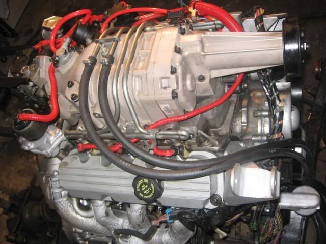

Right now i'm wanting to get the engine in the car and running. Want to test the motor first before I start modding it. I have a 3.25 and a 3.4 pully. Going to put the 3.4 pully on once I get the motor running in the car. Then i'm wanting to get water/meth on it and run the 3.25 pully. Also a CAI in you concider that a mod lol. Thoes are the only mods i'm doing in near future. Planning on buying another 3800SC motor and fully build it from the bottom up. Just don't have the time or money right now with school to do that at this moment. Really just want the car running asap, having withdraws not being able to drive a Fiero O'yea, might not have it running till next week now. I ordered a fuel pump and AC delete kit from wbodystore.com on 12-29....and they just shipped it today, the 9th.

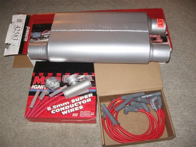

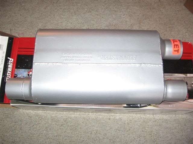

+++++ for Summit Racing! Placed a order on monday, and already got the parts in today! Order a 80series Flowmaster muffler, 8.5 MSD wires, inline T filler w/ cap, and a "intermediate pipe" for the exhaust thats on backorder so I havn't got that in yet. Another step closer to getting the swap done!

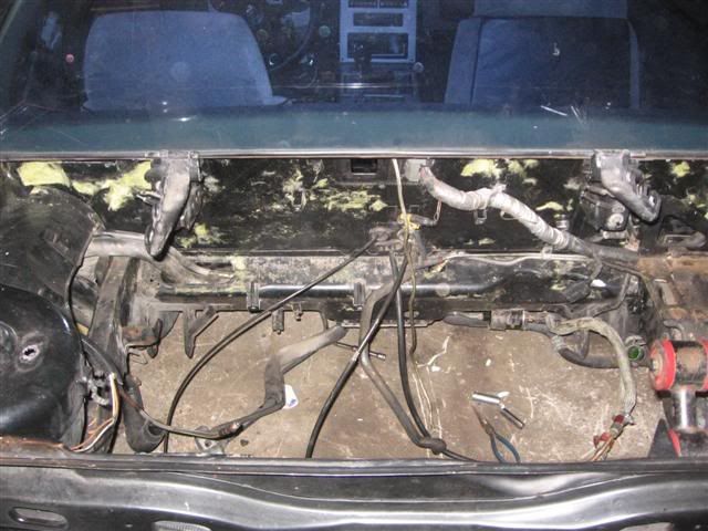

 Next project, fire wall

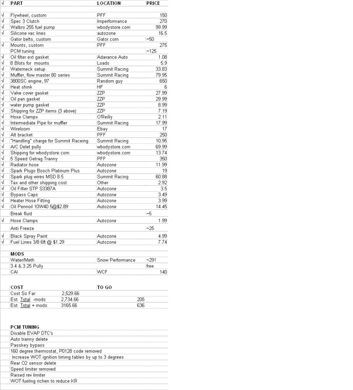

Pretty much got all the parts I need to finish the swap, just waiting on shipping. Heres the updated list of parts

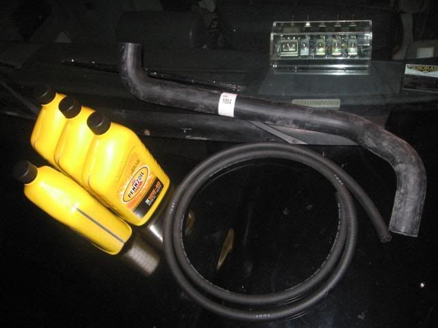

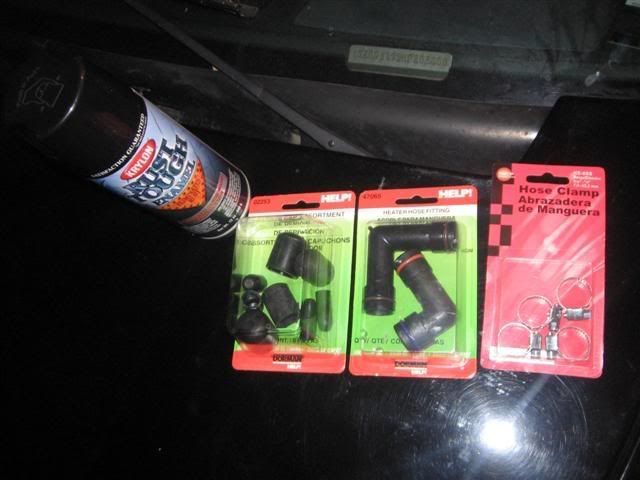

 Picked some some little parts from autozone..fuel lines, radiator hose for passenger side (part #XL-1004), oil, ect

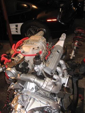

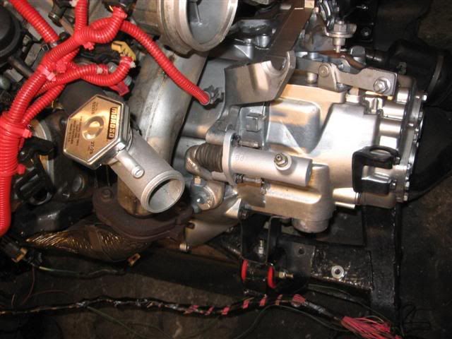

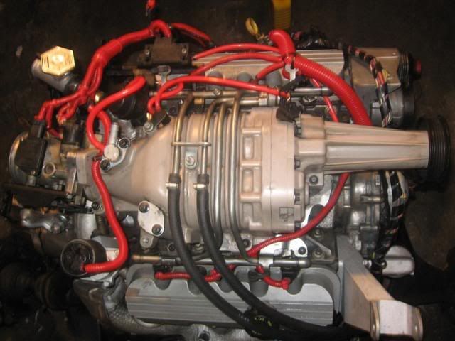

 Finished up mounting the mounts and putting on the parts from autozone on, here's how it looks right now.
