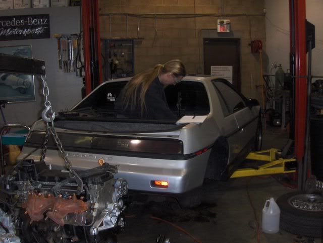

BTW, if Anonymity is out of town, who was the blonde in this chick-in-the-engine-bay shot? (I guess I owe you another beer...)

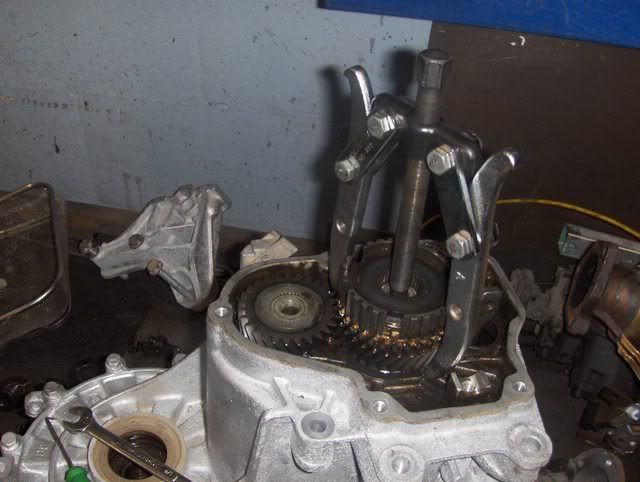

fifth gear must be pressed off to split the case.

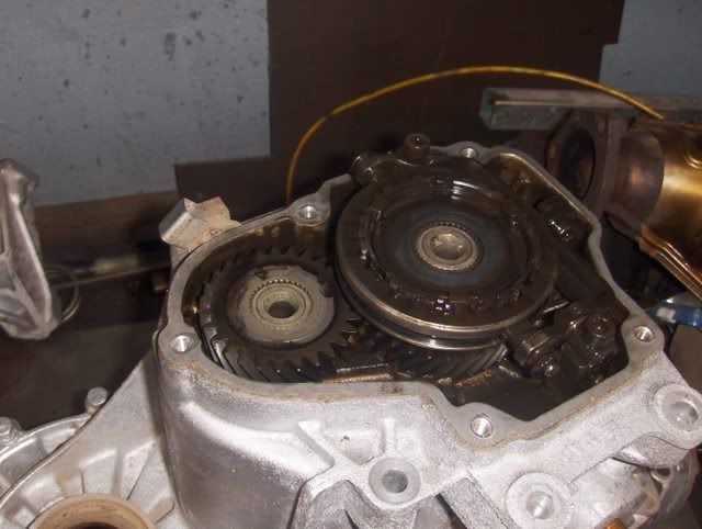

pulling the syncro and gear.

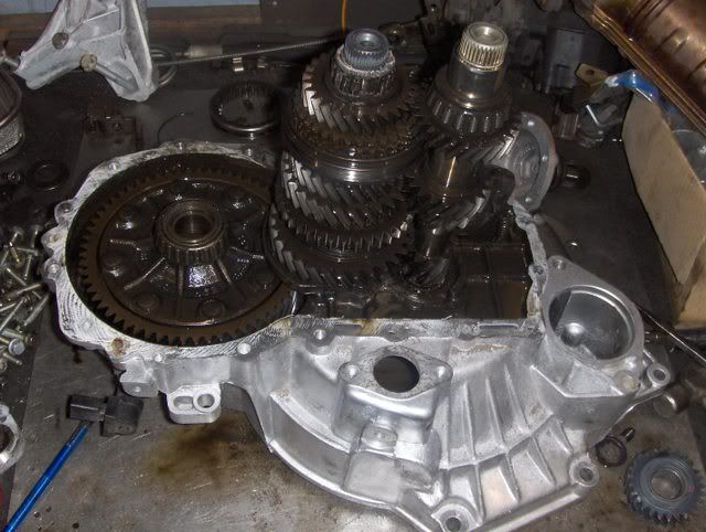

case opened. You can see the bearing damaged. There were other damaged parts not shown here, but the cost of the parts was about $800. A used trans with 60,000 miles was $500.

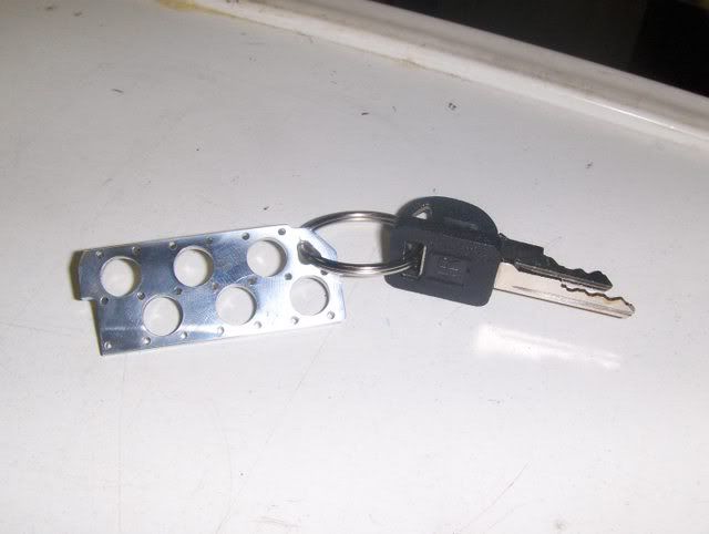

The most crucial part of my swap arrived in the mail today....................
The Keychain.

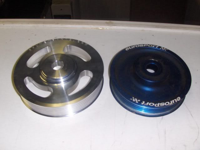

I also was concidering the problems the ugly blue underdrive crankshaft pulley would create. It is a known fact. Blue pulleys lose .75% horsepower. Also, it is a fact that the Fiero has a rep for running a little hot. Slowing down the water pump to gain 3% horsepower is not good in my book. So, doing my research, I purchased a Gruvenparts non-underdrive billet aluminum crankshaft pulley. It weighs in at 500g. and costs $159.00 If I subtract the power steering and a/c compressor, I have my 3% back....not to mention that ugly blue crankshaft pulleys lose .75%, so I just created an advantage.
Ok enough of the BS. Here is a pic.

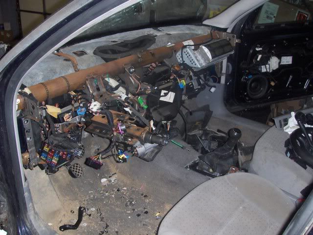

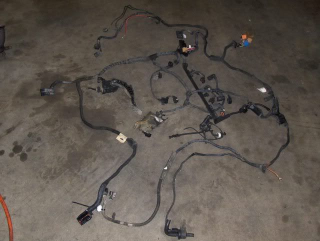

Here is the latest update. I received the transmission and all looks well with it. I am waiting for the Peloquin LSD to arrive...should be any day now. In the meantime, I removed most of the needed wiring and gas pedal from the Jetta. It has all been laid out to see what needs to be shortened/lengthened/removed/added
This is why it is good to get the whole car. I am also parting out the Jetta as I go and have just about broken even on the parts and LSD purchase....and there is a lot of Jetta left.
