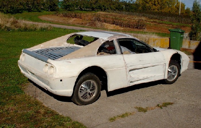

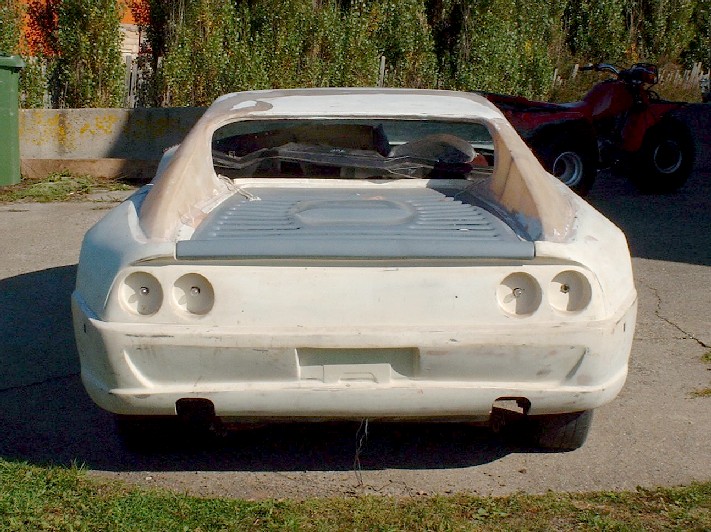

So like the title says, this thread is about building a Ferrari F355 coupe on a 3” stretched ’88 chassis powered by a ’97 Northstar and Pontiac G6 six speed manual transmission. Not exactly breaking new ground, except that I think I’ll be the first one to start and finish an F355 build thread here on PFF. To start the show, a little background first: About ten years ago a friend saw my completed 308 rebody with 305 TPI and decided he wanted something similar. He bought an '88 GT auto with 97,000 kms on the clock and, after buying and returning his first F355 body kit from IFG due to stunningly poor quality panels, he got an exchange for one that was head and shoulders better. (That doesn't say alot if you 've ever dealt with IFG bodies though.) He lost interest in the car after having had the frame professionally stretched the necessary 3" behind the passenger compartment and installing the rear quarters and doors. I bought it as-is a year ago and have been working away to do it justice ever since. Afterall, an '88 GT deserves better than to languish as an unfinished kit.

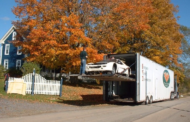

So here it was in all of my excitement as the transport truck pulled up in front of the house to deliver the car to Nova Scotia from Cornwall, Ontario.

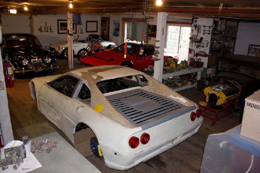

For the price that was being offered, I bought it sight unseen and wasn't disappointed. Obviously it would need lots of work, money, space, and patience to make it look anything like a real F355, but I'm no stranger to this kind of work as my 308 kit was no better when it started its life. Here it is once it was unloaded and dragged up to the back of my workshop, and like everything else, it soon found a happy spot among some cool other cars.

rourke_87_T-Top
APR 25, 12:49 AM
Thanks for sharing, I'll be watching for the Northstar related technical and fabrication. Is that a 32-34 model B cab on the right of the photo ?
