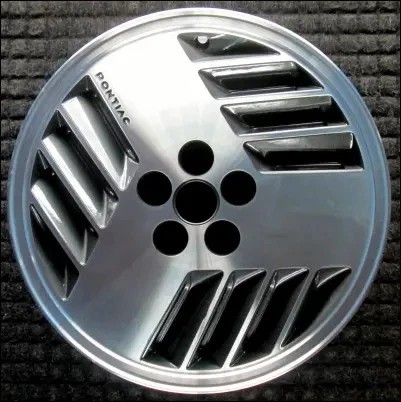

I upgraded the '87 SE I owned a 1/4 century ago to early '90s Grand Am SE 16 inchers...I used 205/55 tires on all four corners, which were stock for the GA. Now, with my '87 GT, I have procured a set of remanufactured wheels of the same (from THREE different suppliers), as I'm not a big fan of the lace GT wheels.
 Q: Do I stick with 205s all the way 'round, or should I bump up to a 225 on the rear like the factory did? From what I've read the GT wheels are all the same width for an '87...or be I wrong.

From what I've seen, the '87 GT had 225s on the rear and 205s on the front, all on 15x7" rims. Your car will look better with slightly wider tyres on the rear.
PS: I like lace/snowflake wheels  ------------------ "Turbo Slug" - '87 Fiero GT. 3800 turbo. - The fastest Fiero in France! @turboslugfiero https://youtu.be/hUzOAeyWLfM
DEC 28, 11:46 AM
GTs came with 205s and 215s.
Make sure that there is enough rear clearance with whatever tire you choose, since the offsets are a bit greater, by ~1/2". I'm pretty sure you'll be okay, though. Maybe someone else will jump in.
