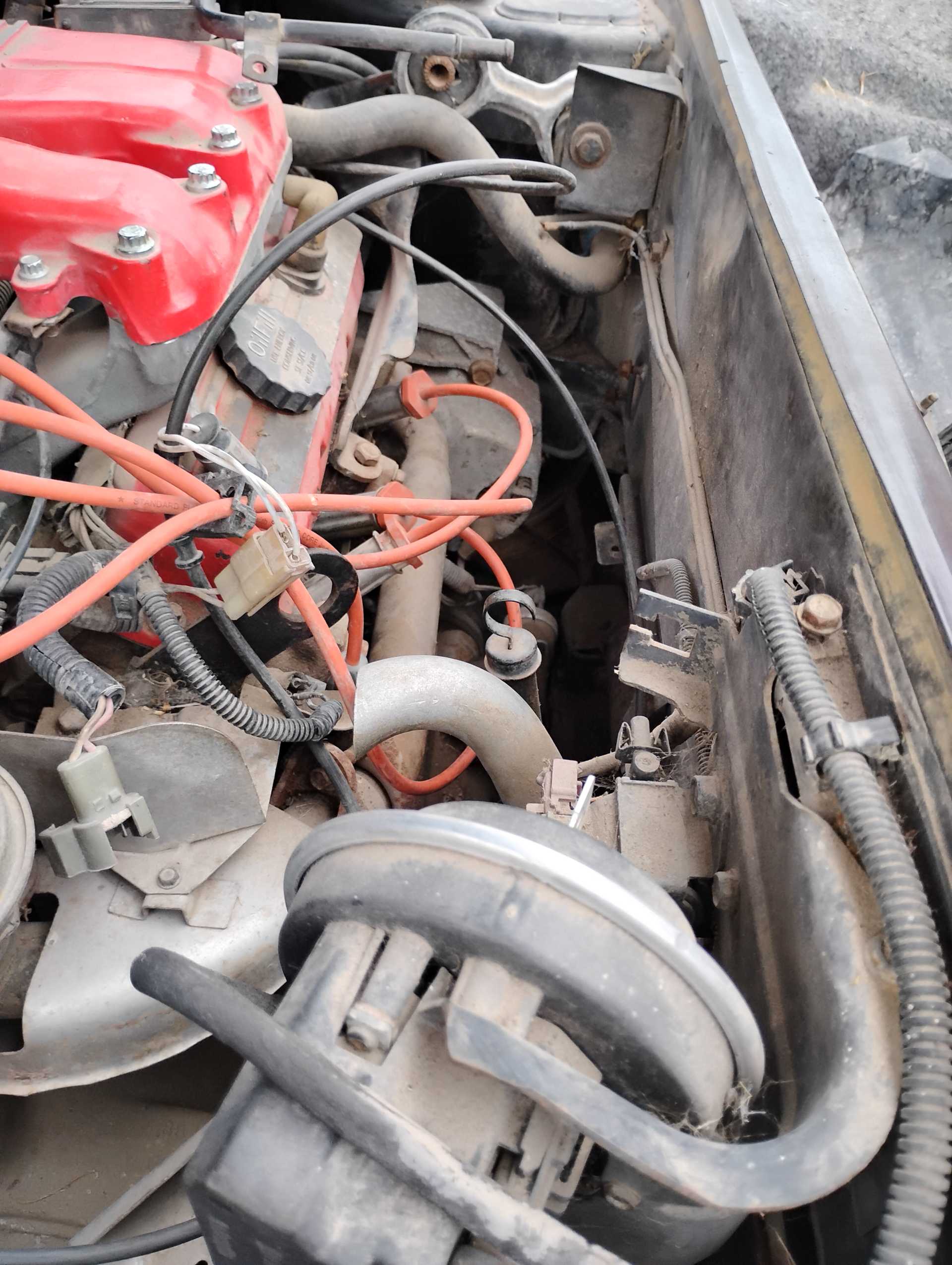

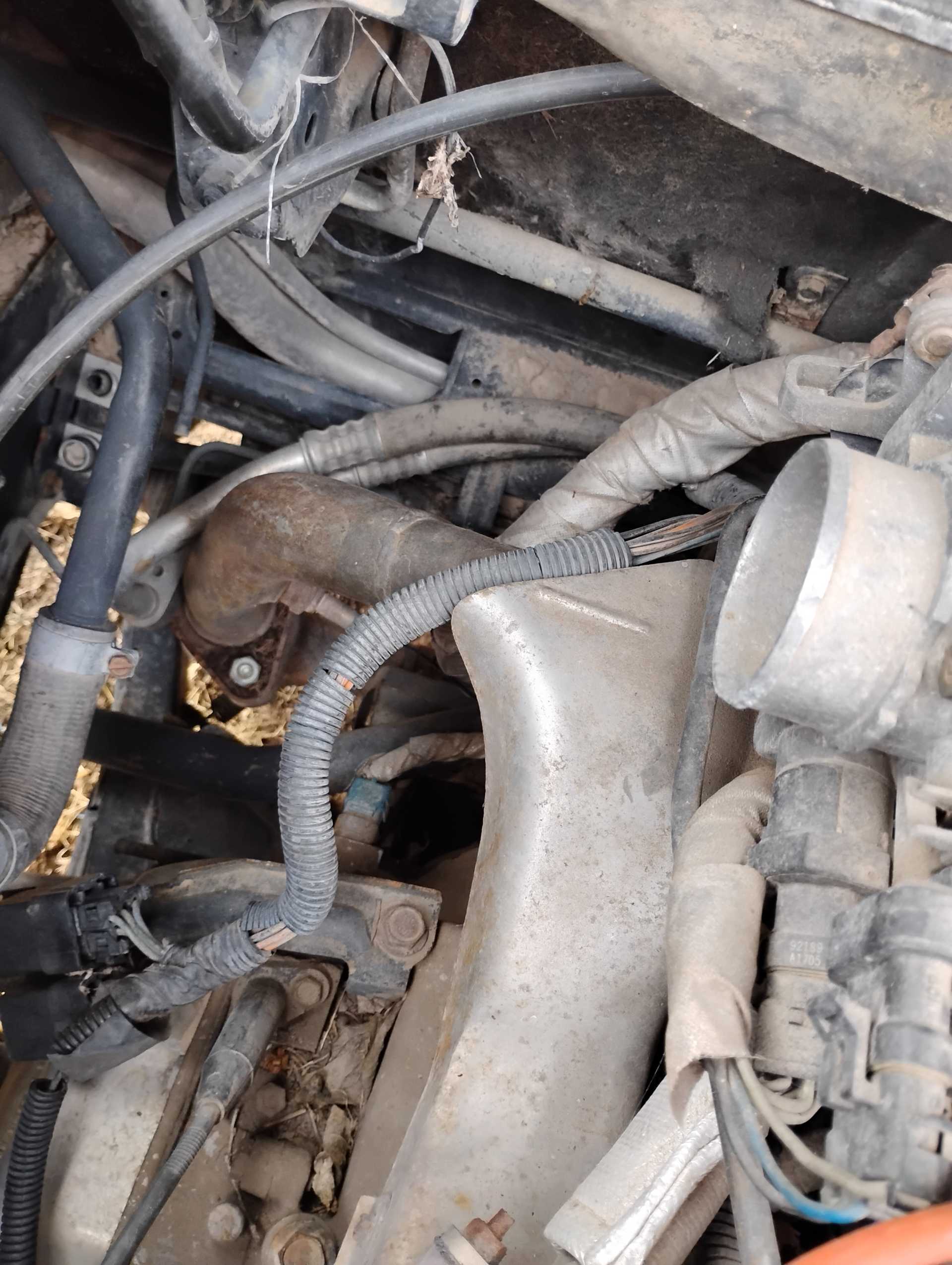

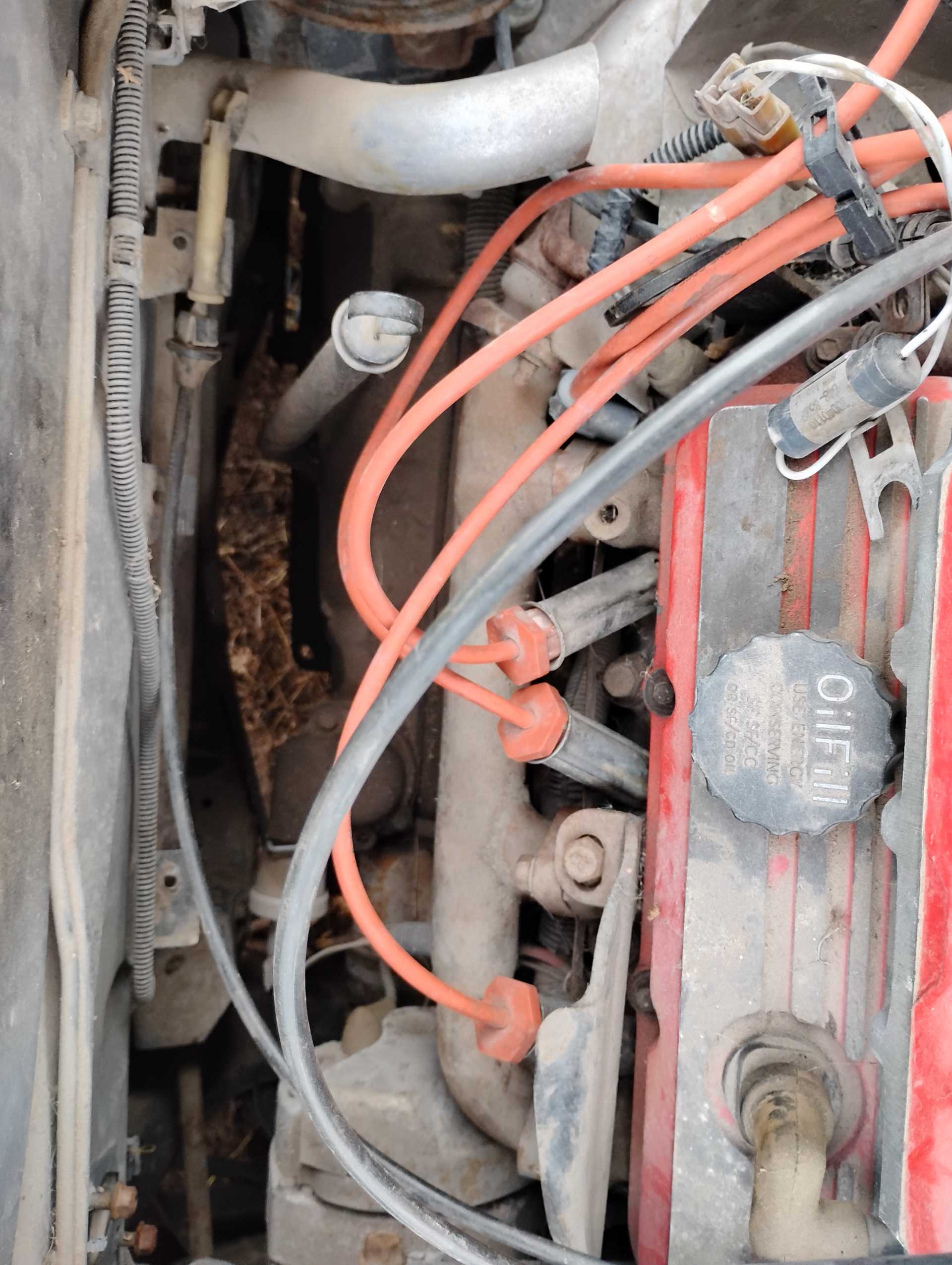

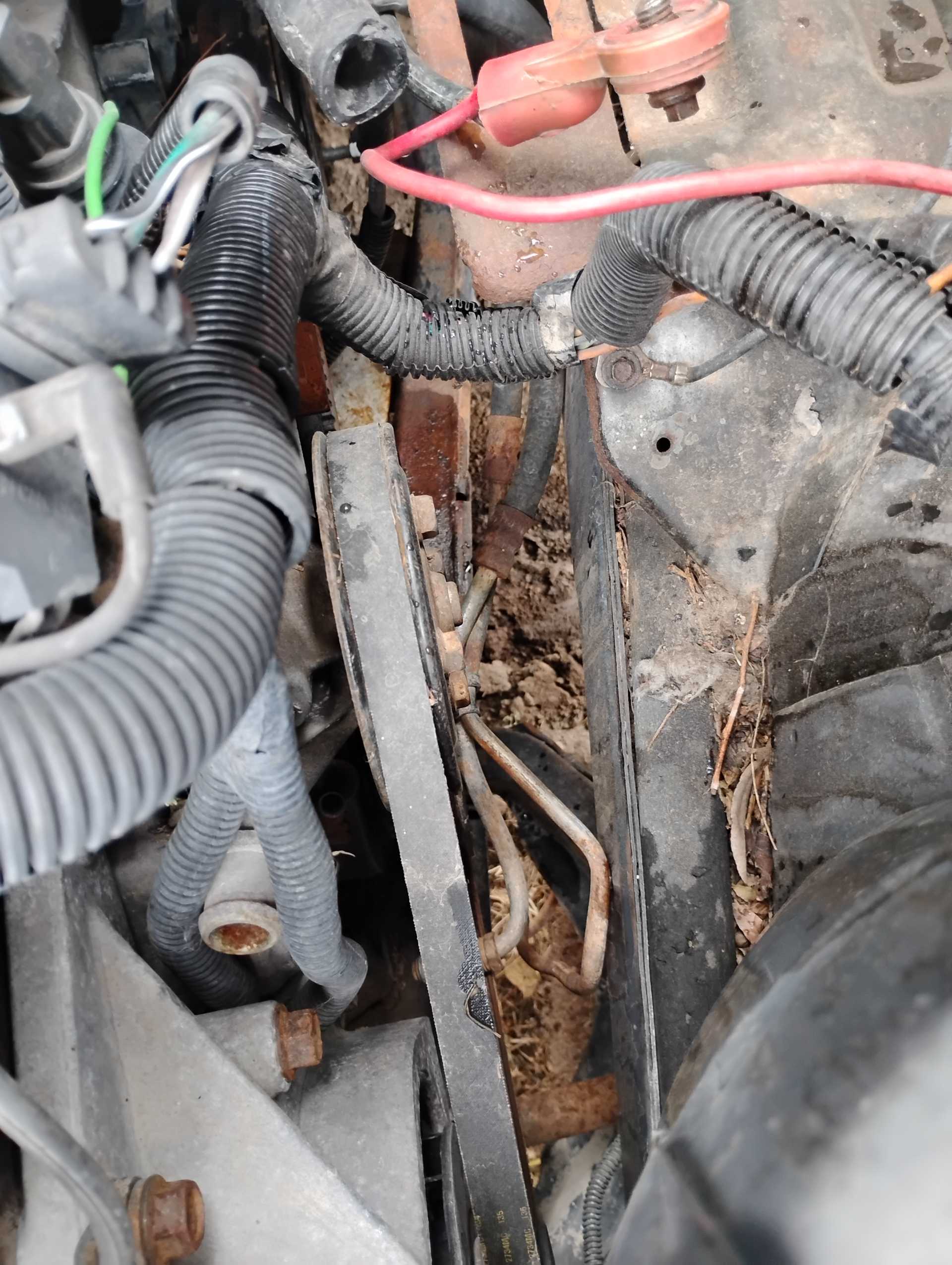

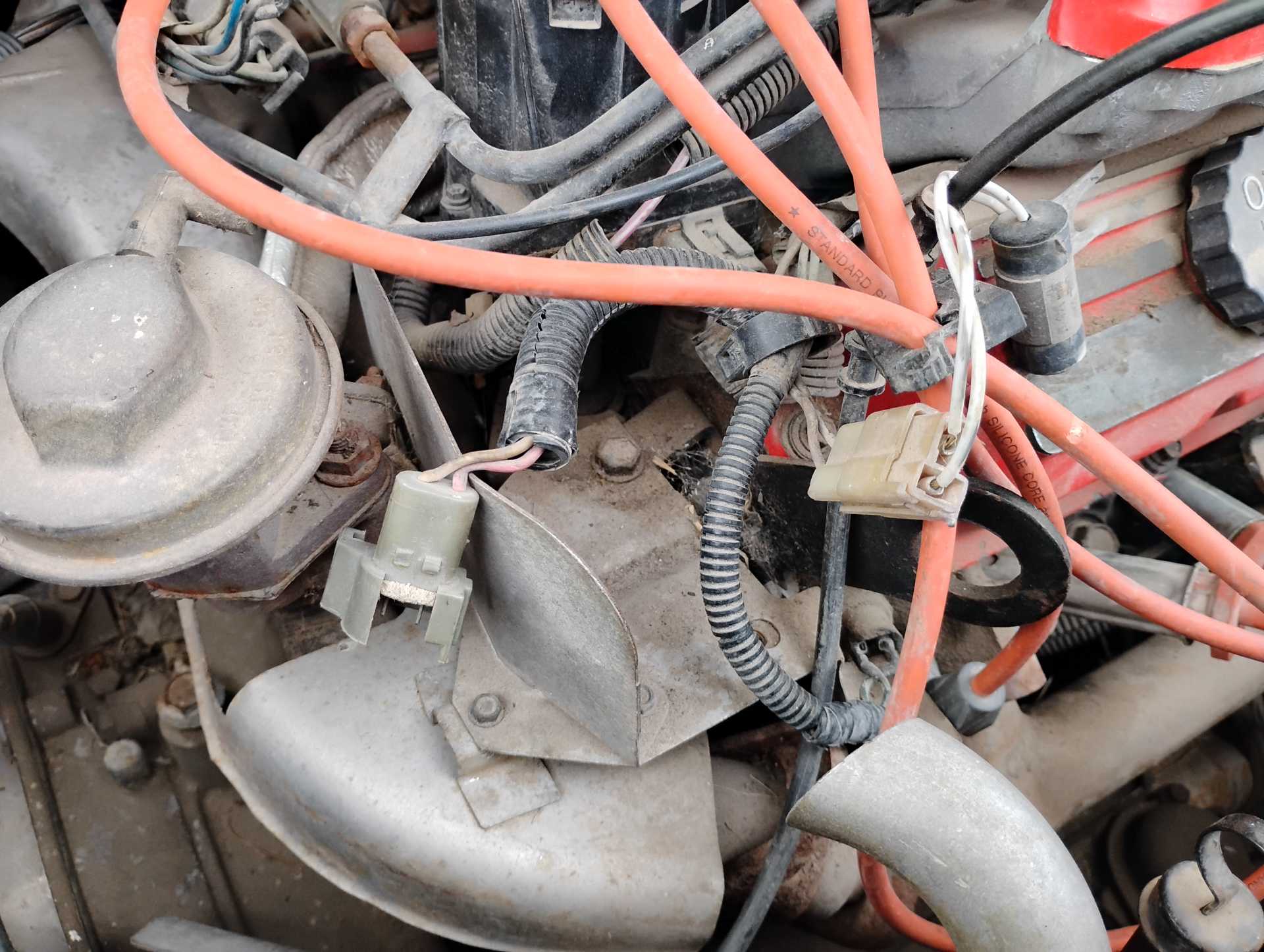

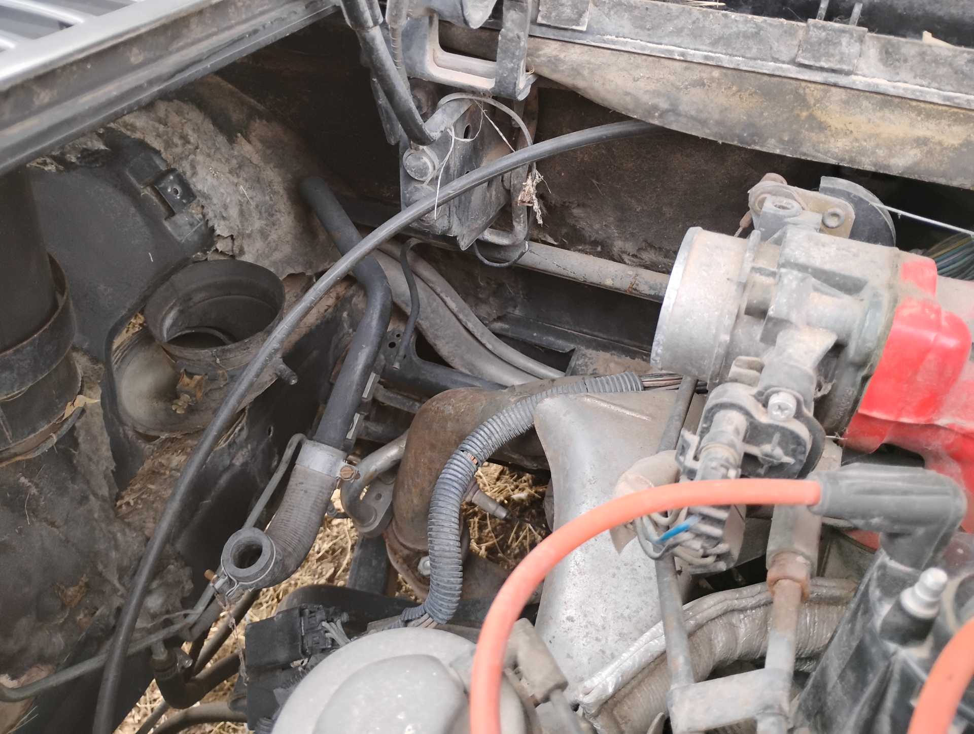

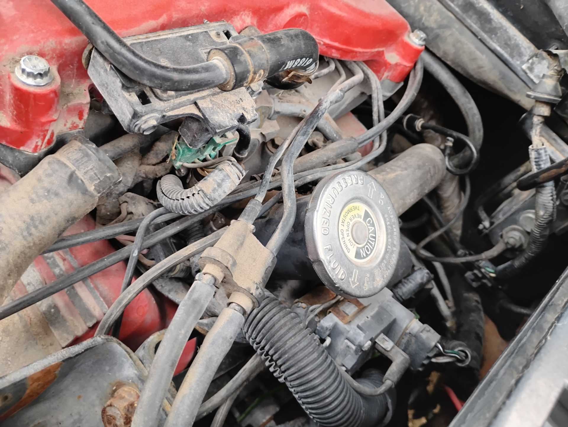

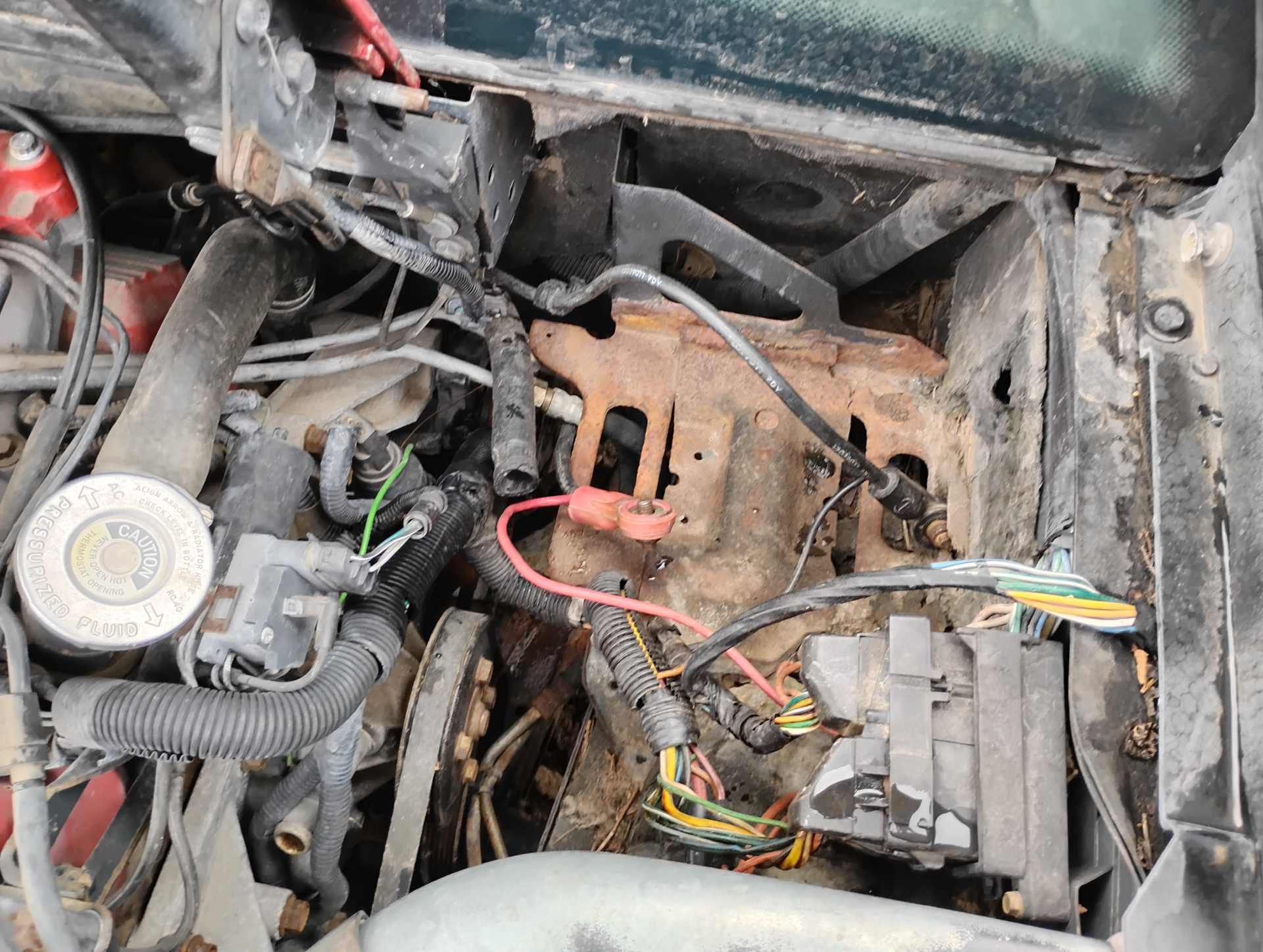

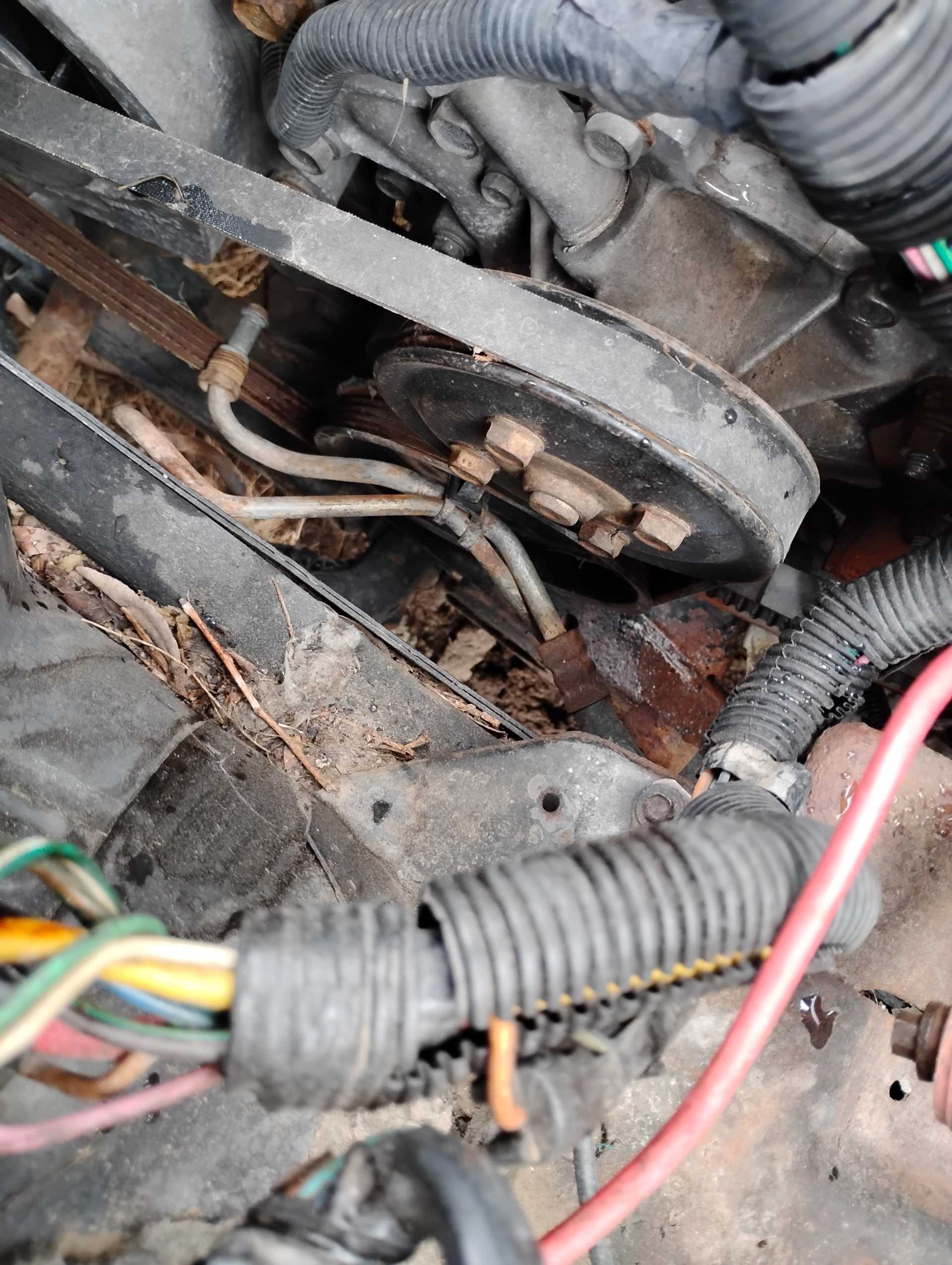

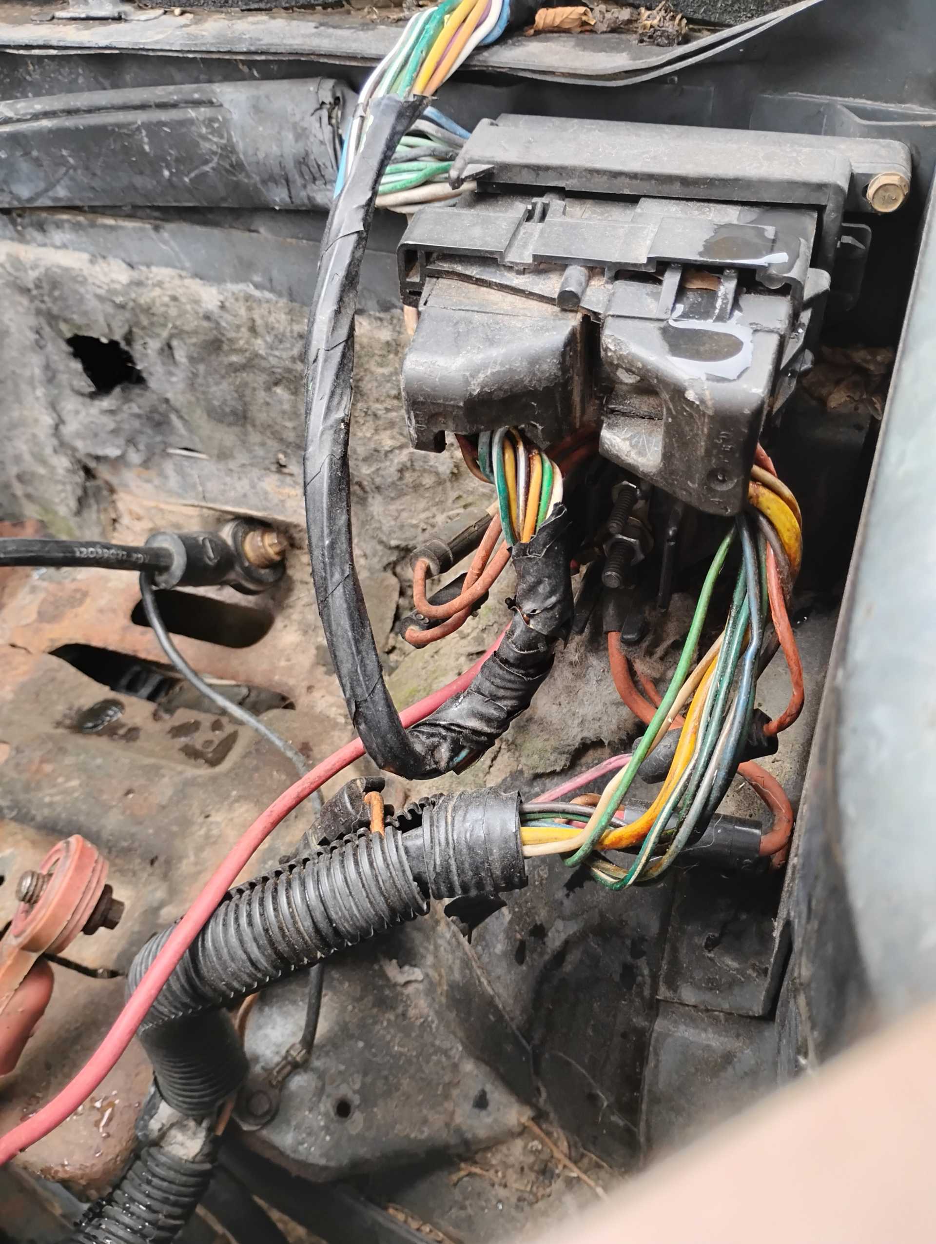

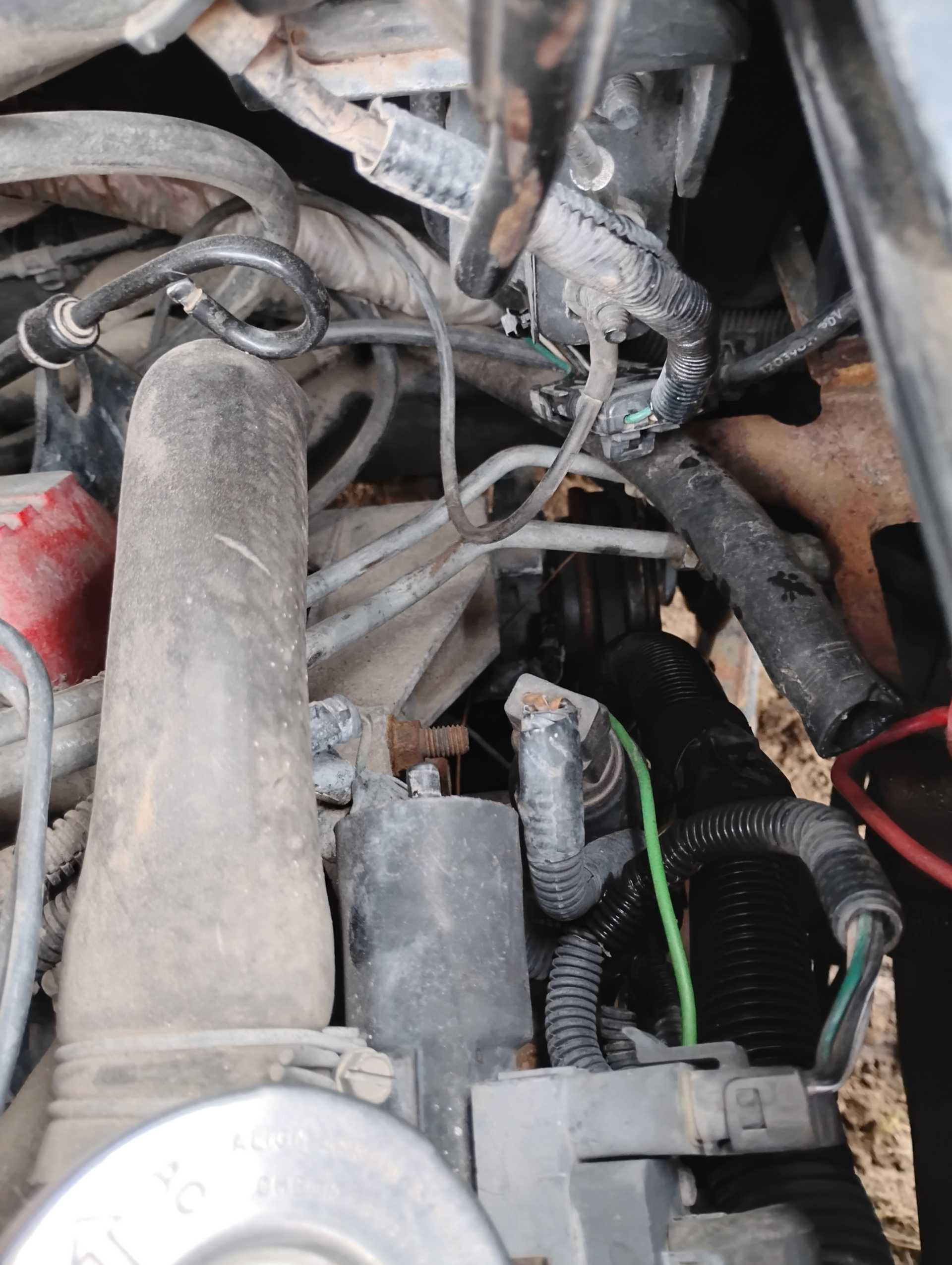

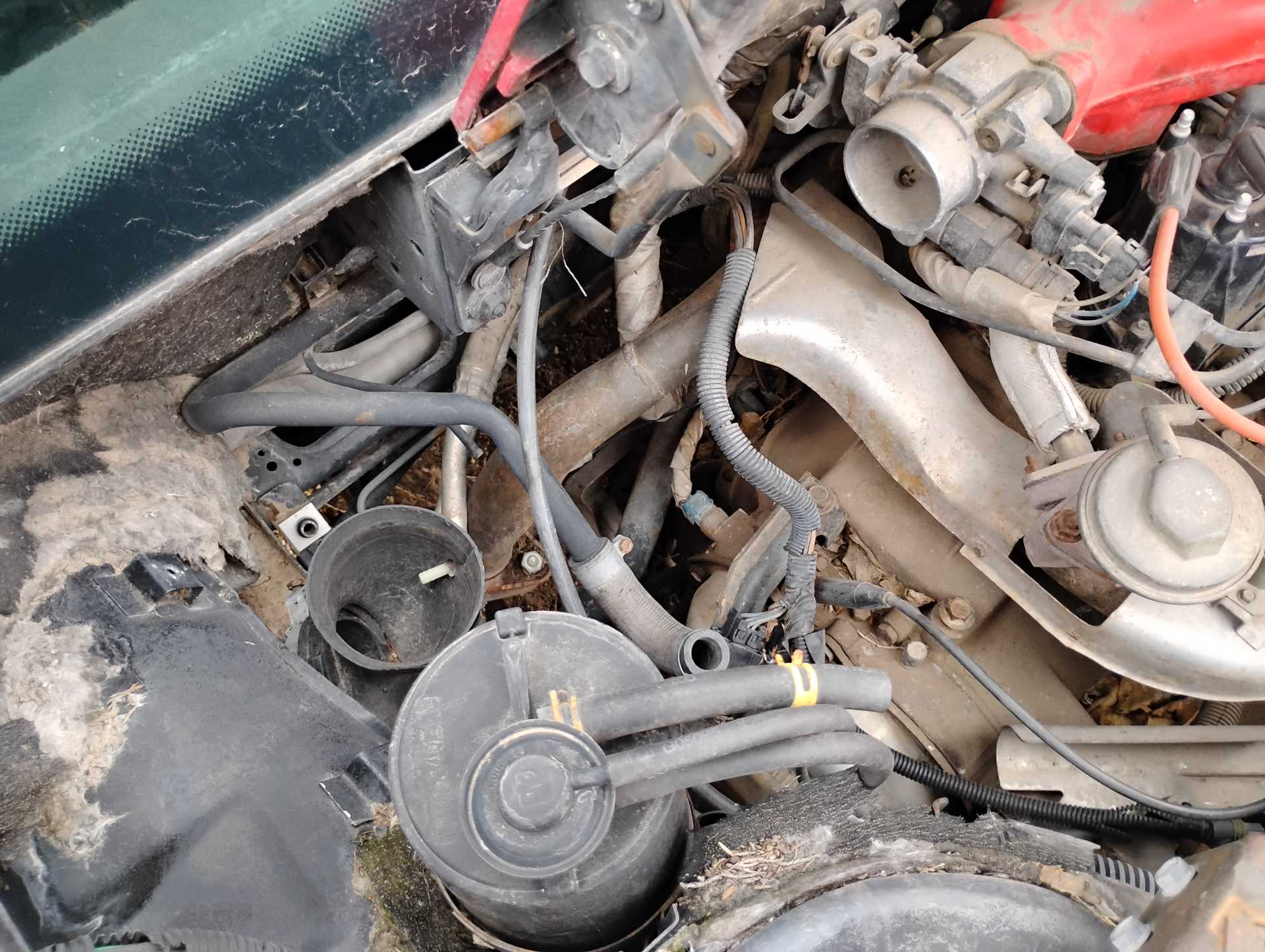

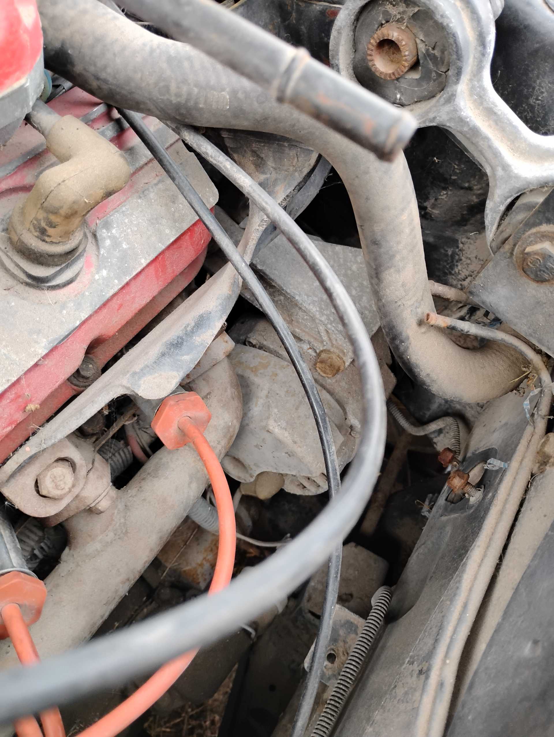

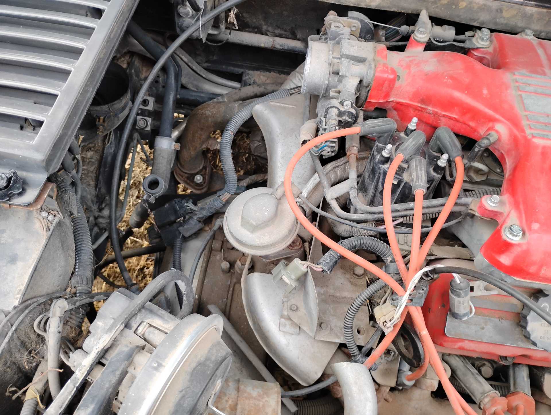

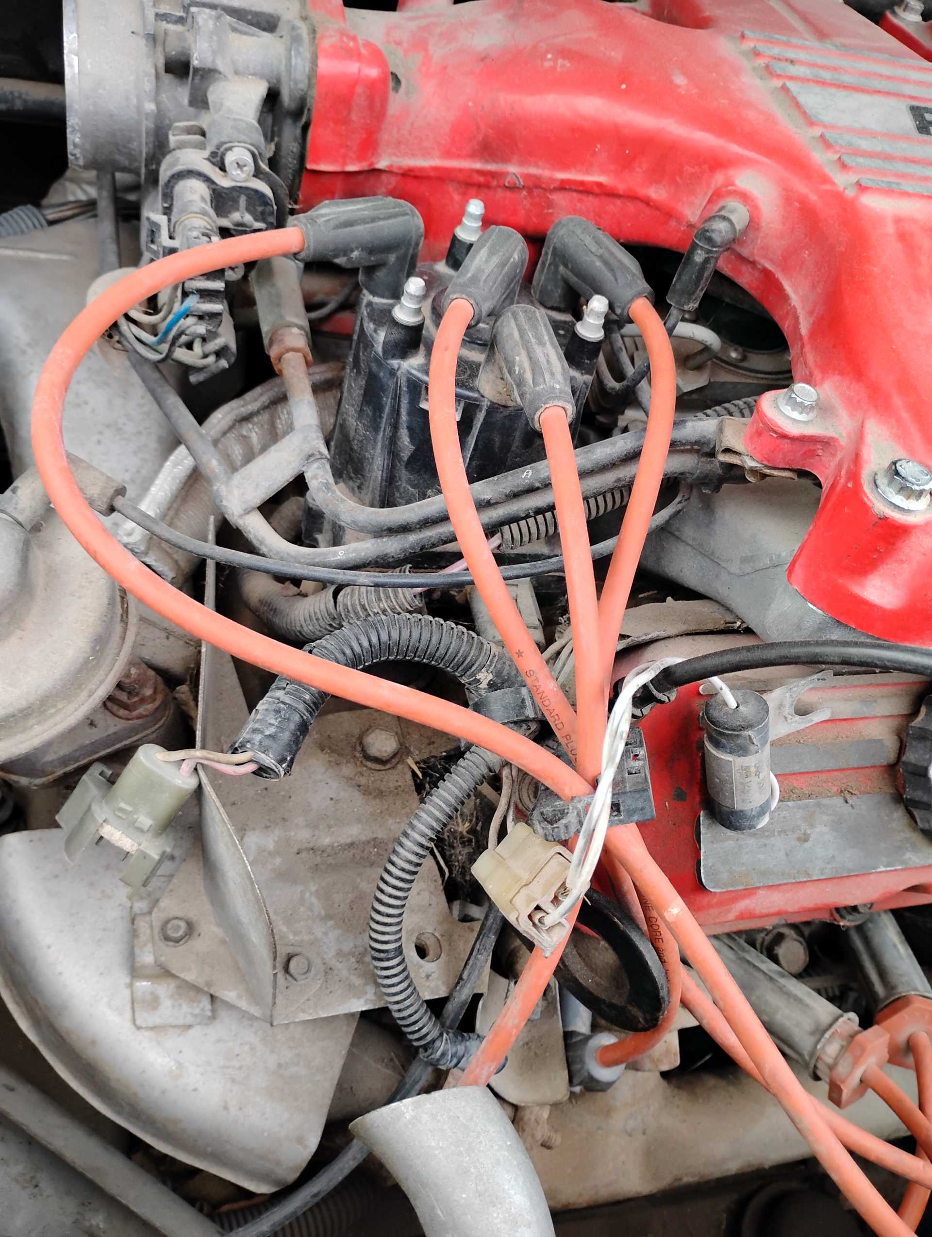

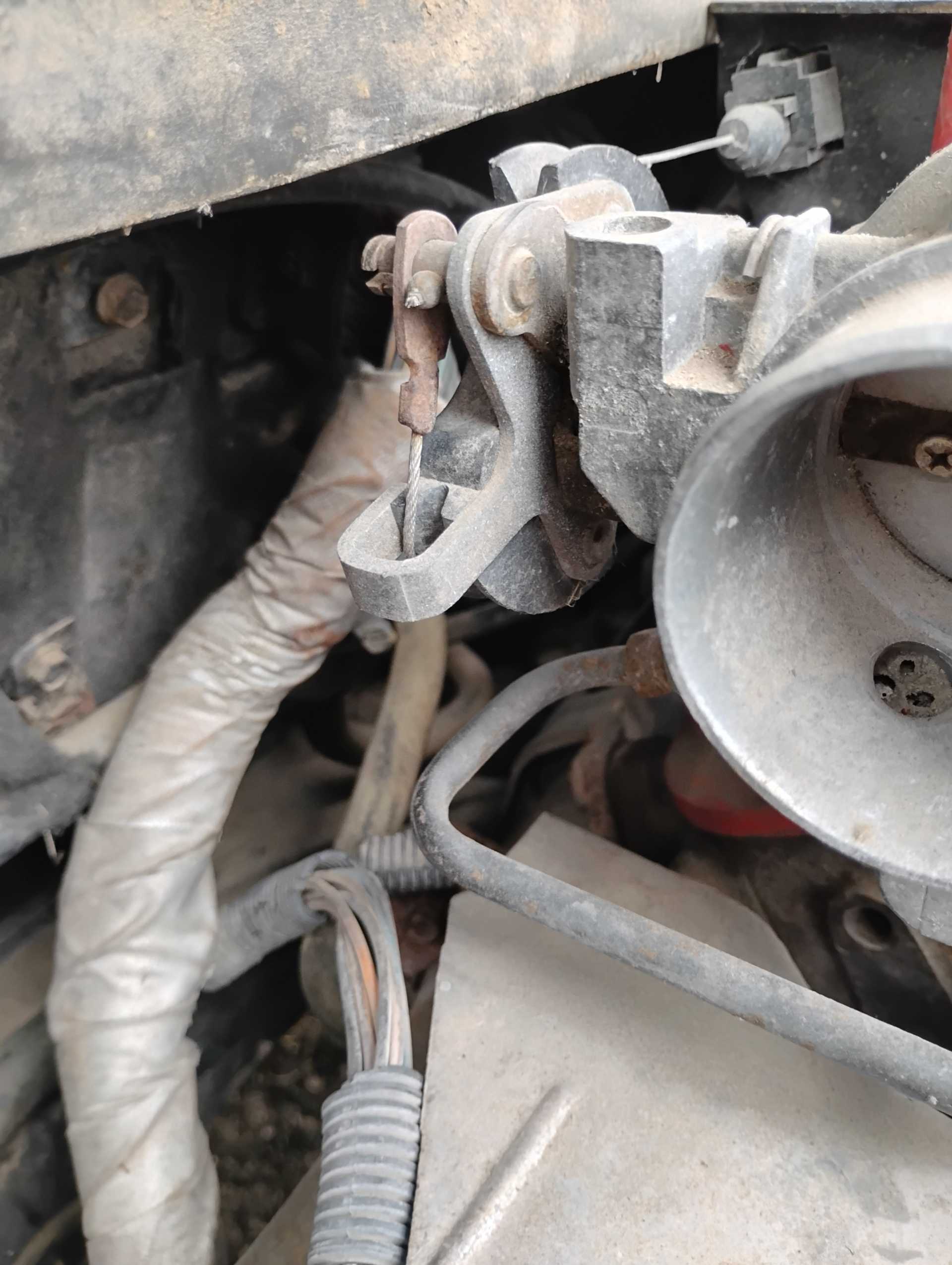

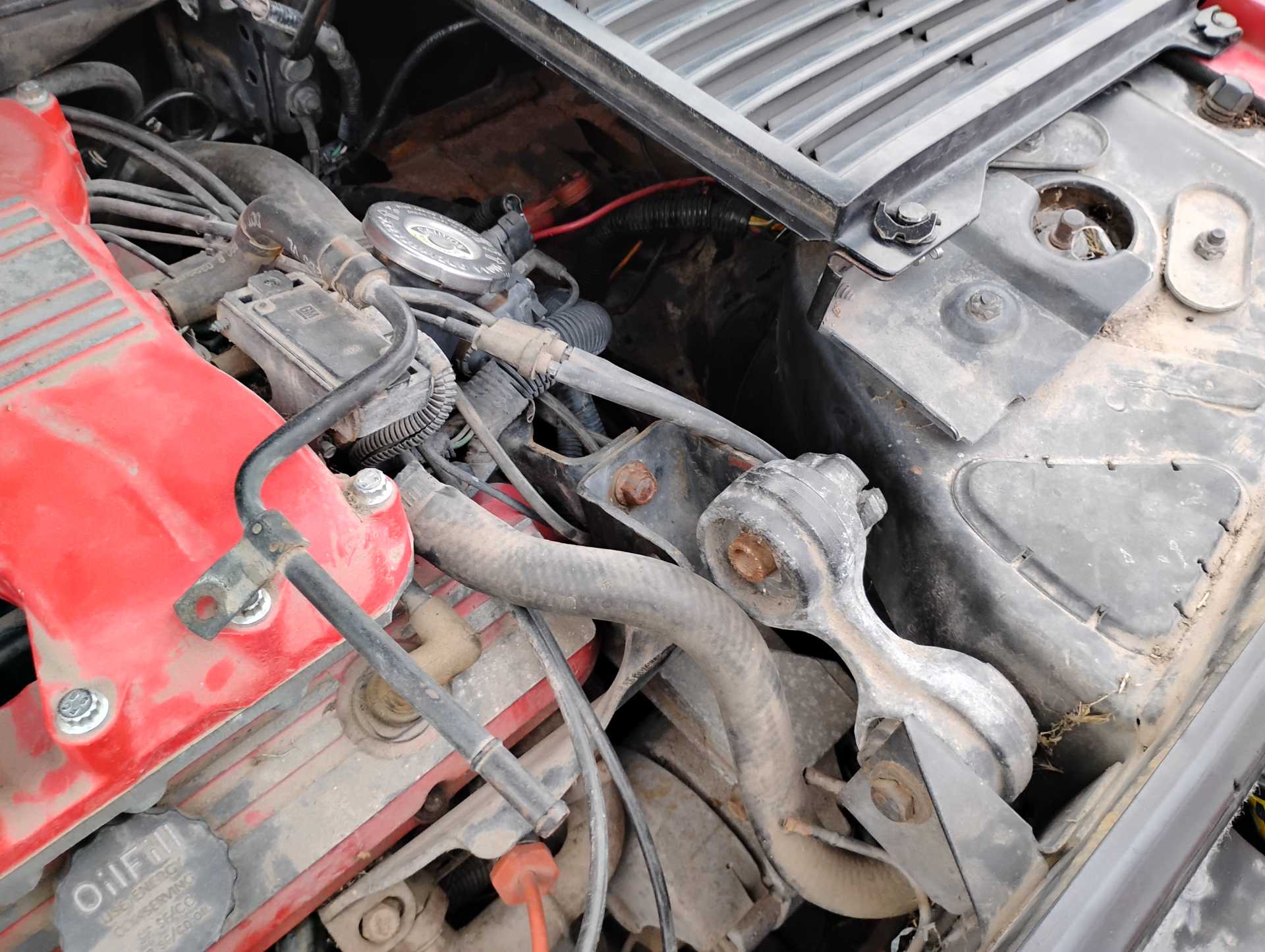

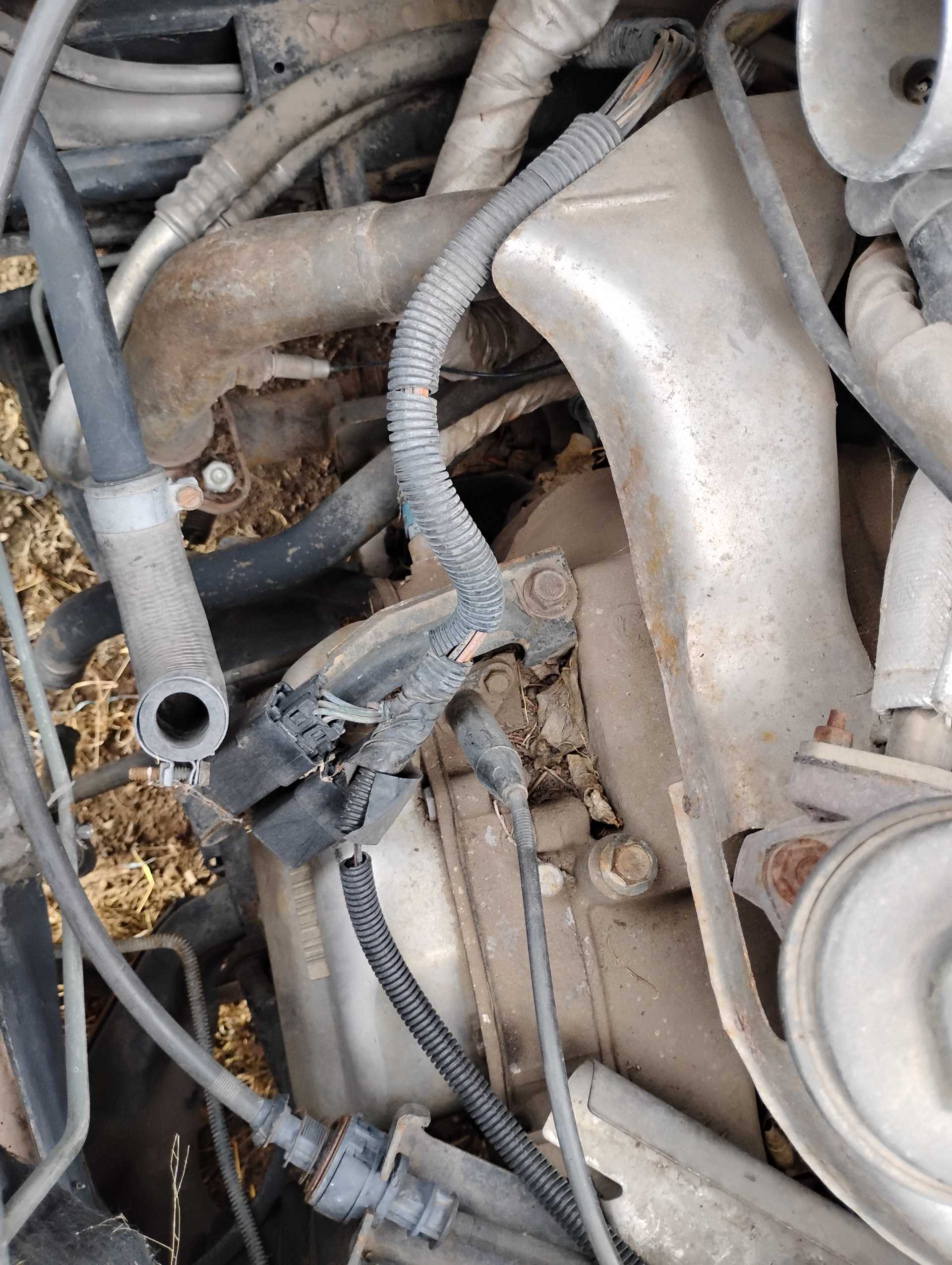

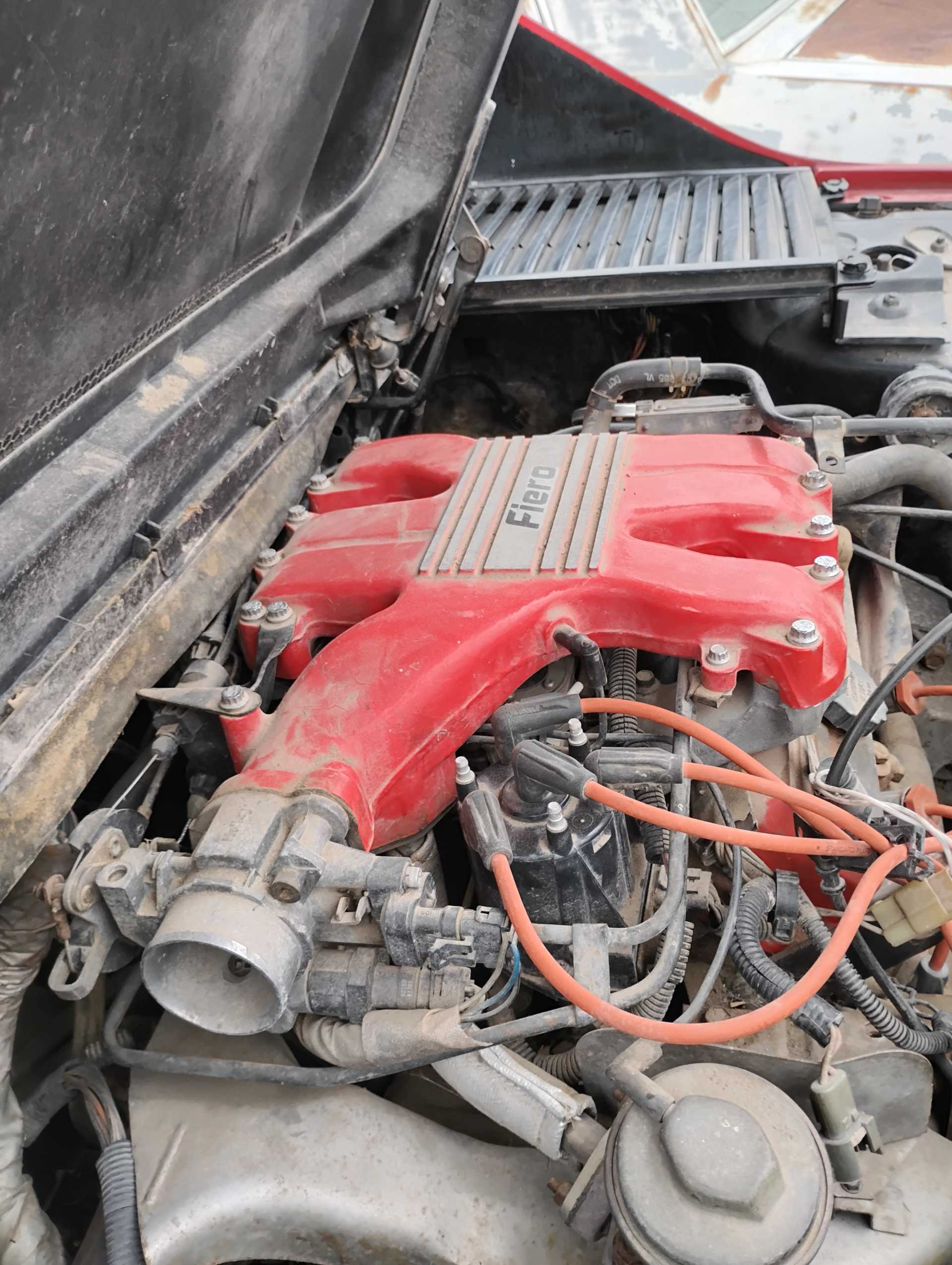

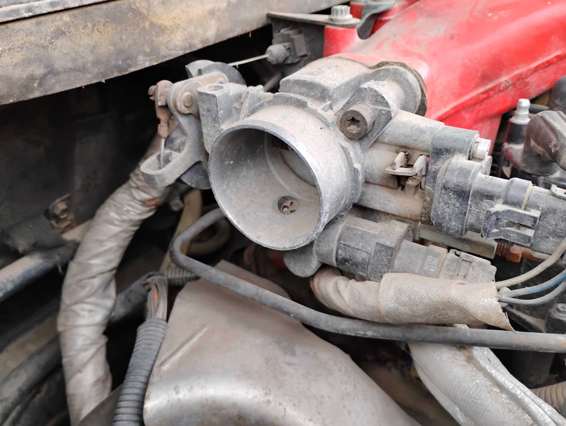

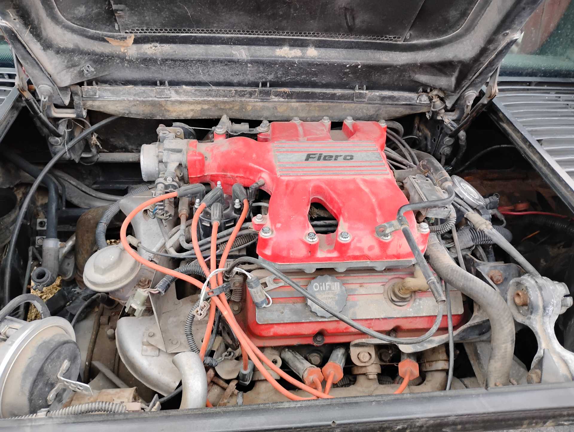

Hello guys so while trying to get a part for my car a guy named cartercarbaficionado said I should send you guys some photos of my engine. This is so you guys could try to help me find any problems within the photos. I have gathered a few photos of many angles and in spots where it seems either something is broken or missing. If you guys do need more photos or of a specific spot just let me know. Thank you guys for helping me out with the electric problems but now I need to get my engine running. I appreciate all of the help.

You definitely have several broken/missing exhaust manifold bolts, not the most critical, but will be noisy.
your fuel lines are disconnected and hanging in the belt area (picture 15), they will spray gas all over if you turn the key on with an ECM and good fuses. They go into the fuel rail under the upper manifold (red thing that says Fiero).
Your ignition coil is missing.
Air filter housing and rubber tube connecting it to the throttle body is missing.
Throttle cable is not currently in its track on the throttle body (manually open the throttle, realign the now loose cable on the guide on the throttle body, close the throttle again)[This message has been edited by 1985 Fiero GT (edited 12-23-2025).]
fieroguru
DEC 23, 07:10 AM
Missing air filter housing Missing air filter to throttle body hose Missing A/C hoses A/C & Fuel Pump Relay harness not attached to firewall Missing vac lines to charcoal canister at canister end Missing cruise cable (I think it is the one in the wrong position & hanging down on the throttle body) Missing ignition coil Mud Dauber in IAC port Missing 3 spark plugs wires TPS lever looks like it is in the wrong position TV cable is not routed properly Air tubes for coil and alternator missing Missing vac lines to charcoal canister at intake end Missing/broken exhaust manifold bolts Dogbone disconnected Heater hose to water pump disconnected and hose looks to be too short Missing battery Fuel lines to filter and tank disconnected and in wrong position
This is what I have so far, but ran out to time to play...
DEC 23, 08:05 AM
Fieroguru hit the nail on the head. Looks like a big project ahead. The first step should probably be replacing the coil, ignition wires, distributor cap/rotor and reconnecting the fuel and vacuum lines.. Everything must be routed and connected properly. Much work and some parts will be needed to get that engine started and running. Maybe mostly top side work but there are many areas that need attention. You seem to have acquired this car from a rather poor mechanic (or prior owner) but with time and work most anything can be fixed. The repairs can be made with new or if on a low budget, good used parts. You will need a repair manual that will instruct you on how to connect and test everything. Many of us here have started with "project cars" so the info here is usually very helpful. Good luck on the project.
------------------ " THE BLACK PARALYZER" -87GT 3800SC Series III engine, custom ZZP /Frozen Boost Intercooler setup, 3.4" Pulley, Northstar TB, LS1 MAF, 3" Spintech/Hedman Exhaust, P-log Manifold, Autolite 104's, MSD wires, Custom CAI, 4T65eHD w. custom axles, Champion Radiator, S10 Brake Booster, HP Tuners VCM Suite. "THE COLUSSUS" 87GT - ALL OUT 3.4L Turbocharged engine, Garrett Hybrid Turbo, MSD ign., modified TH125H " ON THE LOOSE WITHOUT THE JUICE " [This message has been edited by Dennis LaGrua (edited 12-23-2025).]
DEC 23, 08:09 AM
| quote | Originally posted by fieroguru:
For sure... take care of this one first. You should not be trying to start the engine without the cooling system hooked up and properly connected. You'll get the engine running and then within a minute destroy your engine from overheating.
