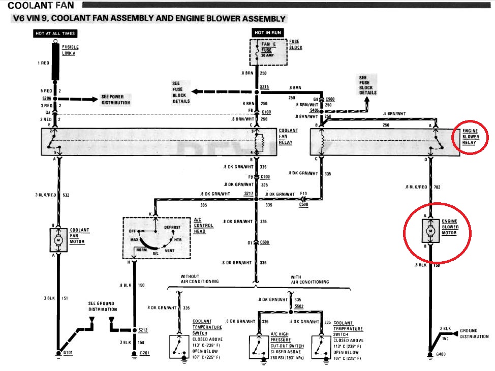

BTW - The '85-'87 Pontiac Fiero Service Manual calls it as "Engine Blower Motor and Relay"
If you have a PFSM, the motor and the relay is shown in Section 8A - 201 - 9 / Figure C
'85-'87 Fan / Blower Circuit
