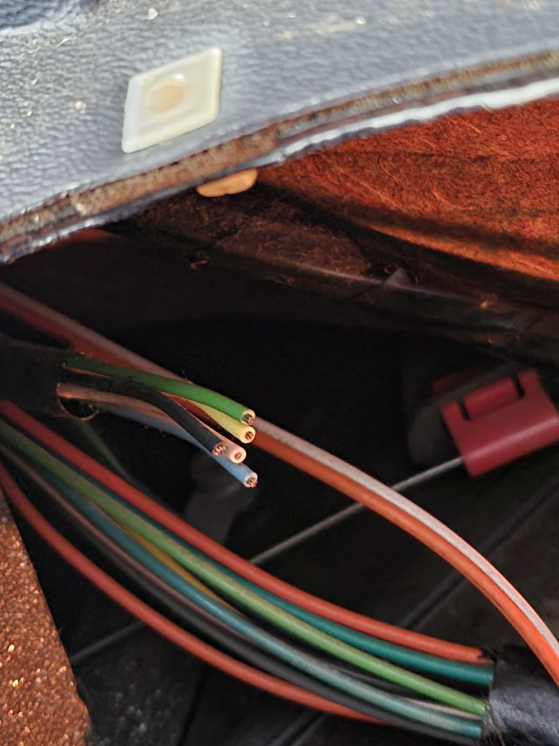

 Was replacing my front speakers and under the passenger side dash near the middle I saw this bundle of cut wires. Are these just due to different option wiring or something else? Nothing seems to be not working so I dont know

those shouldnt be cut.... i cant tell what that went to originally... could you share another picture of you entire interior? i want to see if theres any other remnants of aftermarket mods

i might be able to get back into this weekend, this is an 84 ac car. nothing seems to be non functional, the hvac controls work, the stereo wiring all works. only electrical issues i have are fuel guage doesnt work and radiator fan doesnt work.

maybe someone took out the subwoofer.

Power mirror passenger side? Mine doesn't have the black 5th wire just the other four.

might be it... i will have to check but i dont remember the mirrors working now that you mention it.... i wonder why someone would cut those if thats the case...

does the ac being turned on make the rad fan spin?
