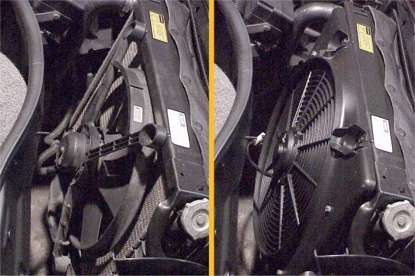

https://www.fiero.nl/forum/Forum2/HTML/145857.html
proform 67016 seems to be the choice
if you dont have a shroud i believe a few toyota trucks and cars have ones close enough, i know a few 90s gm cars like grand prix/am and the caddilacs have them but the shroud may need to be cut in half for the fieros radiator width and then have the end sealed up
You know, if i'm looking at this image... it almost looks like you could remove the factory fan, and actually modify the shroud to accept the new Proform fan?

Yup, some trimming of the mounting bosses on the aftermarket fan, removing the mounting bars on the OEM fan and six rivets and you're good to go with a 16" fan.

Another vote for the 67016.
Only down side is that it's loud...
