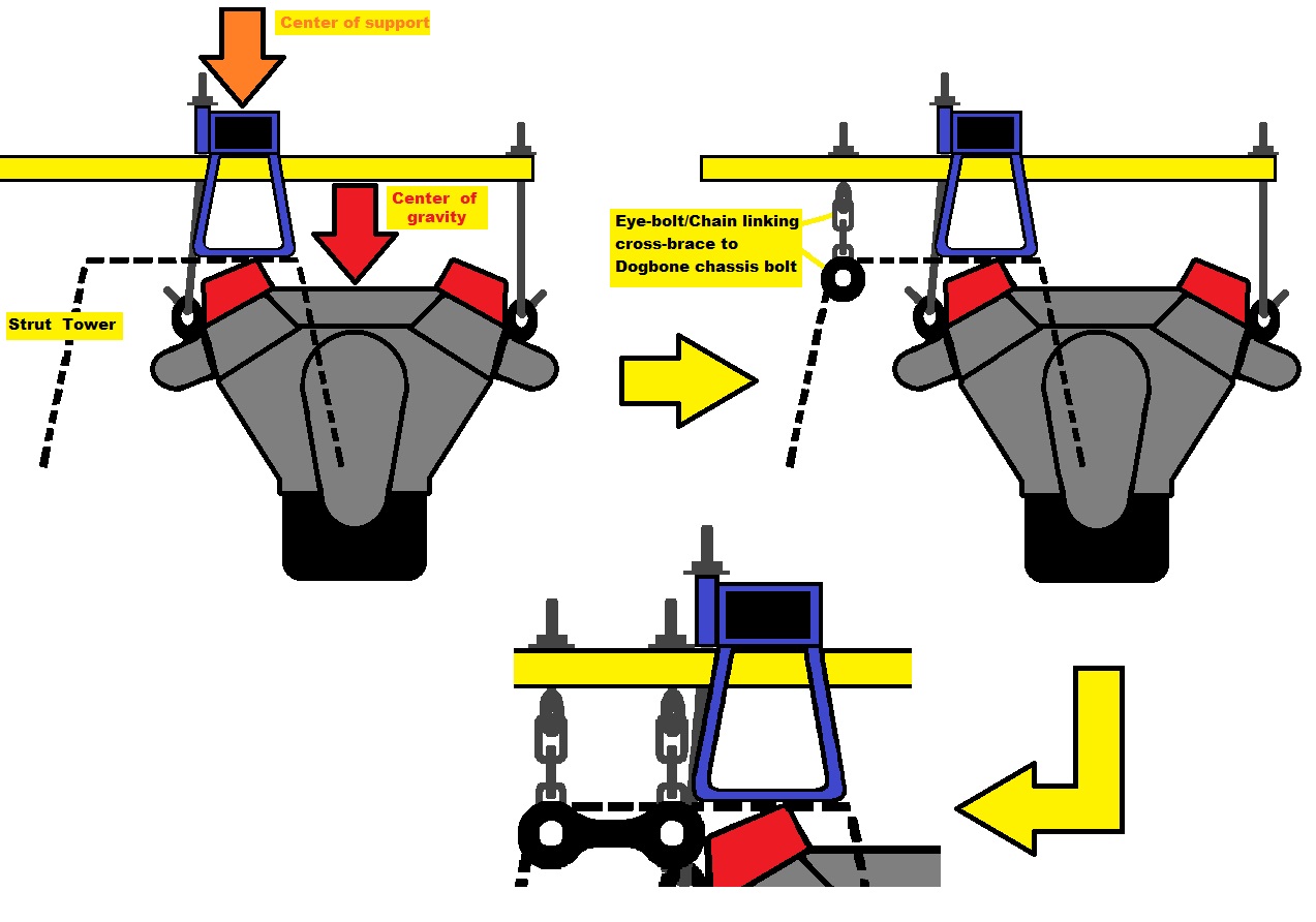

cvxjet DEC 03, 06:24 PM
I have changed transmissions and clutches , and also swapped out cradle using an engine support...they can be unstable, if used improperly, so I did some mods and added some stuff....Here are some pics and diagrams;
