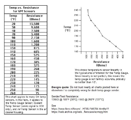

hm yeah sounds like you got a hvac wiring issue if you can disconnect the fan switch at the engine unless there is a short to ground somewhere like mine was honestly i would ohm out your temp sensor and see what happens
