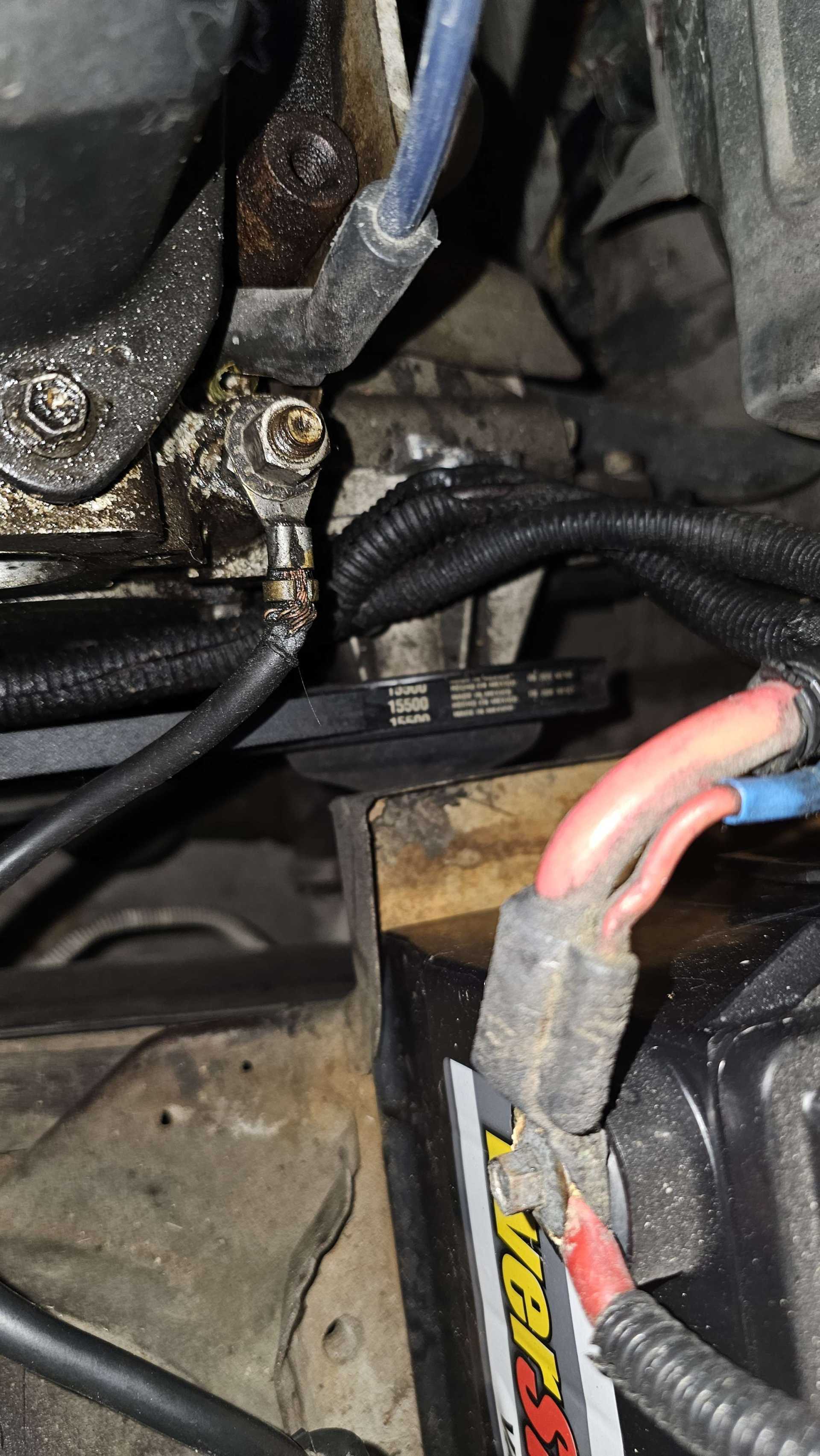

found some of it? shorted together map wires under the loom near the egr and how much continuity are the tps wires supposed to have to ground? i assume 0 but im not sure

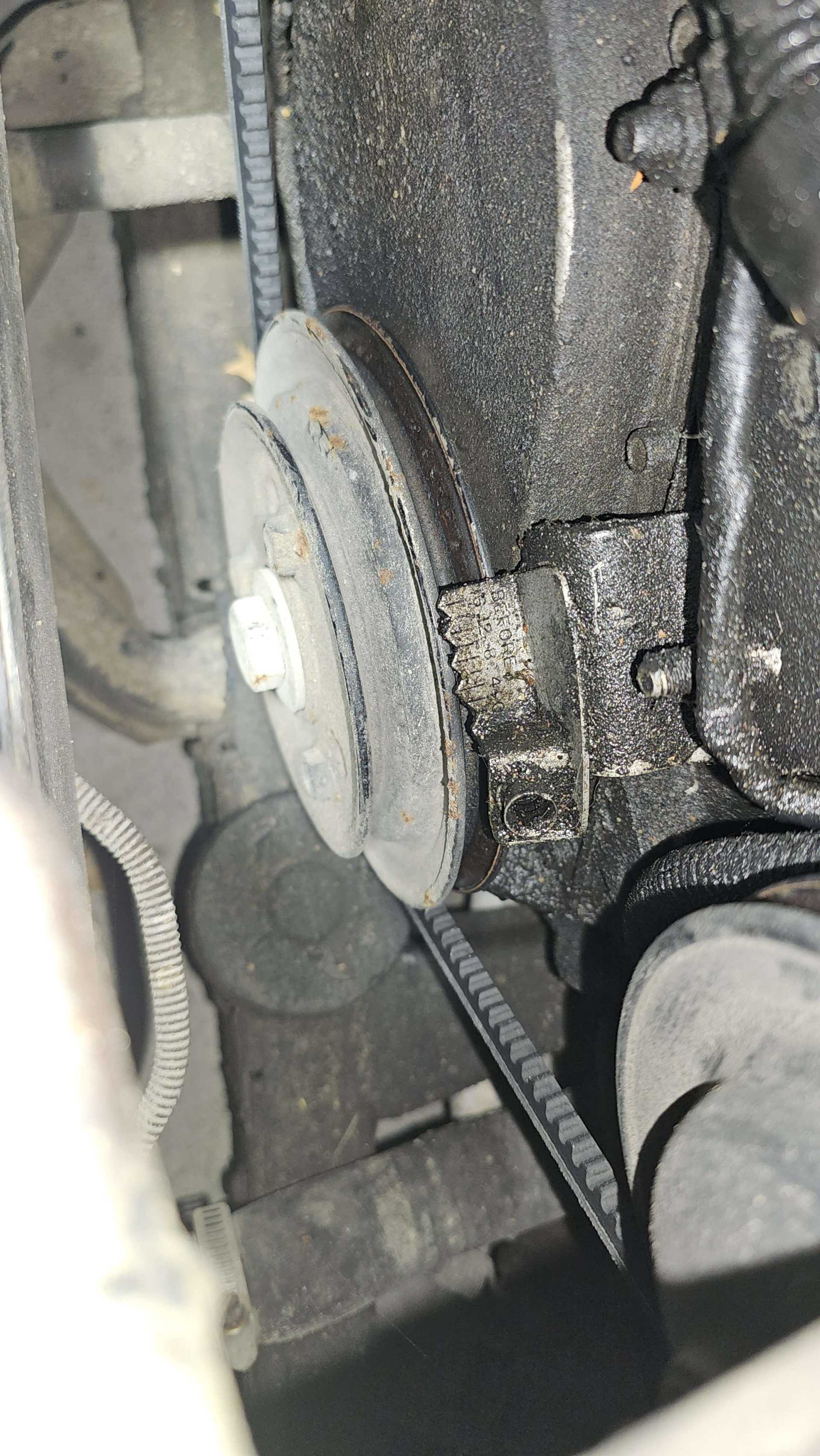

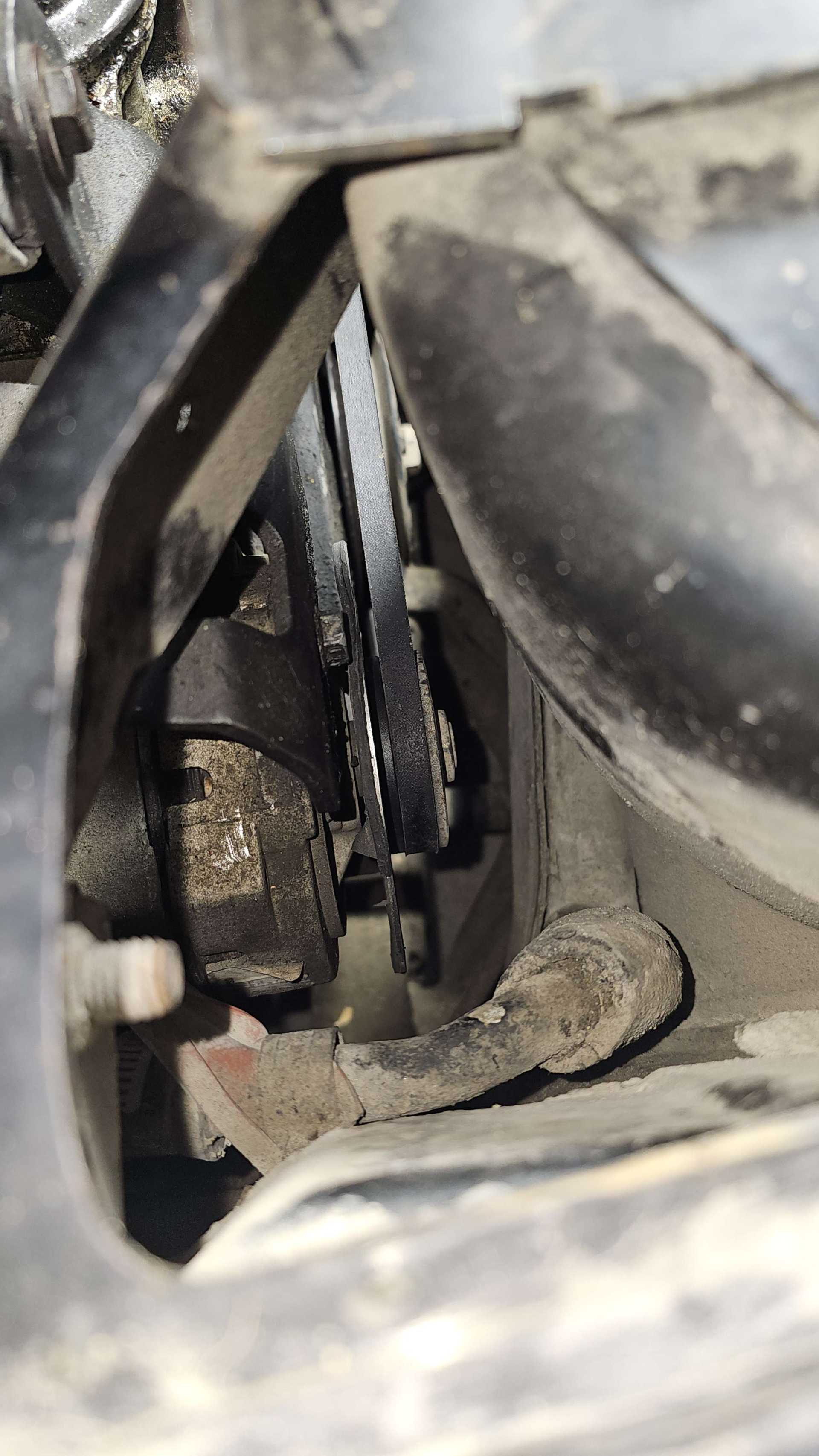

found out part of why the belt explodes at higher rpm. whoever put this engine together for my buddy is gonna get a stern talking to (and possibly have an entire rotisserie chicken thrown at them.) now if i can get the map wires to not be melted on the stupid egr block off plate we might actually get somewhere.
NOV 23, 08:00 PM
The nice thing is I don't see a whole lot of rust... but I do see a lot of oil and grease... man... that's the worst, haha...
That crank pulley looks like it's so very close to the timing cover...

yeah that was kind of a tip off someone did some bad things, the alt fan is shattered and he had no idea since apparantly the last time he posted about anything with it here ogre gave him a real hard time and the car sat since then. its getting fixed and cleaned now and in a few years it will likely get a 3800 swap for usability unless the duke lasts and is generally issue free
