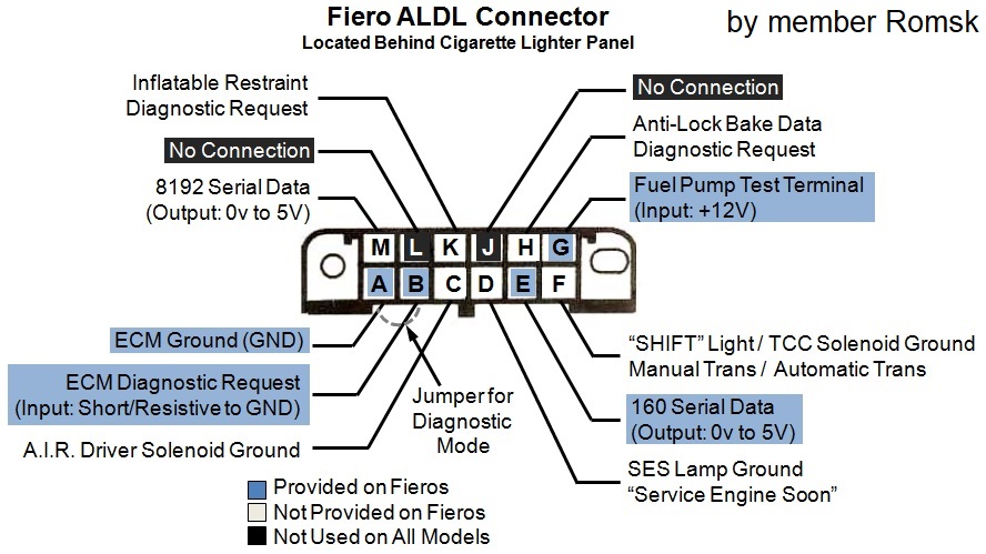

thanks will check those egr lines. i havent pulled codes yet... i saw some way on youtube to jump some connector locations on the ecm and get the blinking codes.. just havent done it yet

Short or 'jump' A to B to get the 'blinking' codes...
ECM Diagnostics (Trouble) Codes
https://www.fiero.nl/cgi-bin/main.cgi?ECMCodes

Did you click on my link? The info there and a reconfigured paper clip will tell you all you need to know.

Raydar NOV 13, 12:48 AM
This picture shows the "conventional" mounting - which is usually under the dash, in most cars.
In the Fiero, the ALDL connector is mounted upside down, on top of the console skeleton (next to the cigarette lighter, behind the black panel.) The A and B pins are the two nearest the passenger side of the car, on the bottom row.
Vintage-Nut NOV 13, 07:27 AM
Yes, that is true...
SO, member Romsk created the 'correct' image for the Fiero ALDL...
Patrick NOV 13, 12:58 PM
The two terminals to be jumpered, A and B, are the only two terminals of the ALDL port side by side that have metal contacts within them. The metal contacts are easily seen, therefore identifying where the jumper goes really isn't that big of a deal.
