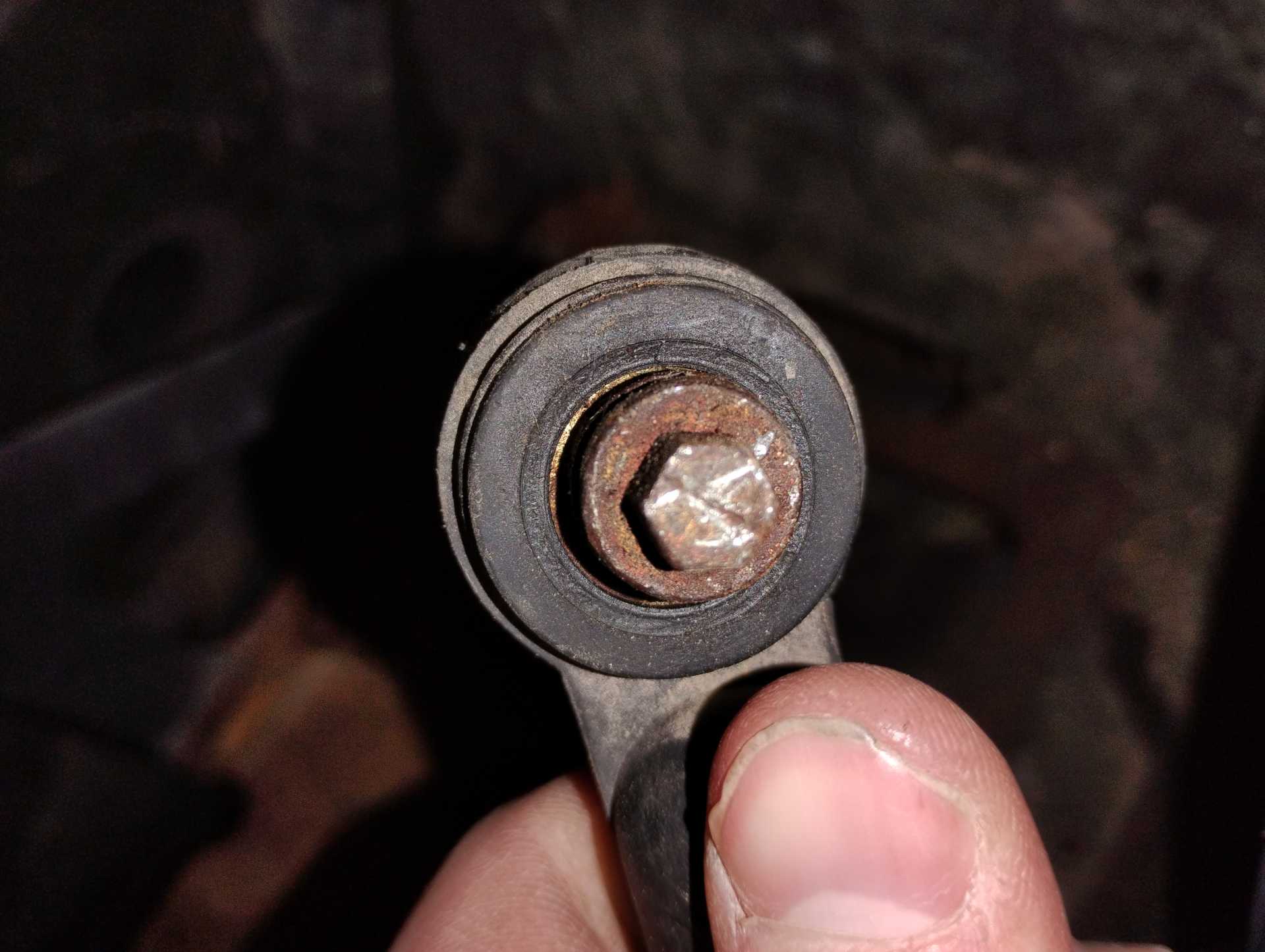

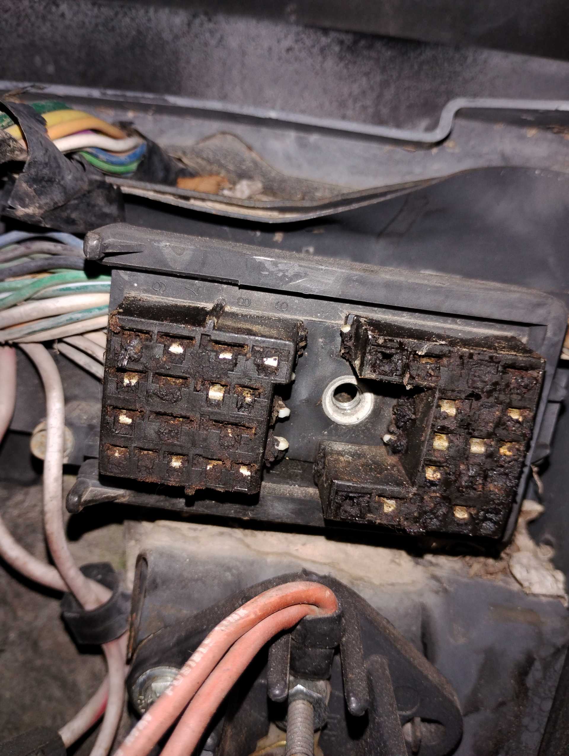

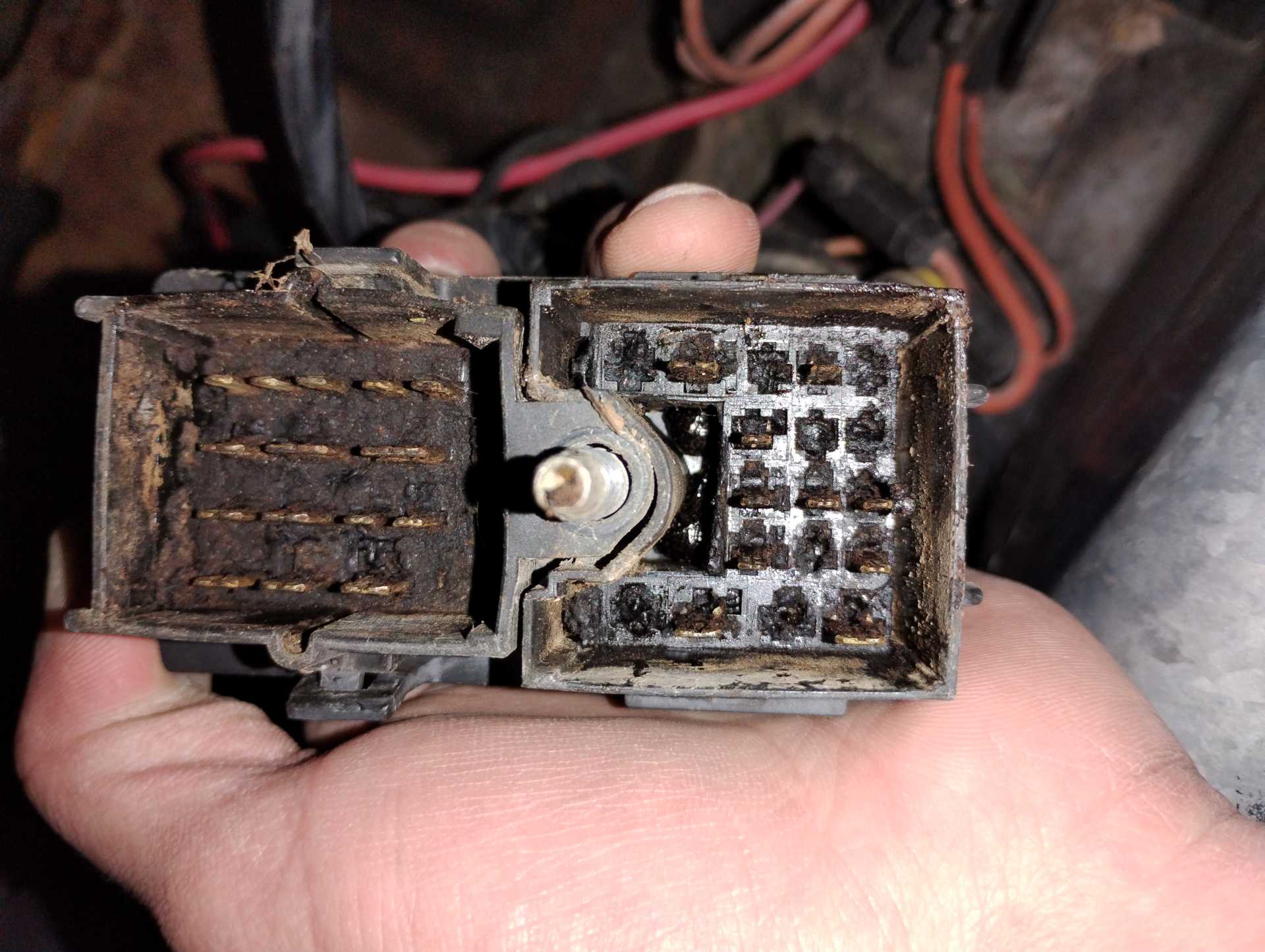

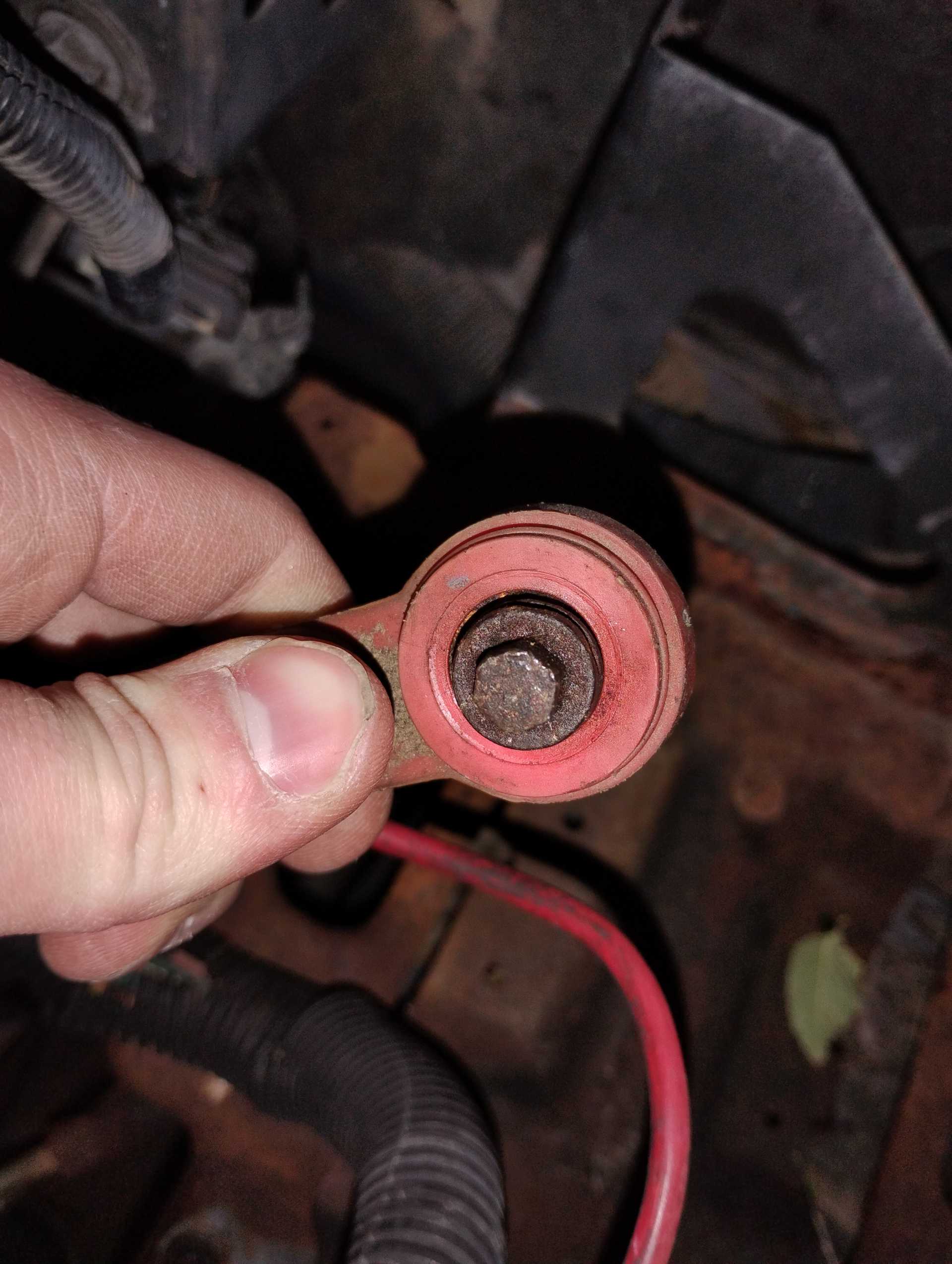

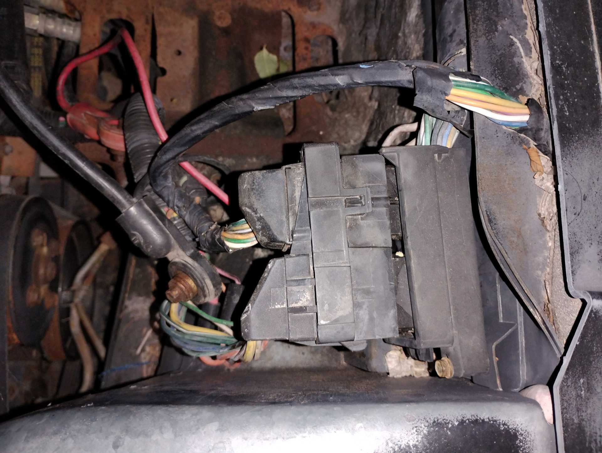

so I got my Fiero as an unfinished project so trying to find the cause of the no power is a lot harder. I have only got power to it once like a month ago when my friend got the hazards stuck and then randomly the hazards started flashing until the battery died a few seconds later.. btw the car literally has no power at all anywhere. I do have some theories tho.
the first 3 photos are this black box thing by the battery. my dad says it is part of the wiring harness. As you can see it seems to be very corroded. Do I need to replace this or can I clean it.
the next 2 photos are the battery cables. they are quite rusty and have some green so it seems to be corroded copper.

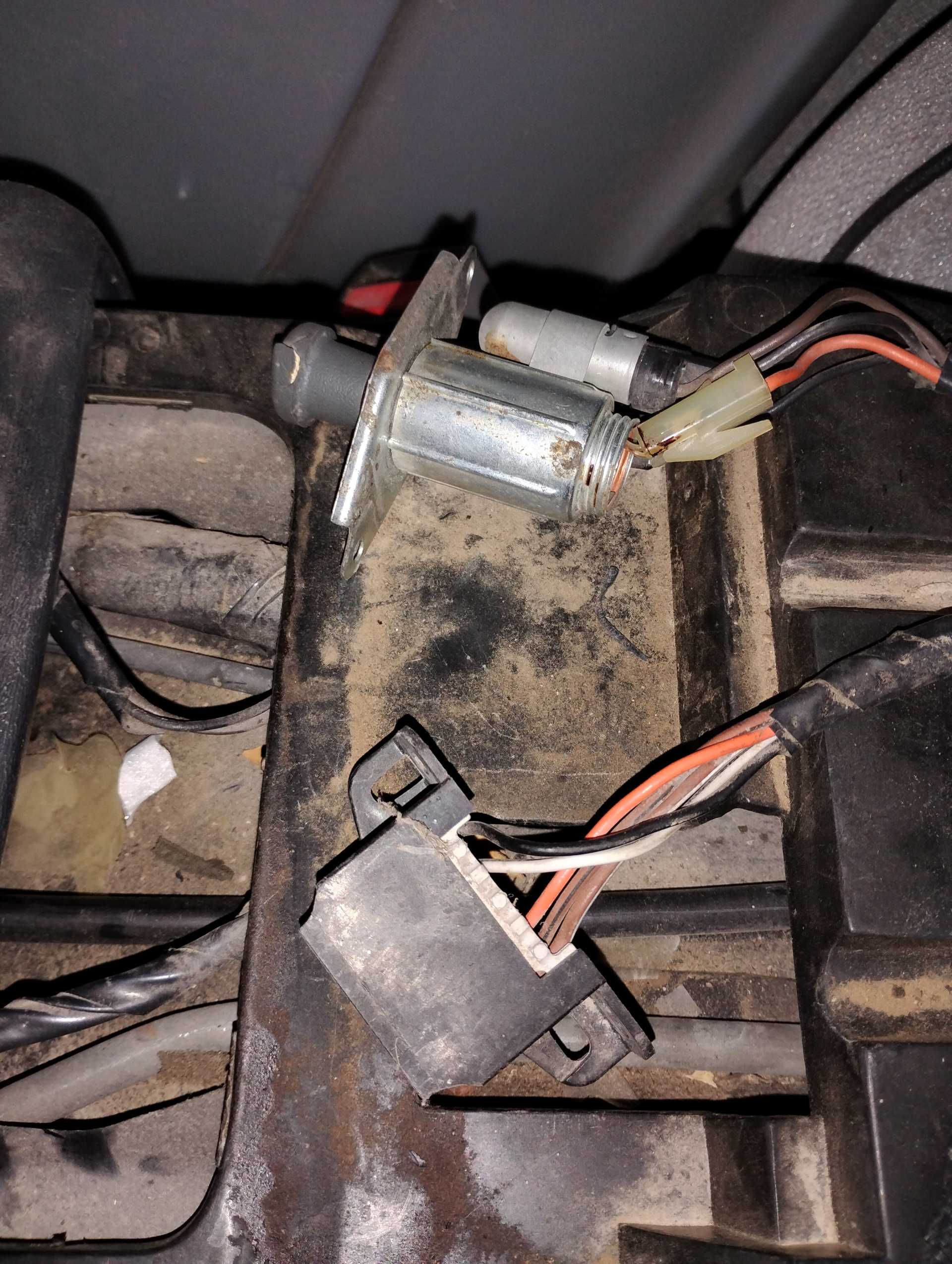

the last 2 photos are in the cab coming from the ECM. I did find the cigarette lighter but have no idea where it connects. I also can't find where the other plugin goes to.

Judging from the pictures your unfinished project has been underwater. The fuse panels are totaled and way too much rust and corrosion on the connectors, cables and metal panels. Just my opinion; Harry

honestly that corrosion is less bad than my gt that sat in Washington weather untouched for 20 years. clean it up with some contact cleaner and a brass wire brush and get a cheap test light. at this point of going through 120 multimeters from them breaking, getting stolen or getting weird from age the test light just goes so much further. my guess looking at everything is that you need to clean everything and trace power for probably about 10 minutes and youll find the real issue also your other plug is the aldl. unless your talking about something i can't see cigarette lighter screws to the arm rest center console bit btw.

That’s not the fuse panel. It’s the primary power connection block. The gooey stuff in the block is the mastic to waterproof the connections. Your fuse block is located under the dash on the driver side. Squeeze the tabs together to pivot the fuse panel down.
If you don’t have any power at all it sounds like you4 fusible link may have opened. I suggest you get a copy of the shop manual and refer to the wiring diagram and chase the wiring. Get a multi-meter if you don’t have one. You can find serviceable ones at Harbour Freight.

Check all the connections at the power distribution block, it's the diamond shaped one below the connector you are holding. The connector by the cigarette lighter is for an ALDL/ OBD1 scanner.
