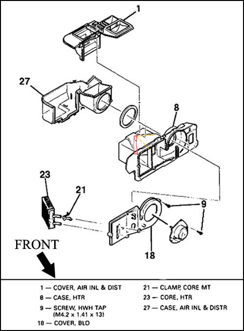

Vent on my non AC Fiero does heat up, it doesn't have as much airflow when on hot as when on cold because of the bleed off to the windshield and floor, but it does definitely send hot air out the vents.
Only picture I could find
It's hard to see, I edited it to show the locations of some things, red is the heater core, solid yellow line is when the lower slider is set to hot, all the fan air goes through the heater core before going to the rest of the ventilation system, the yellow dotted line is it when it's on cold, all the fans air bypasses the heater core and goes to the rest of the system. The vent mode should definitely have heat, and that's how it works on all 80s gm cars I've been in. Vent is just the position, the visible vents that aim at your face, HTR is the floor vents and defrost is the windshield vent.[This message has been edited by 1985 Fiero GT (edited 10-24-2025).]
