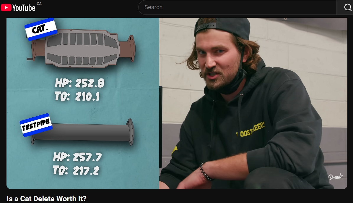

I came across a You Tube video where a car owner was interested in how much horsepower was made by his engine with a catalytic converter in the exhaust as compared to using a straight pipe for an unrestricted the exhaust, The guy did a test before and after and the results show that the catalytic converter makes the engine lose 25 horsepower Dyno test 252HP @ 210.1 fts lbs torque with the CAT 257.7 HP @217.2 ft lbs of Torque with a straight pipe
Dyno Tests w and W/O a Catalytic Converter
Probably a great idea for the track or off road-legal in the USA

Dyno test 252HP @ 210.1 fts lbs torque with the CAT 277.7 HP @217.2 ft lbs of Torque with a straight pipe
Dennis, where are you getting 277.7 HP from?
So, less than a 5 HP increase on a boosted engine that has 252.8 HP with a cat.
Did they actually state the condition of the cat? Maybe it was in less than ideal condition. A fairer test would be with a new cat.
Nevertheless, IMO the gains on a naturally aspirated Fiero 90 HP 2.5 or even a 140 HP 2.8 would be insignificant (with a cat delete compared to retaining a free-flowing newer cat).[This message has been edited by Patrick (edited 10-23-2025).]

I think the biggest thing, especially for older cars like ours, is to swap out those old pellet-style cats with newer honeycomb style catalytic converters. I think you'd agree (and I think I've seen you say this before a few times too), replacing those older cats with newer cats really make a huge difference in these older cars. It's too late now, but I'd love to know what a stock Fiero with the old cat, how it performs compared to a stock Fiero with the newer cat. I don't hesitate for a second to say that a 92hp Iron Duke will see a 5 horsepower increase JUST from replacing the cat with a newer one.
For instances like this guy's video... I looked at the cat, you could see some veins in the ceramic and metal honeycomb were plugged. It was an older cat, and I suspect that even though it was functional, it was probably more restrictive than it could have been... but I also wonder why he wouldn't just go with a larger cat. If larger CFM is the goal, they have larger catalytic converters that do meet those requirements.
I'm not a big proponent of all the emissions stuff, because history shows the vast majority of stuff on our cars are knee-jerk decisions that are wildly and poorly implemented. Smog pumps, charcoal pellet cats, EGR systems, AIR injection, etc. All of these things, when implemented didn't NEED to exist when the EPA could have just mandated the newer style of cats we have now, and eliminated all of those things (it was the usual lobbying from the company that produced the old style that won-out, even though it was less efficient).
I'm on my soap box, but yeah... I think in most cases... unless you're on a track and spending all your time at higher rpms... a higher-flowing cat will get you where you want to be.
I was wondering if the cat used was the one that originally came on this car before the engine was boosted, in which case it was indeed probably undersized for an engine that would now benefit from added exhaust flow. (EDIT- After doing some research on this YouTube channel, it turns out this was the original cat, and the engine was originally naturally aspirated.)
I just didn't want anyone, especially someone new to Fieros, to watch this video and get the false impression that ripping out their cat was going to accomplish much of anything in regards to making more power.
So, less than a 5 HP increase on a boosted engine that has 252.8 HP with a cat. |
Typo Sorry about that. Agree that a much larger CAT should not be much of a restriction
