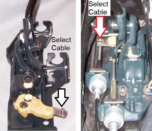

Check l-r shift cable. I had to replace mine ne they get restrictive with age

That's the select cable. Yes, the Getrag's select cable is notorious for eventually becoming difficult to move... as the way the end of it is positioned in the Fiero's engine bay, it's prone to water infiltration and internal corrosion.

Check your select cable; it is the cable that provides the side-to-side motion in the shift assembly PS - Of course, check the other end of the select cable at the gear box...

You're talking about the shifter boot? Don't try to remove it....
Spin the shifter knob off from the shifter Remove the ash trays Remove the four screws under the ash tray Remove the shifter console which includes the boot {I believe the boot was 'glued' at the factory}
