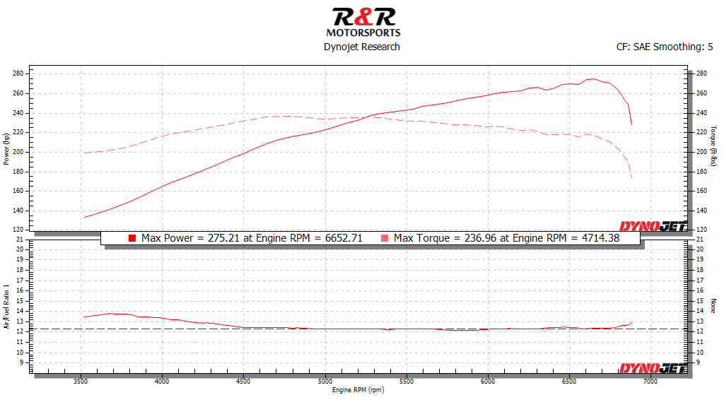

We normally do engine dyno before installing but the time frame for the next race made us skip that step. Sorry for the non fiero chassis dyno, but its an F23 LZ4 setup that could be done in a fiero, minus the exact header configuration Stock 140k mile bottom end with an MS3x computer for full SFI. It has the wot-tech big race cam and VVT delete kit, 75mm TB, ported heads and manifolds, thinner head gaskets for quench, and custom headers.

Good stuff! How much head and intake work was done?

Edit - What would you estimate the drivetrain loss to be, through an F23? I've been attempting to talk myself into proceeding with my LQ1 swap, but with these kinds of numbers, I'm having a hard time not switching to an LZ4 or LZ9.[This message has been edited by Raydar (edited 10-09-2025).]

Facebook does the same to my personal account. I like to keep any details that matter to myself when it comes to port work, but I also want to make it clear that it didn't take a lot of effort on the heads (besides testing on a flowbench a lot). I think there is more to gain, based on the flowbench testing, but now its finding the point where we lose power.
Dan figures 310 at the crank and id hope its over 300. We haven't done an engine dyno to chassis dyno comparison to get the losses figured out yet.
