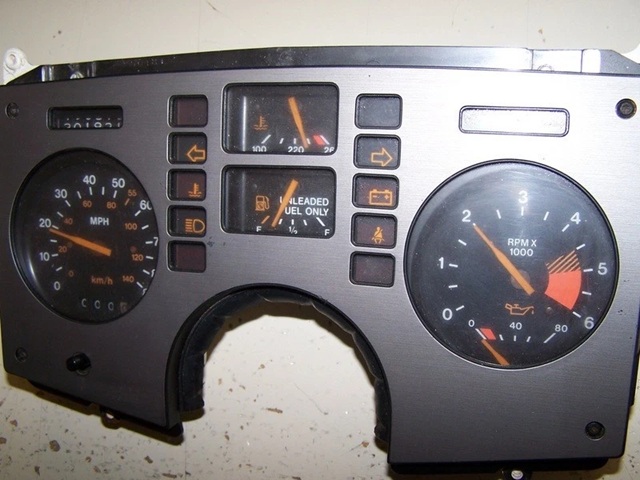

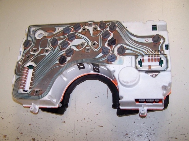

I just purchased a spare set of gauges for my daughter's 85 Fiero. I've already had my gauges professionally repaired and tested by Jack Gunsett, but what I want to replace is the rear plastic tracer (?) that provides connection to all the bulbs.
I bought this on eBay:
I plan to use the flexible tracer wire sheet (or whatever it's called) to replace the one I have, as well as the front gauge panel which fits better... but I'll be keeping the cluster that Jack repaired and tested for me. Quick question though... I really want to upgrade the lights in these. I want the lights to be bright, and dimmable. I want to potentially use LEDs.
I purchased a bulb upgrade kit from Rodney Dickman, but they're still bulbs, and I'm concerned about the heat they generate. I'd much rather use LED bulbs if I can... and I have several that I've purchased. So, a couple of questions:
- Is there a good schematic to tell me what's postive and what's ground, so that I can test each of the bulbs as I replace them? Some LED's are not designed to work when installed in either direction, so I have to be able to test them in the socket before I re-install the gauge cluster.
- I'm assuming everything on the back is 12v? (not the gauges themselves, just the bulbs)

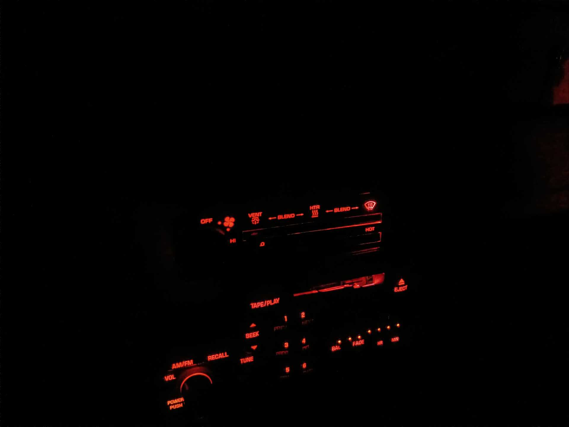

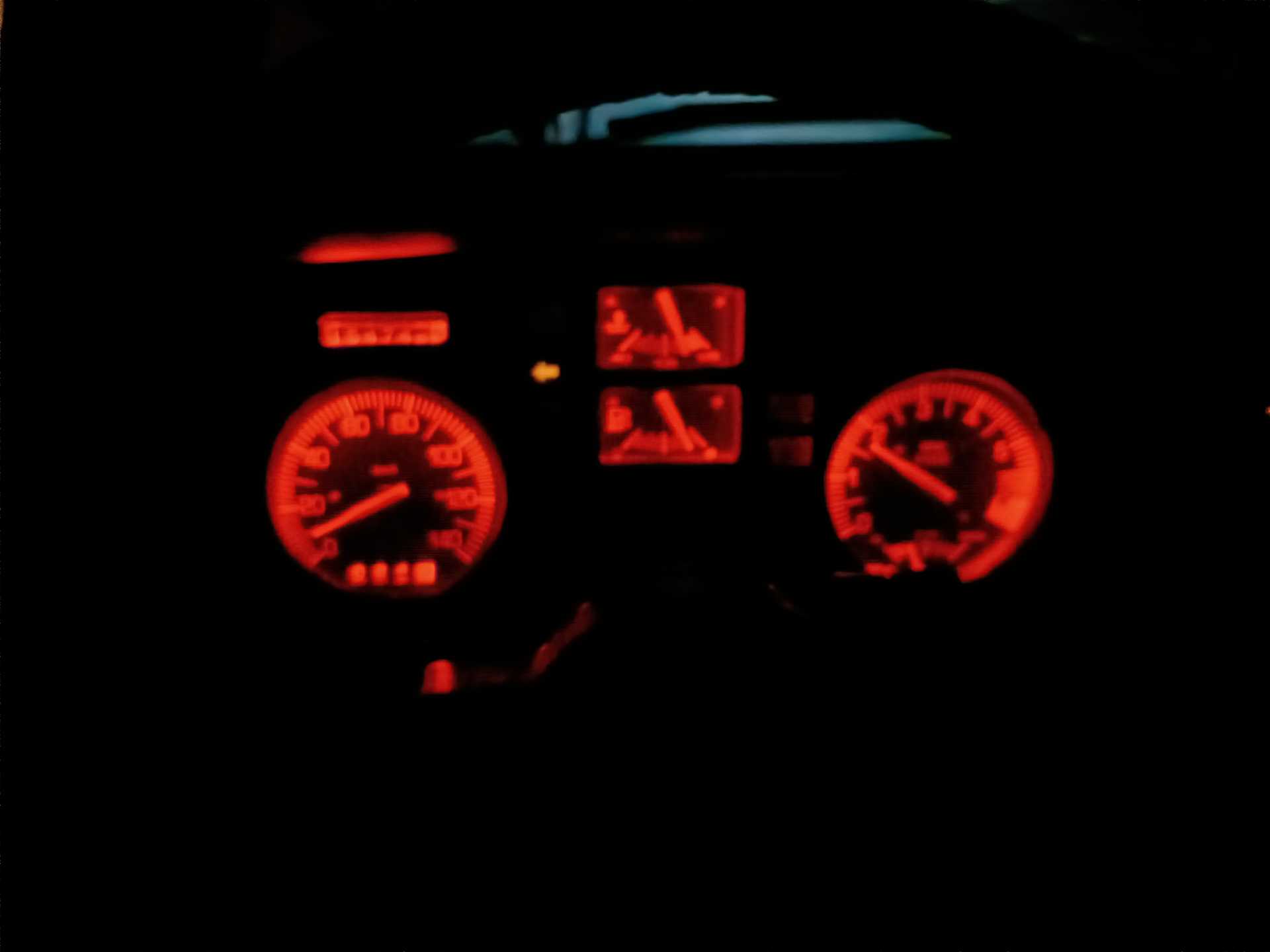

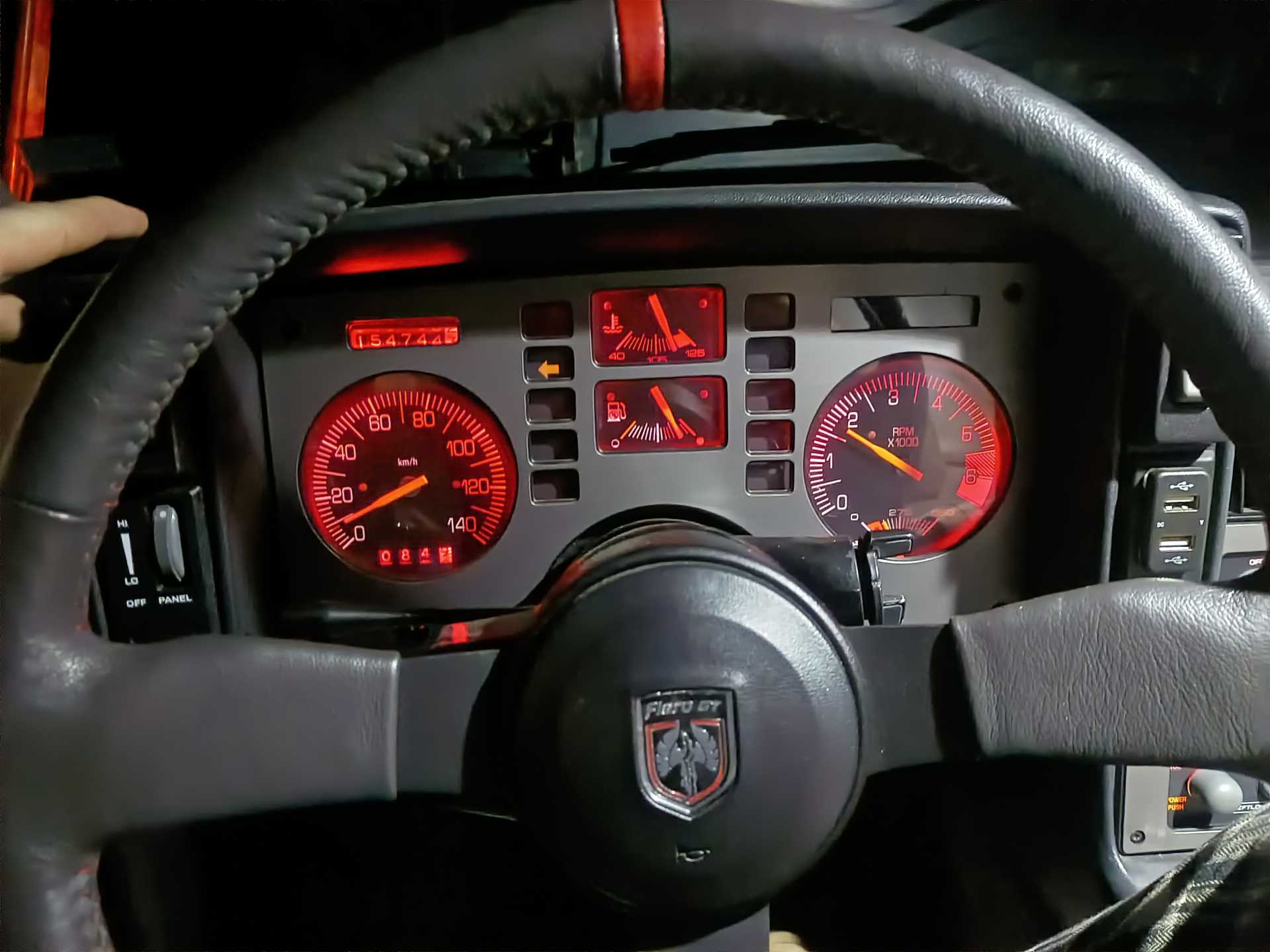

On camera it looks somewhat bad, but that's mostly my phone, it is very red, everything ends up looking red, the orange on the tach, all the white, etc. I can only compare it to my old 2008 Pontiac g5.
Interior lights on:
Interior lights off, bad camera haha
Good interior lights off picture of the climate control lighting (cheap red led), and the stock lighting in a 90s Pontiac radio.
I personally would like something in between original incandescent and red LEDs for the gauges, the extra non tinted light to distinguish oranges and whites, but more red then just the orangish paint on the light reflector. It is definitely completely monochromatic at night, but at the same time, everything is in my interior, with the red led climate control, and I put a red led in the cigarette lighter, when driving, everything is that specific red, there are no other colors, which when it's intentional, I like, but if I still had the factory radio with a different screen color, then I'd prefer the factory bulbs, all matching, or a complete variety, but 90% matching is just annoying.

82-T/A [At Work] you can get the gauge pcb new. This might with your lights.
https://www.deloreangarage....ent-cluster-pcb.html
