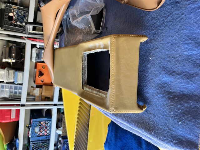

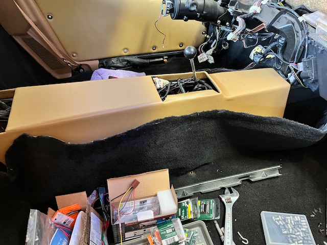

 Hi all: Trying to install the PISA Euro Dash. The kit comes with a 3 part console. 1 part replaces the computer cover. 2 console covers I believe looks like one fits on top of the other however it does not to fit correctly. Should the smaller console on the bottom picture be trimmed flat in the front to lay lower the on top of the larger bottom piece? If you see the picture attached the smaller top cover has a two inch flat front which does not lay flat over the bottom console . Should this have been trimmed flat before I upholstered it? The instructions are very vague. Most pictures I have seen online look like the carpet fits over the bottom cover and under the top cover. (Hard to tell)  This is also an issue as the top smaller cover piece is not wide enough to get the carpet under it without severely prying it wider. I am afraid to crack it. Am I supposed to use only one or the other and not both? Thank you for your help!

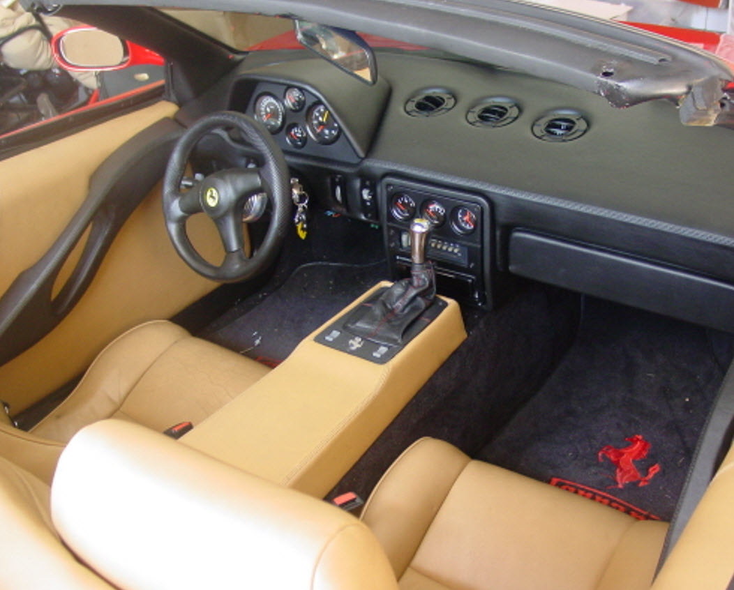

This was the only pic I could find and I had to zoom in but it looks like the parts simply sit on top of one another. This person did the lower section in black and the upper section in tan. Don't ask me how you are supposed to use your stereo.

Make sure the carpet near the console has no pad under it for the last few inches near the console. This will keep the carpet pretty thin at that location.
