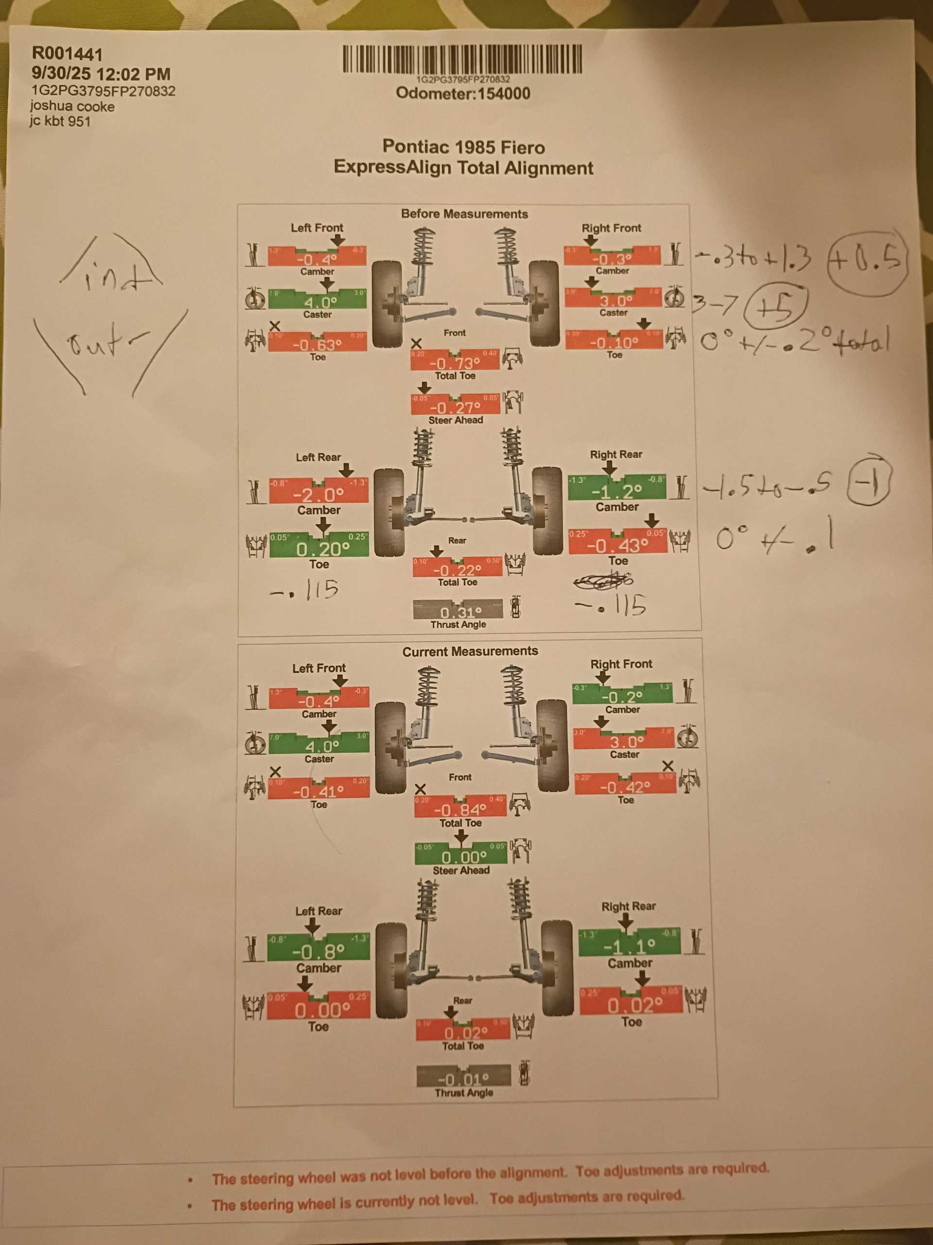

I gave it a partial alignment over my lunch break (I know how to use the machine, but that's not my actual job), I've read that for poly you want 0 toe, so I did that on the rear (only had time to do the rear).

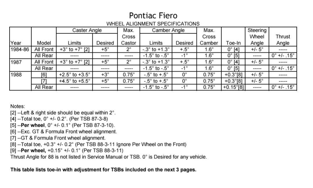

Here is the updated alignment specs from gm via TSB.
I did not touch the front, the readings changed because the thrust angle (rear toe) was changed, I wrote in the updated specs on the side of my paper, you can see both rear wheels were toed to the right, although there was enough of a total different to effectively give each rear wheel -0.115* of toe. Changing from that to 0* gave me a much worse ride, very twitchy on the highway, felt like it was getting blown around, etc. I can't even imagine going to the original specs of +0.15*, which interestingly enough, is what the machine specified, clearly Hunter hasn't updated the specs to reflect the TSBs. So when I next realign, I'll do -0.1*for each rear wheel, and try 0 on the front, I know poly is stiffer, but the rear still has decent play just by kicking the tire when it's jacked up, and I'm sure the engine just driving is putting more forward (toe in) pressure on those bushings than my foot, so it would make sense to have toe out so that while driving it is neutral. Let me know what you all think of that, and what you're all using for your alignment specs.

That's the thing, I had essentially 0.115 degrees toe out on each rear wheel, along with everything else wrong in the "before" on the sheet, and went 235km/h and it was dead straight, completely controlled and almost relaxing, I change it to 0 toe and it's much much less controlled and much more twitchy. I assume toe out (-degrees) is the front of the rear wheels pointing out, toe in (+degrees) is the front of the wheels pointing inwards right? My dad's Fiero had original bushings, and was aligned to original specs (+.15 toe in) a couple years ago and has been somewhat scary at 110km/h on the highways.

Try getting the camber the same on both sides first. Then adjust the toe. It seems that you had more camber on the left before, which was compensating the general toe towards the left. In the "after" setting, your camber is less apparant so the outside of the tyre is gripping more and wanting to pull the car (even with less toe). And do remember to load the drivers side with your eqivalent weight (cements sacs, water bottles, etc...). This will compress the supension a little on your side; you must make the ajustments as if the car was loaded. Being a lowered car the suspension mouvement is towards the edge of it's normal mouvements and starts to go into the zone where the geometry can change toe much more in dynamic use.
Yes, from what it looked like as I was adjusting the camber, both rear wheels were originally the same toe (whatever that was), then the camber slipped a bit and changed the left toe to what it was in the before results (steering wheel was straight last time I got it aligned, it had drifted off center since then, after fixing the rear it is centered again), lowering it slightly increased the measured camber and rear toe for both rear wheels in the before results, but either way, the total toe in the rear was -0.22 degrees, and it was perfectly stable, now it's 0.02* (close to perfect according to Pontiacs TSBs) and unstable. The rear specifically is not lowered far, maybe 1/2 inch, I also only weigh 140lbs, so next time I'm in I'll put some weight in but it shouldn't matter to much.
