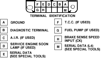

4. I ran a jumper wire between the cigar lighter and the ALDL connecter. I can hear it click underneath me, but it doesn't hum or anything.

Try putting fused +12V at the ALDL 'G' connection which will run the fuel pump without the relay...

I did do that with the cigarette lighter. I just used some wire I had lying around. I can try the fused connection too. Thank you!
