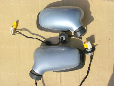

Ok, here's an off the wall question for you guys.... anyone tried installing Solstice/Sky side view mirrors on a Fiero? Trying to mimic the flag style mirrors of the Fiero '89 prototype (similar to the 288 GTO mirrors)?

Not my auction, but if you look at this one, you can see there's three studs on it: https://www.ebay.com/itm/393207155184
The stock Fiero side mirrors have 2 studs on them, which are spaced further apart.
You could certainly re-used the forward-most mounting hole that's already in the door, but then you'd need to drill two new holes, which would likely be in the EnduraFlex door panel itself. You'd probably want to replace those studs with slightly longer ones too, as it may not give you the depth you need to go through the door and then the frame behind it.
Definitely do-able, but I also think the mounting point is shorter, so you'd end up with an exposed area that you'd need to fill in on the door's outer panel. I also think it's a different angle / surface angle... meaning that it wouldn't sit flush on the panel either... something to think about.

The Solstice side mirrors are actually from the Fiat Barchetta:
