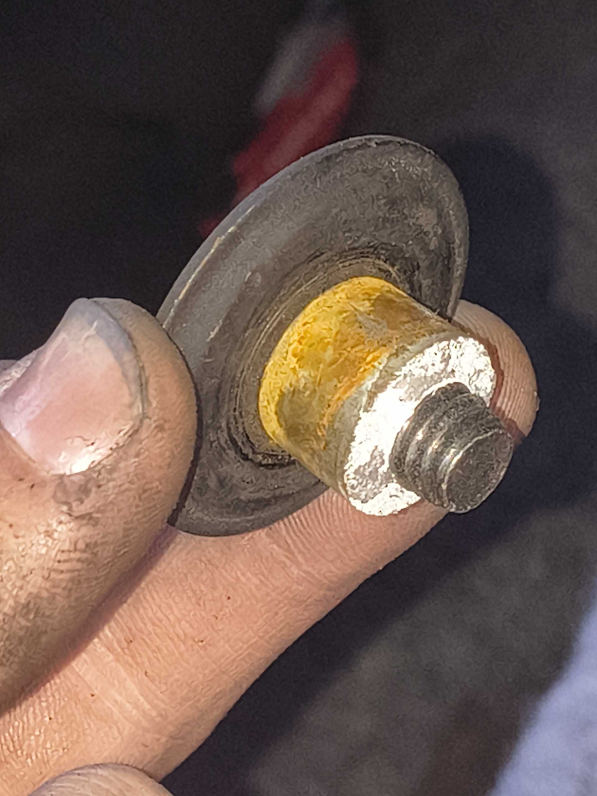

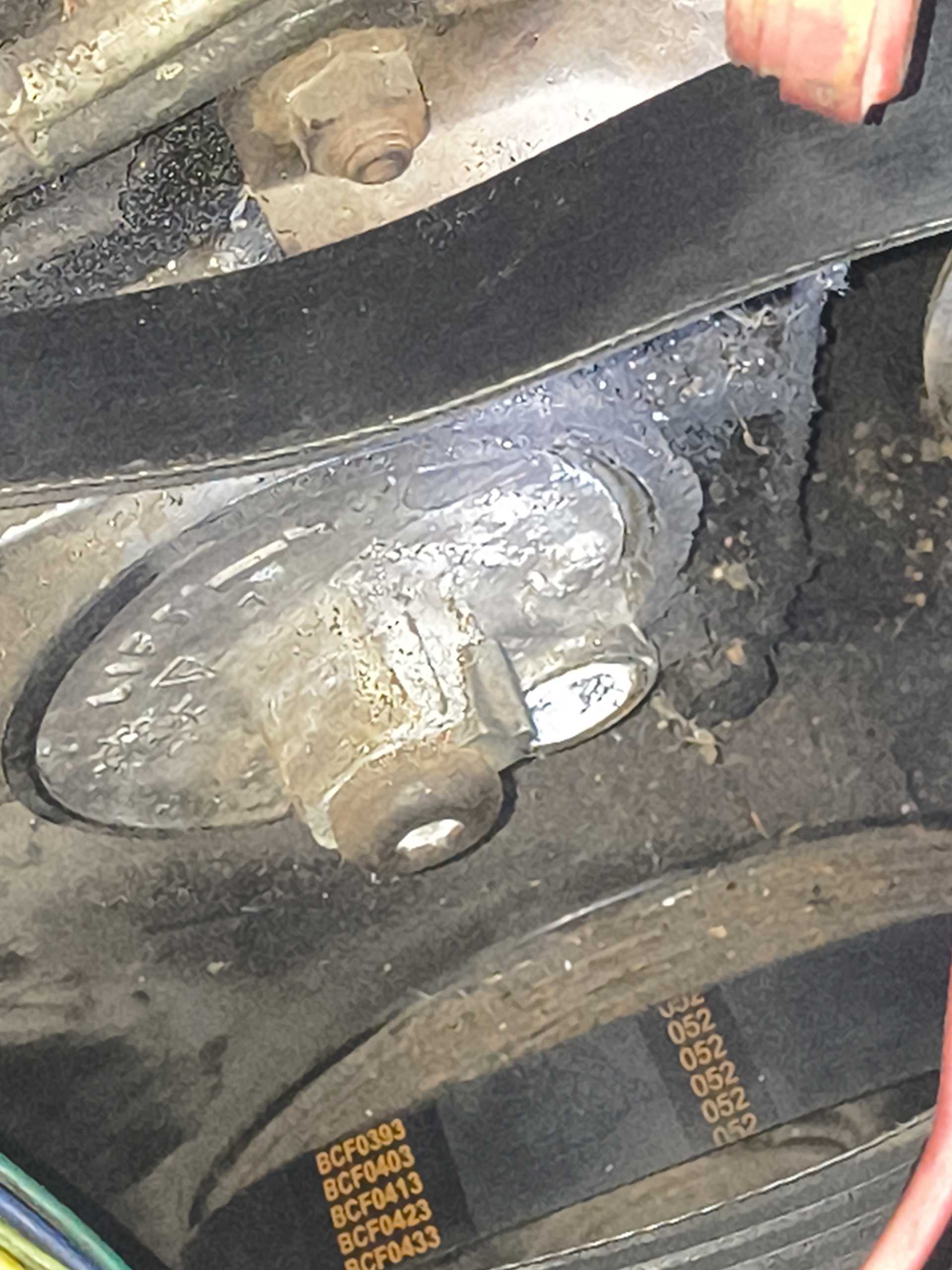

Hey guys,
Picked up an 88 fiero Iron Duke last weekend. It doesn't run and the guy had the engine out so I had to put it back together. I was trying to put on the serpentine belt and I snapped the belt tensioner at the threads....I know Rodney Dickman sells a replacement but it's pretty pricey. I've been asking around Facebook marketplace and some other fiero groups. Does anyone know of anywhere I can get a new belt tensioner assembly? Or a different part number that will work? I feel so dumb for snapping mine 😂 if not I guess I'll have to bite the bullet and get Rodney's. Glad he still makes them!

Don't feel dumb. It looks like the metal was cracked, and had already started to oxidize. If it hadn't broken for you, it would have broken fairly quickly, anyway. I ended up buying Rodney's tensioner a few years ago, because the bearing in mine was shot. The pulley wore a groove in my timing cover. Even then, there were no "regular" ones available. Best get Rodney's quickly. He's retiring, and not restocking when he runs out of most things.[This message has been edited by Raydar (edited 09-16-2025).]
