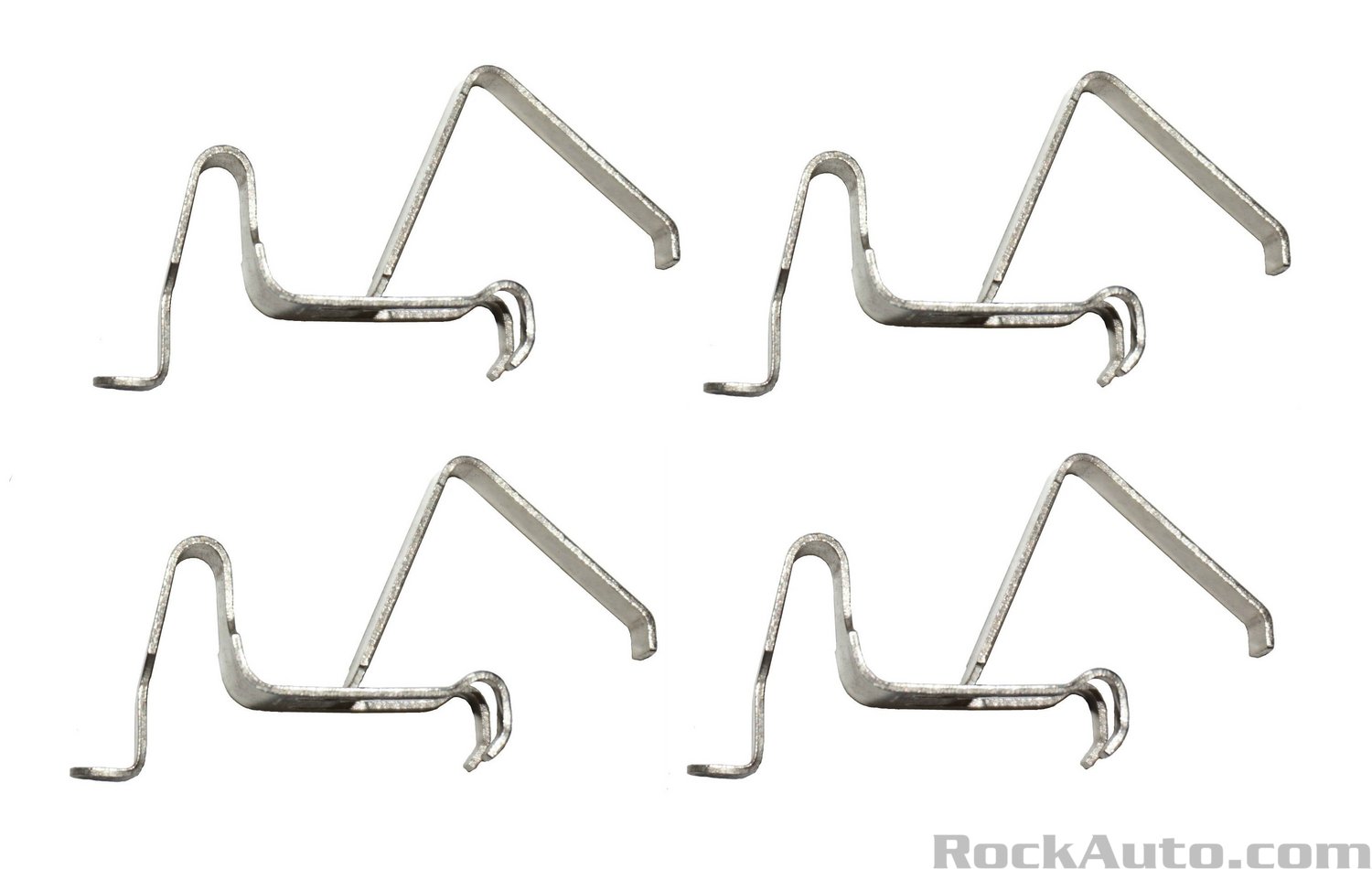

Hey all, haven't been around in a while. I just got the 3800 SC2 swap 86GT back on the road. It had been sitting for quite a while, and I went through the brakes to make sure the hardware was moving right, and replaced all the pads... and afterwards I have some nice new noisy brakes. I had done the Fierostore Grand Am / Beretta brake upgrade on all four corners years ago, and I don't remember there ever being any anti-rattle springs for those brakes. But I did find one listed at Rockauto, so I ordered up a couple sets. But I can't see where the heck those are supposed to fit...
Anyone familiar with those brakes running any kind of anti-rattle hardware ?

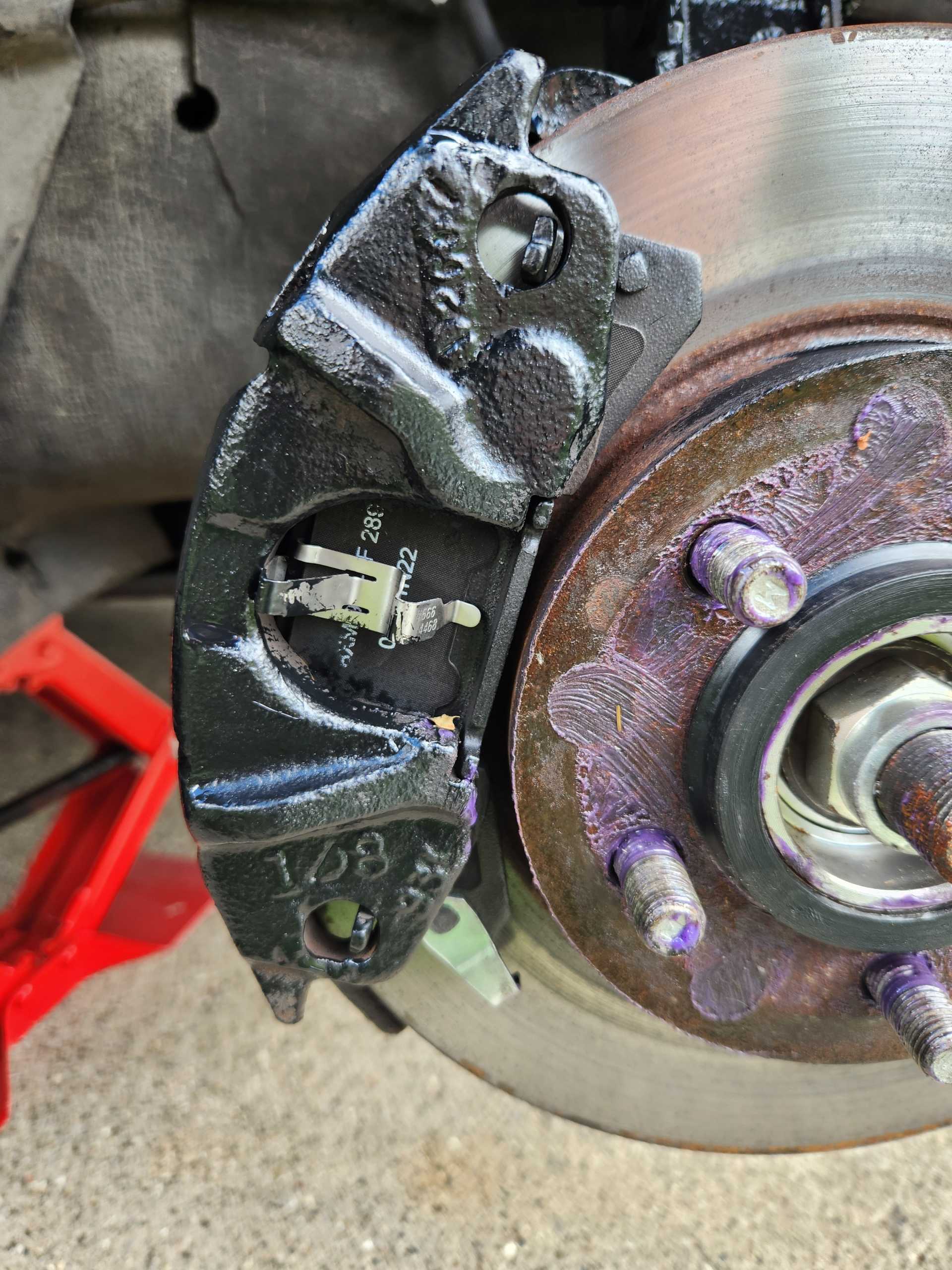

I figured it out. These BETTER BRAKE PARTS 5416K clips from Rockauto looked familiar, like that might have been a piece that came in the Fierostore kit... that I didn't see how to fit right away, so I tossed them and just sent it. Anyway these do in fact fit the outboard pad on the Grand Am / Beretta setup. I'm not sure why they'd come 4 to a package if they're only supposed to be for the fronts... maybe they also fit the rears. Since the Fiero is all 4 fronts, I had ordered 2 packages. Guess I have spares.
