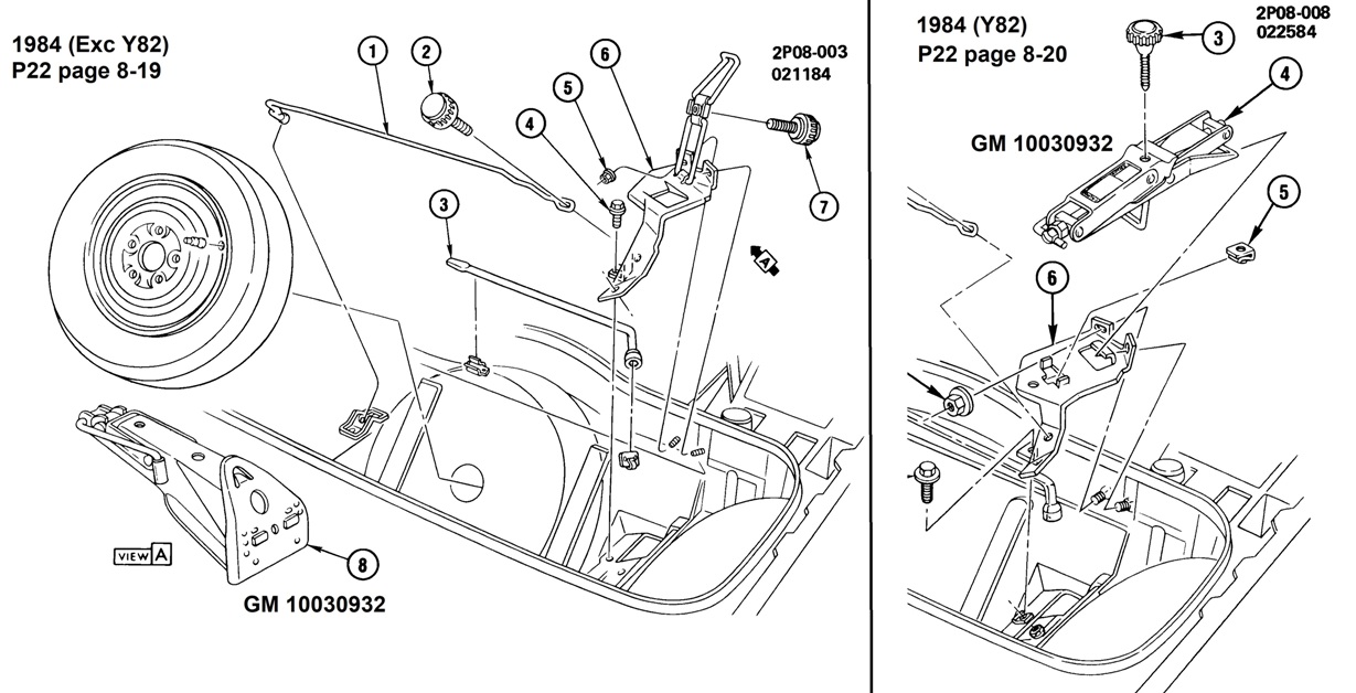

Yes, GM 10030932 scissor jack is unique to the Fiero
GM Interchangeable P/Ns 10021488 10023294 14076683 14076684 14076687 14076688 14076690
But a jack is a jack; other jacks will raise the car, but they won't fit in the jack stow bracket in the front hood.

It's worthwhile mentioning that '84 jacks (and I believe also their storage mount) is different than the later years.

As mentioned, the 1st jack / stow bracket design is different than the 2nd design....
GM 10030932 scissor jack is the later model...
Unfortunately, the 1984-88 Pontiac 'P' Parts and Illustration Catalog show different jacks with the same GM part number....
Does anyone know the 'real' 1st jack design GM part number? ------------------ Original Owner of a Silver '88 GT Under 'Production Refurbishment' @ 136k Miles

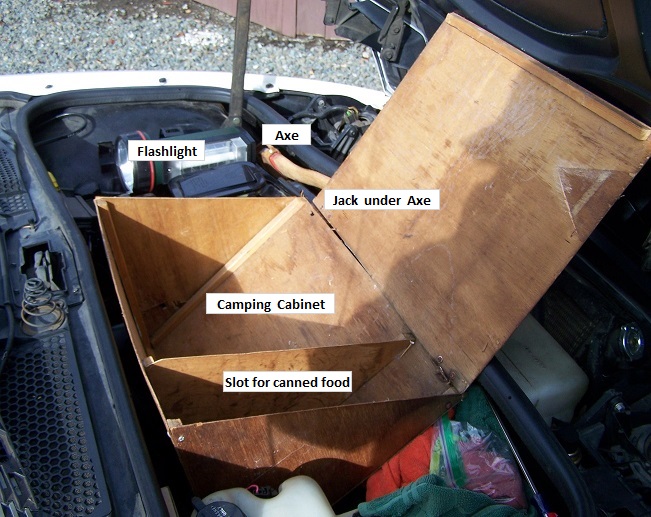

I used my Fiero for camping- a lot- from 1985 to 1997.....I made a camping cabinet that fit on top of the spare tire...But had to move the jack because it sticks right out into the middle of the front trunk...I would wrap a towel around it, then place it in front of the master cylinder.
One of those other jacks- even though it won't attach to the Fiero bracket- may be able to sit in that position in front of the MC....
Here is a pic of the situation;
