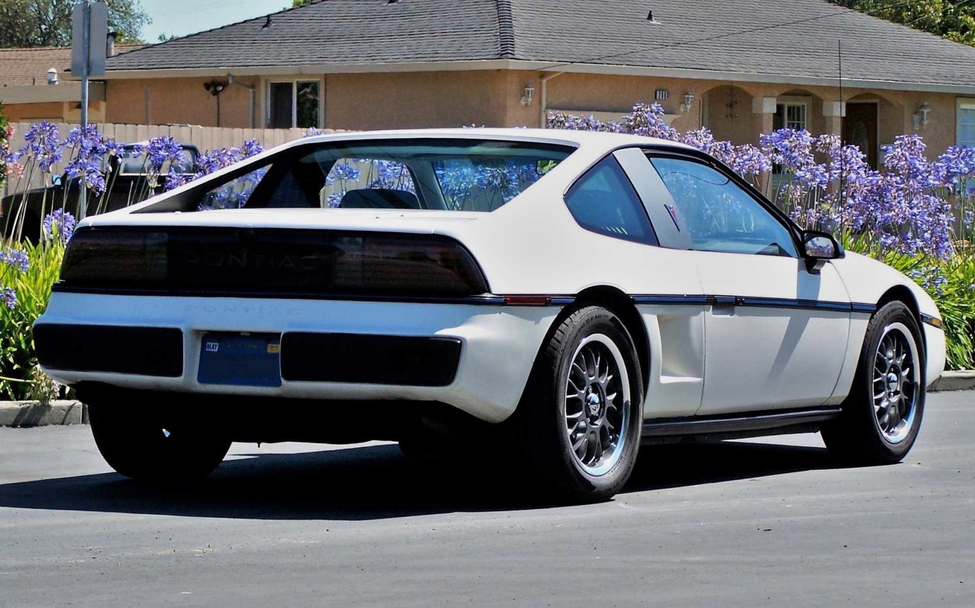

On my V-8 Formula, I run 215/50/17 front and 235/50/17 rear with very lightweight wheels, 7" wide, 40 offset. Handling and ride are as good or better than stock and the car is very driveable in the dry and the wet.
The front sits a tad lower since this picture was taken, as I cut one coil off of the front springs.
