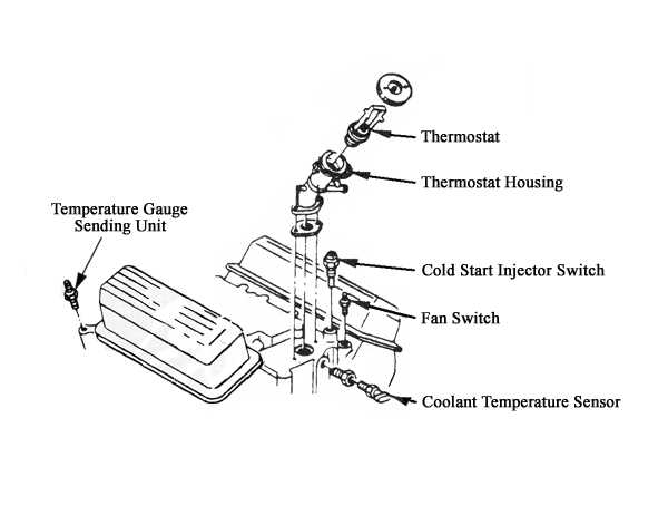

Me thinks you might have things in the wrong location. Is your configuration different than what is shown below?

In any case, in your diagram the CTS is at the bottom…..which is exactly the one I’m working on. The location is correct.
