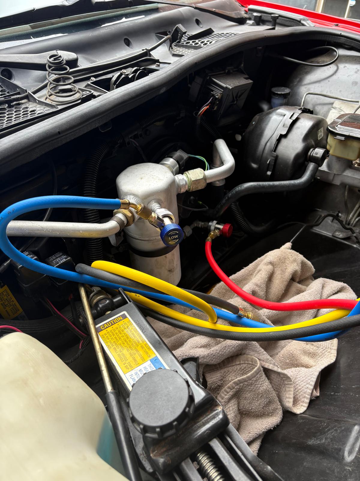

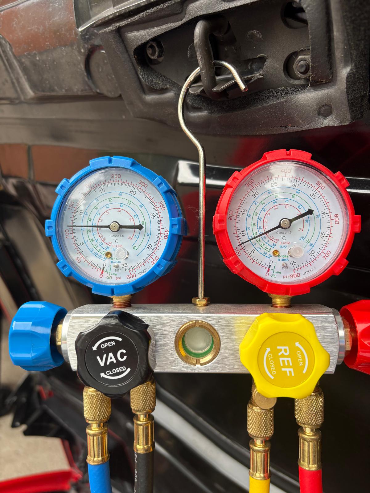

I connected pressure gauge. Turned the engine on , AC on max
low pressure reads as 110 PSI and high pressure reads as 105 PSI??
How is this possible? Air inside the car was blowing cold. Could this mean I have too much refrigerant and the compressor cuts out because pressure is too high, instead of too low?
Also, on the high side, to the right of the port (toward the brake booster) the fitting actually was warm to the touch, not like the rest of the orifice tube area which was cold. So the fitting on the high pressure side was actually warm
 so this is weird[This message has been edited by cam-a-lot (edited 08-17-2025).]

Could it be I have a blockage in the system? I did change the orifice tube. Is it possible to have put in the orifice tube the wrong way (backwards?)

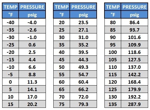

Since we're not sure how much refrigerant is in the system, compare the pressure to a static pressure chart with the system off for a few hours. This will tell us if it's over or undercharged. 110psi on both gauges at an ambient temp of 80F for example would be highly over-charged. Total R-134A capacity in a Fiero should be about 2.25lbs
The same pressure on the high and low side means the system was just turned on and isn't running yet, or the compressor isn't running or bad. Is the clutch at the compressor cycling on and off at all? You can disconnect ad short the terminals on the accumulator mounted cycling switch to force the compressor on, and see what the gauges read then.
It's technically possible to install the orifice tube backwards, but unlikely. Should look like this installed:

Here is the weird part. When I took the photo of the gauges, the car was running AC, was blowing cold. So compressor was running and working
I will check the pressure with the engine cold and off and report back. Thank you
