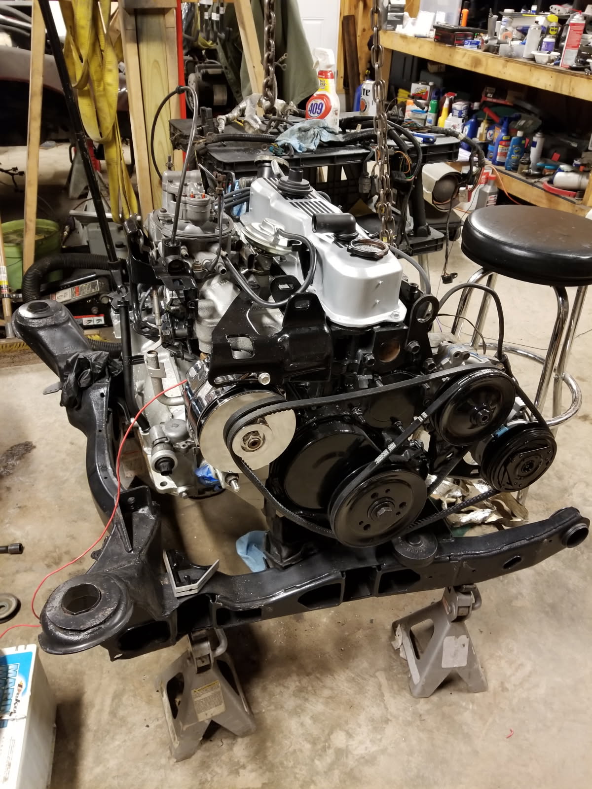

The 1984 had two different set ups for belts.
The set up 82-TA described - a belt for the alternator/waterpump/crank, and another belt just for the A/C compressor. This set-up has a larger diameter pulley on the crank running the alternator/waterpump/crank belt with a smaller diameter pulley running the 4.9" diameter pulley a/c compressor and a single groove pulley on the water pump. I currently have this set up on my 84 base model and will attempt to upload a picture, but will be chaning it to the set up with two belts running the water pump.
The 1984 model year also had a a belt for the alternator/waterpump/crank, and another belt for the A/C compressor / waterpump / crank. On this set up both crank pulleys are the same diameter and the a/c compressor uses a 5.7" diameter pulley and a double groove pulley on the water pump. The 84 Indy that i have has this set up.
I don't know if changes were made during the model year run for these two different set ups. I just know that the engines came out from Pontiac with these two differences.
Let me know what set up you have and I can check and see what belt you need.

Stingray92
AUG 13, 06:32 PM
Just posting this as this is the side view of my motor. I believe the longer one went to the alternator.

Okay yeah, I have the double water pump pulley version.
